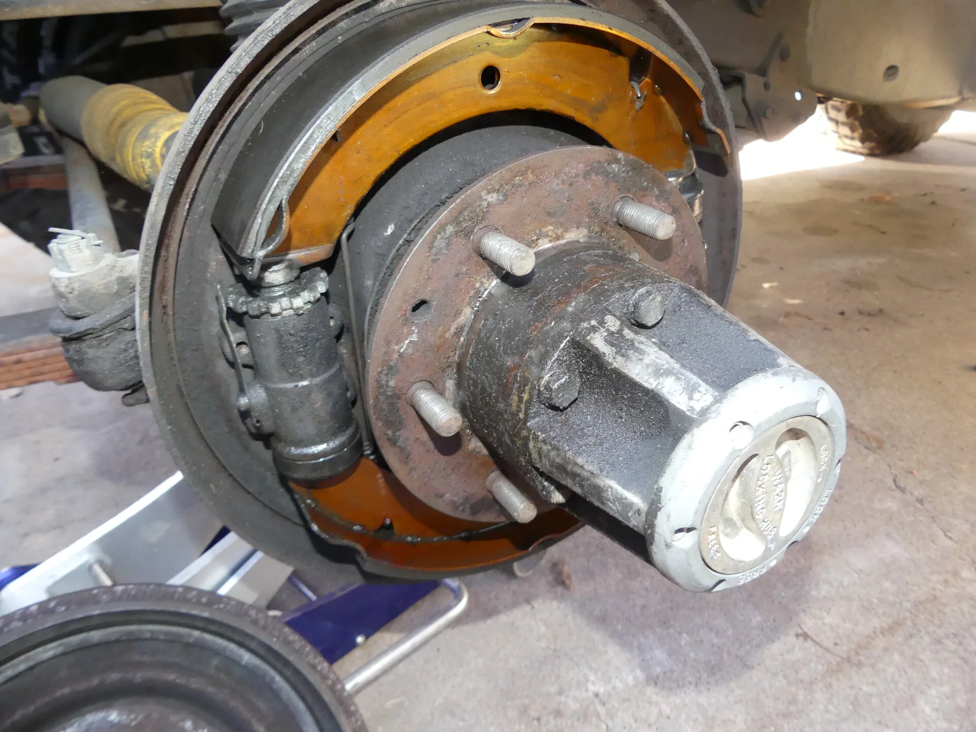

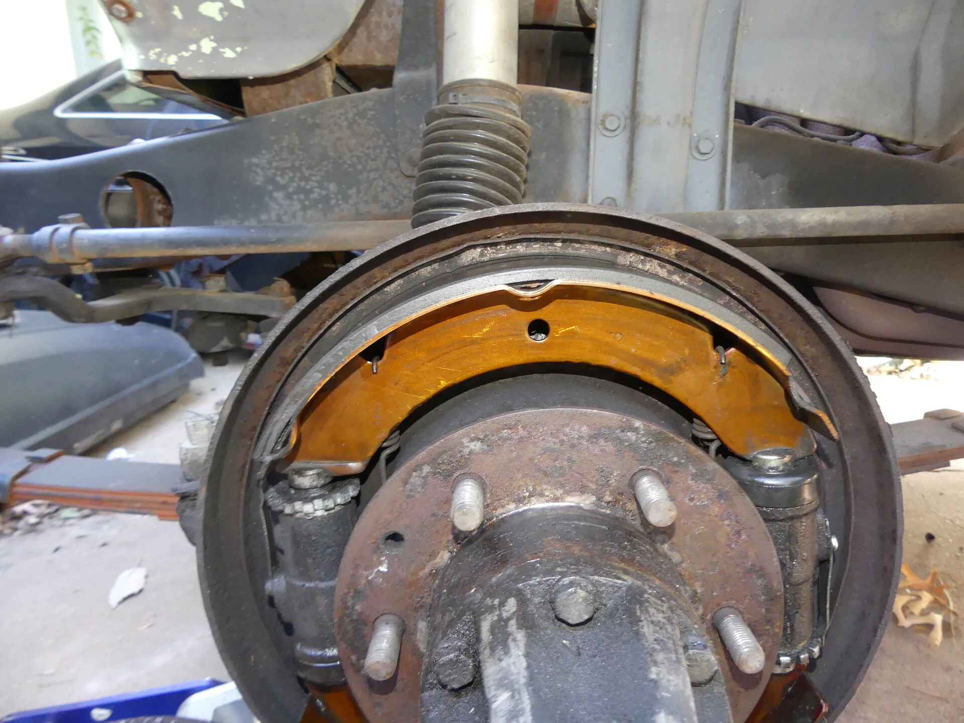

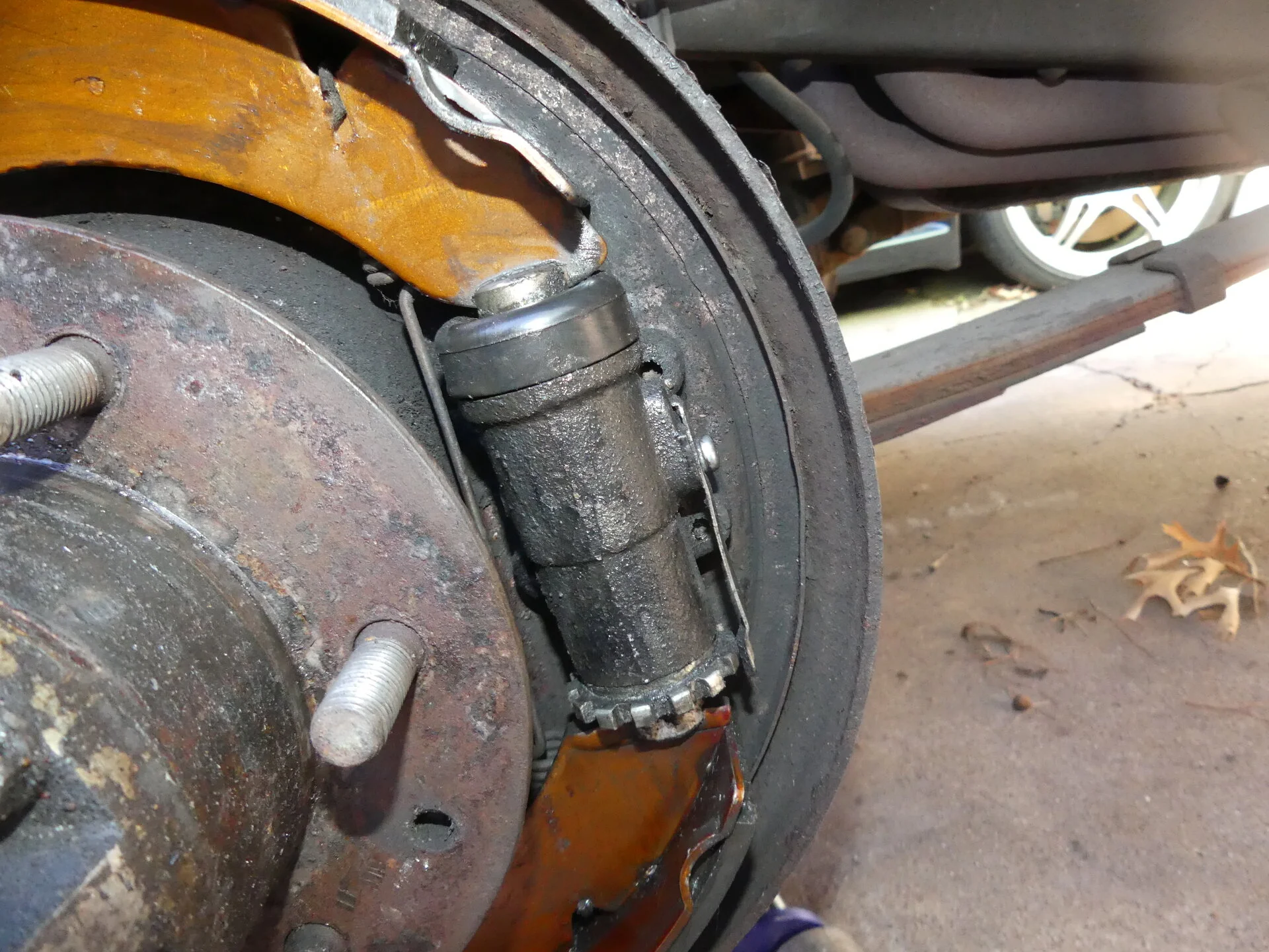

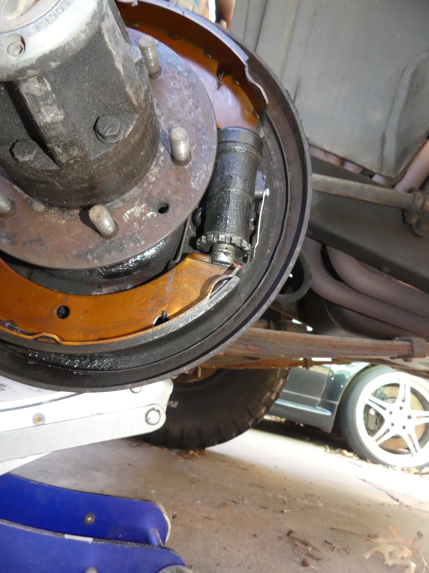

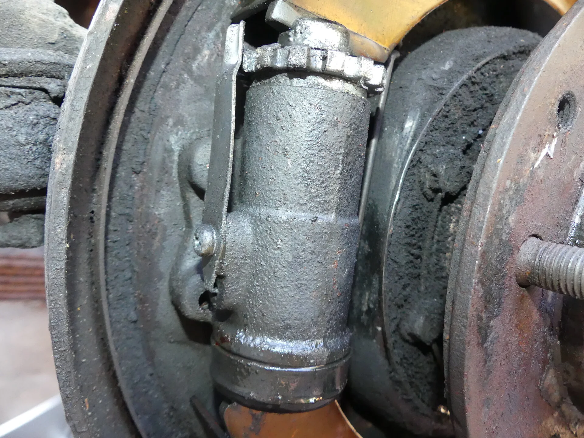

I have a leaking cylinder on my ’71 FJ40. I’ve looked for replacements but not a lot of luck yet. Anyone with some sources would be appreciated. I pulled the wheel off the Cruiser today and it looks like the right side cylinder is leaking ( what do y’all think? ) Is it possible or an option to rebuild the cyclinders or should I just buy new ones? I was thinking of doing a disc swap but that seems like an astronomical pain in the ass. Any thoughts?

You could hone them in place. Really pitted bores and stuck fast bleed nipples should be expected. I would do new shoes if the old ones are saturated with brake juice - so you will be setting them up again.
