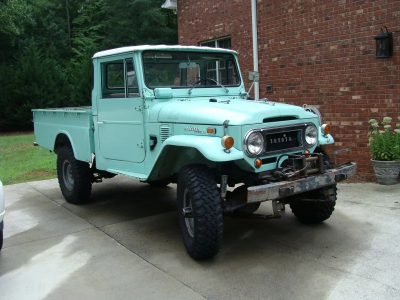

After an exchange of pictures, questions asked and answered, and money exchanged, this is what arrived by truck transport in August 2010 from the west coast. The plan was to make it a shop truck/parts chaser for local travel.

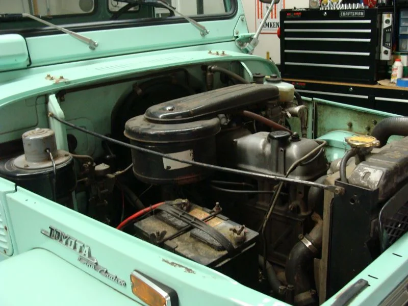

A semi-original LPB with a 2f mated to the original column shift 3 speed, PTO winch, newer windshield frame, disk brake front end, bug catcher windows, and split rims. She rolled off the transport with little to no brakes and a stripped driver's side window regulator. Other than that, she was ready for a cross country trip (well, almost).
I started by bleeding the brakes in an attempt to make it road-worthy. This didn't do much, so I moved to examining the different components. What I found was a little scary (to me), as whoever installed the front disk brake axle did so without replumbing the original single circuit pipes and junctions. They actually folded over the brake pipes and hammered them flat to split the pipes into different circuits. I had not seen that one before.
It appeared to have a mini-truck booster with a non-ABS 80 series master (guessing here). Adjusting the play out of the shoes on the rear drums brought the brakes back into semi-normal working order. A quick drive through the neighborhood indicated that the steering was the next order of business, as it was almost impossible to keep between the lines. 5 turns in on the steering box brought that back to normal.

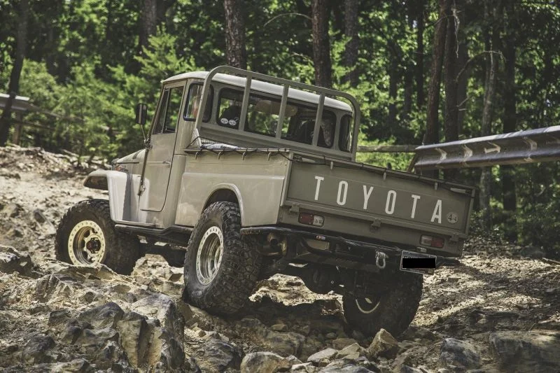

This is Bull's old truck. I've been tweaking on it since summer 2010. While it has less DOM welded on, there have been a number of changes between then and now.
Toyota trails in 2021.
Tubing adds and bed cut teaser.
Probably not hardcore enough for Mike, but I'll do my best.

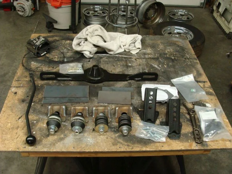

Then a strange set of occurrences happened on the same day. I had a friend call with a need for a complete 2f, and found a local MUD member who wanted to sell an Advance Adapters V8 swap kit, including a Ranger OD for what seemed like a decent price. All parts were new, and had never been installed.

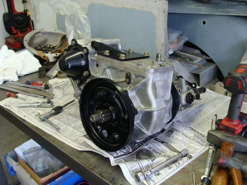

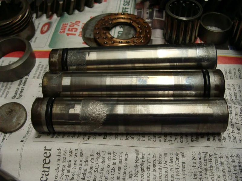

I ran the 78 vintage transfer case but left the older case under the bench. This later turned into a side project where I swapped the low-range gears from the 67 case to the 78 housing. While making this change, I found a possible source for the driveline growl.
The shaft closest to the camera is what came out of the 67 case.
Rebuilt case was treated to a bra and girdle along with fresh bearings and seals.

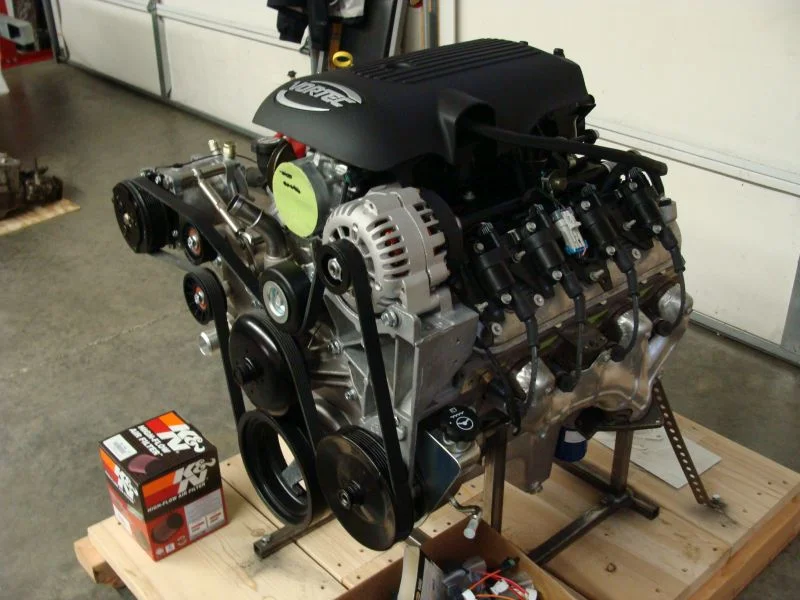

The folks from Advance Adapters were nice enough to trade me straight up and swap out the Gen 1 parts with Vortec replacements, so a concept started to form in my peabrain. Rather than search a for a junkyard engine and have to strip and rebuild a harness, I used a company bonus check to order an aluminum 5.3 from Turn-key Engine Supply. My thought was that the stand-alone harness would make the build easier...

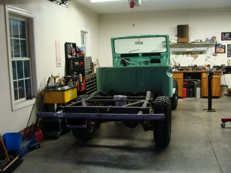

I stripped the truck down to a bare chassis and cab to facilitate the driveline mockup. There was what looked like a piece of Schedule 80 pipe welded onto the rear crossmember, and someone had torched a hole for a spare tire hoist and chain. Someone had also welded a generic receiver hitch to the back of the frame with a lot of plate steel for support.
