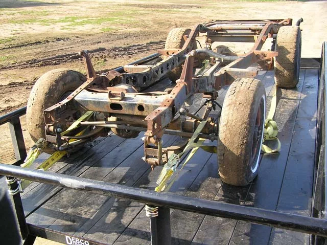

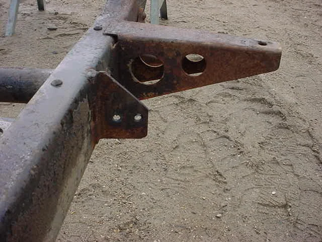

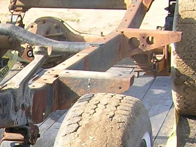

    Question for the LV boys and girls. Pics pretty much say it all. Did the Doobie bros. weld this on or is it factory?

    I doubt it but I'll have to check when I get home. My guess is it was used as an exhaust hanger but not stock.

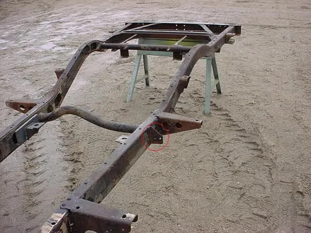

    Found another wagon frame pic. This frame was titled as a '66, possibly a '65 production.

    I just can't tell? :confused: The welds look fairly nice and it looks somewhat factory and yes, the exhaust was bolted to it.
    Althought the exhaust was coming out the side ahead of the rear tire. :)
    Please let me know, if not, it's gotta go.

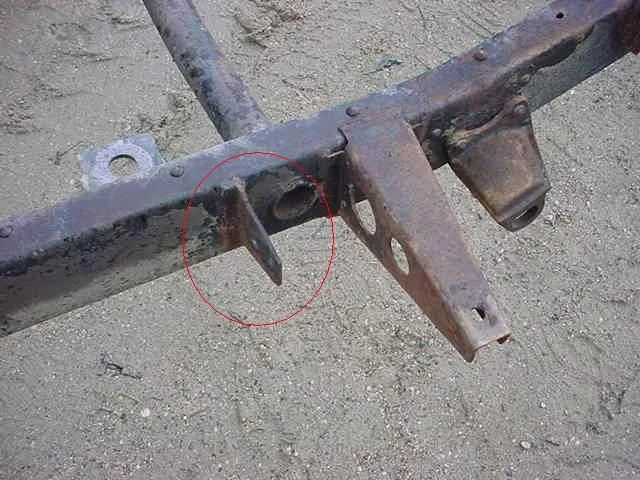

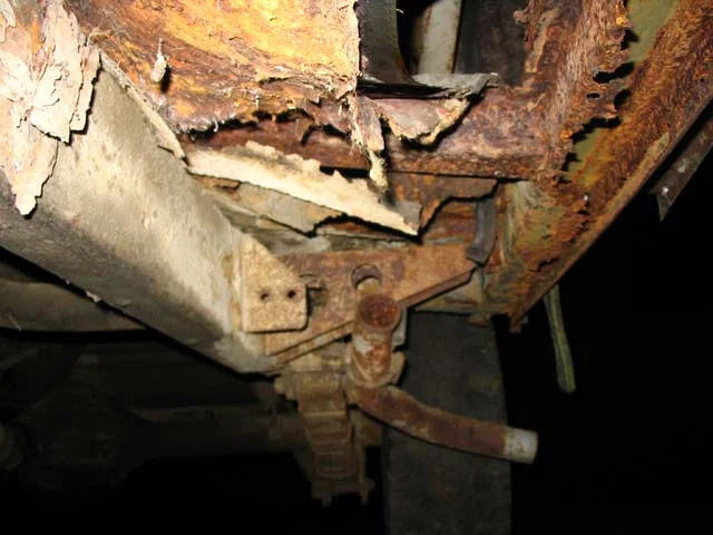

    I was wrong!! :eek:
    Here are some pics for you. The 64, 64, and 65 have it. The other 65 and the 66 does not have it.

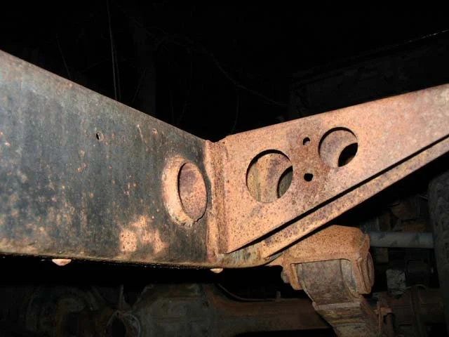

    This is the 65 and 66

    Thanks Mike, got your email also.
    Didn't get a chance last night to cut it off, to busy with those sway bar brackets, must have been fate :)
    That's good then, one less thing I have to do. Frame is done and ready for blasting and powdercoating.
