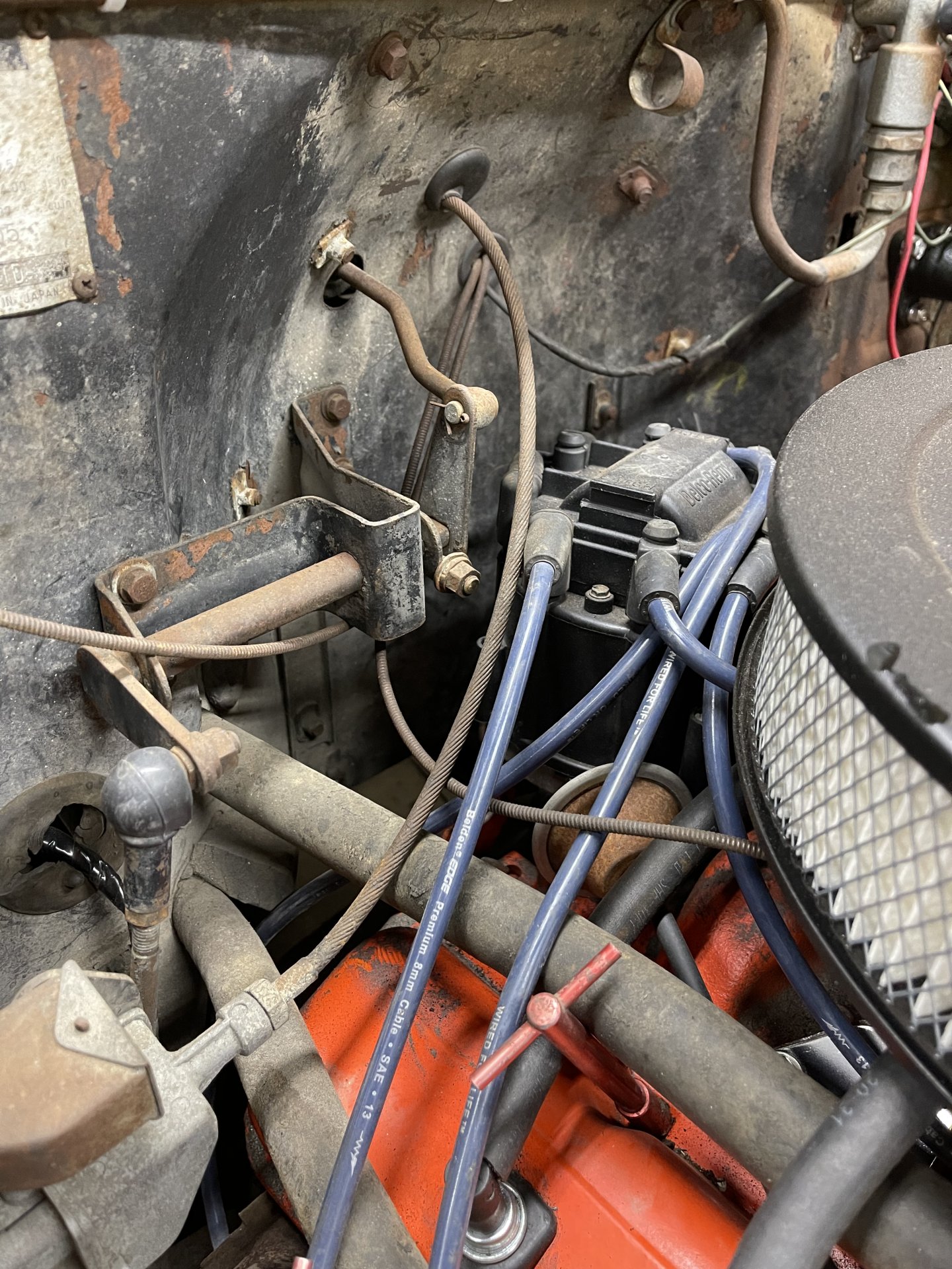

Do the early heaters come with a pull cable operated valves or just manual ones? Mine is removed so I’m trying to figure out how to make is stock or at least close. If anyone has pictures that would be great. I saw an earlier post about a Napa valve that’s close to Toyota, looks like this:
How does it get attached to the firewall? Here are some pics of my setup with a 350 SBC.

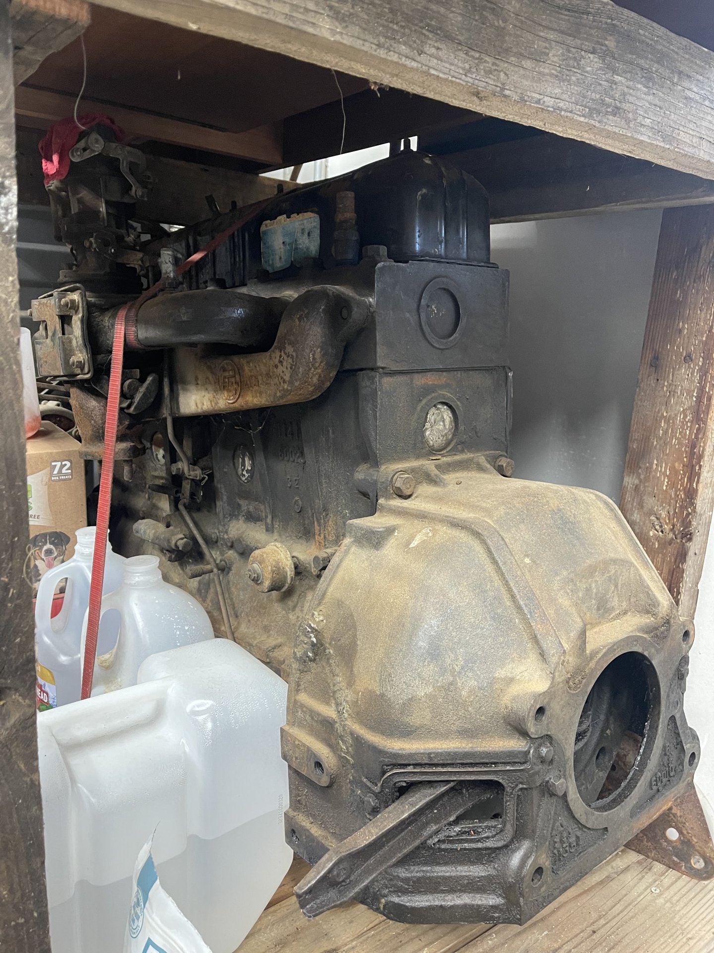

Turning it stock one thing at a time. Found a 65 engine not too long ago. That’s the long term project if I can restore the F engine. But starting with simpler things for now I wanted to restore the heater and put the right valve at the firewall.

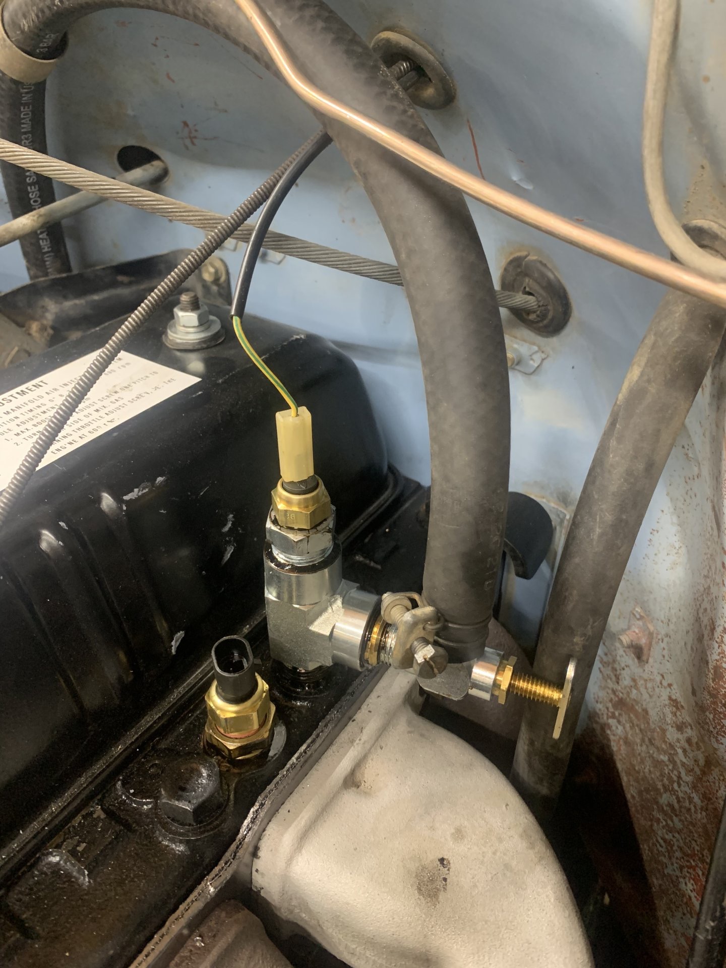

I used that Napa variant you linked on my 1970. Not 100% correct but looks the part and functions fine. You can see it here (though mounted sideways as I needed to get tricky with having the sniper temp sensor as well).

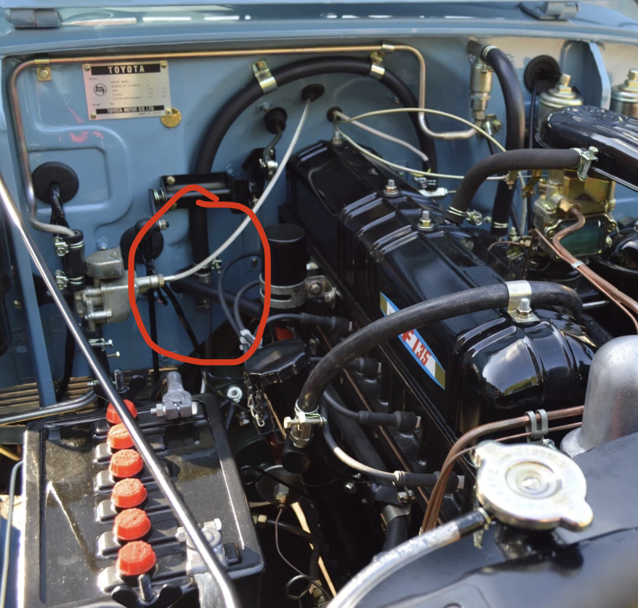

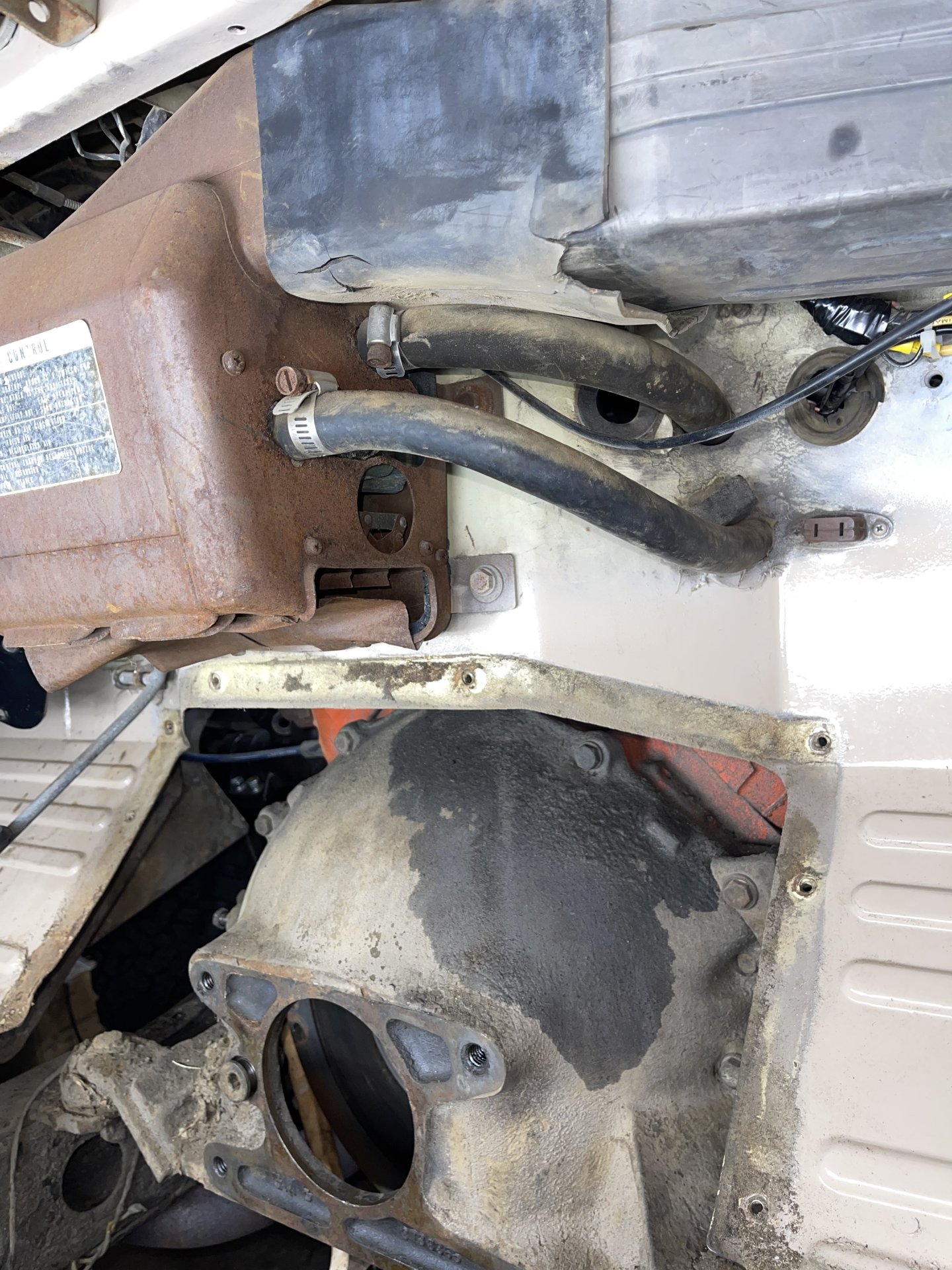

Got it. I think I misunderstood, the Napa valve gets attached to the block ( which I don’t have on the car yet😂) . On my 77 I have the valve similar to the one @ToyotaMatt has, which is attached to the firewall. My question is what’s the original part/mechanism that’s near the firewall. Is it just hoses going in, or a 90 degree elbow? It’s in the area shown below ( not my car)
This is what you seek
Answer to the pull cable question it was 9/73 (74 model) when the cable started. Part of that upgrade was a down grade of the rear heater blower running on
high speed of the front heater blower switch. Perferred rear heater having it's own heater switch.

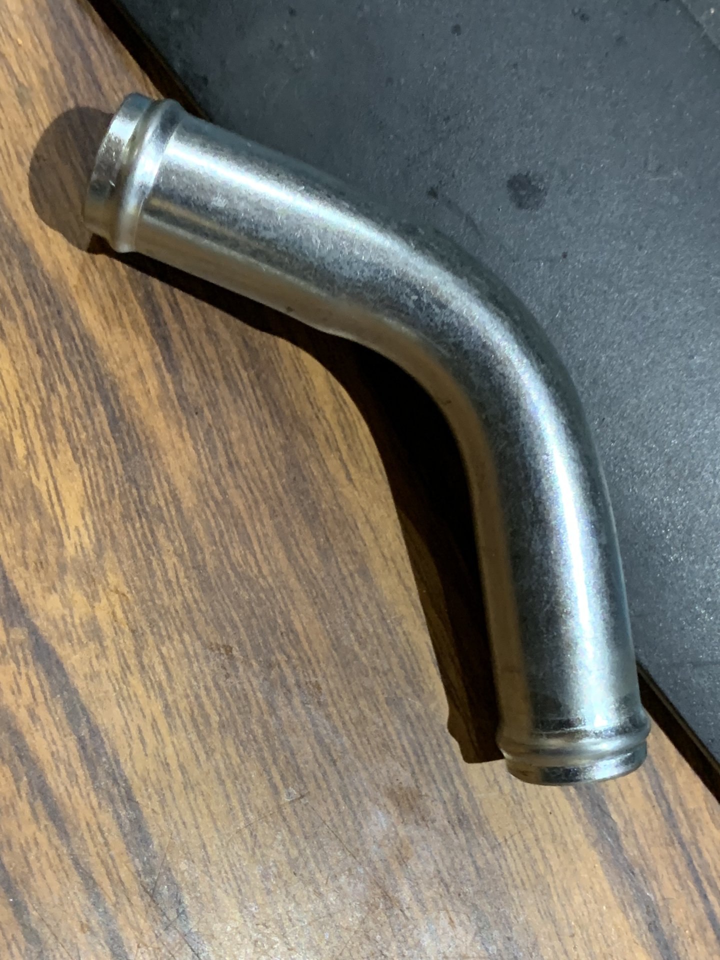

this is what you refer to as far as a grommet ?

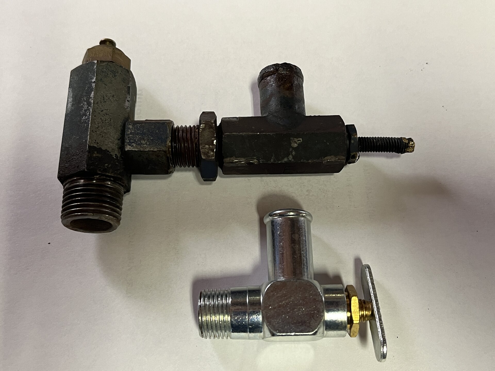

Old Post but can anyone tell me where this shut off valve came from? I have the part that screws into block.
Just received this valve from Amazon. The thread pitch is different. I went to Napa as other have suggested. They will special order BK6601402 but is $44 with a no return.
Can anyone confirm the thread pitch on the Napa part is correct? @cppilot
Thank you
Not sure on the pitch of the one you have.
Matt has this one on his site. He may be able to help with pitch questions.
Is the Amazon one the Four Season 84703 valve? I bought the same one for my ‘77 2F engine, along with this adapter
Anderson Metals 56110-0806 Brass Pipe Fitting, Hex Bushing, 1/2" NPT Female Pipe x 3/8" NPT Male Pipe https://a.co/d/5HaEGkM
It was suggested in another thread by someone else for a 2F engine.
