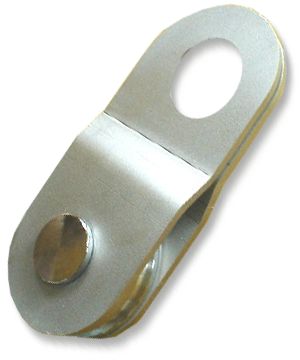

A snatch block is just a heavy duty pulley that lets you double the pulling power of your winch. Here is a photo of one.
Many of the IH8MUD vendors sell them. Here is the snatch block page from OK Off Road. There are several different makers of snatch blocks listed there.
DOUBLES the pulling capacity? so i have a 12000 lb winch for another 2lb object? would it be 3X rated capacity if i used two snatch blocks? how exactly do you rig up a snatch block?
