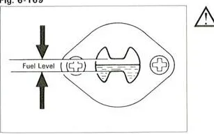

Check the sight glass at the front of the carb ...

Bulb is little lower than half full of gas and it's pumping gas down the carb..

No clutch, no gas pedal. Turn key to engage starter 5-6 times. Get out and check carb sight glass for fuel. Once it’s halfway in the glass THEN start truck. If temps are cold, be sure to use choke.

1984 FJ60 with rebuilt carb about 6 months ago. Was driving down the interstate when I experienced either loss of fuel or loss of spark. Engine turns over, no issues there, but won't start. In the dark, with a flashlight, I do not see fuel in the site glass, but can see fuel in new oem fuel filter. I haven't tried starting fluid to eliminate spark/no spark. Had to leave it stranded while I go for starter fluid.

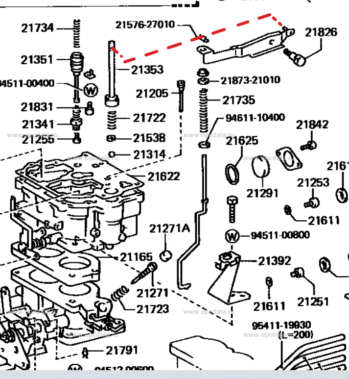

yes, a new pump plunger usually comes in the rebuild kit. If this is a problem that just happened then make usre th elinkage is connected properly. there is a see-saw type linkage where one end is pushed up by the throttle opening and the other end pushes the accelerator plunger down.
It's hard to see fuel level especially in the dark, I think. you can take the cover off the air cleaner and operate the throttle by hand. If you have fuel AND the accelerator pump is working you should see fuel shoot into the primary bore.
