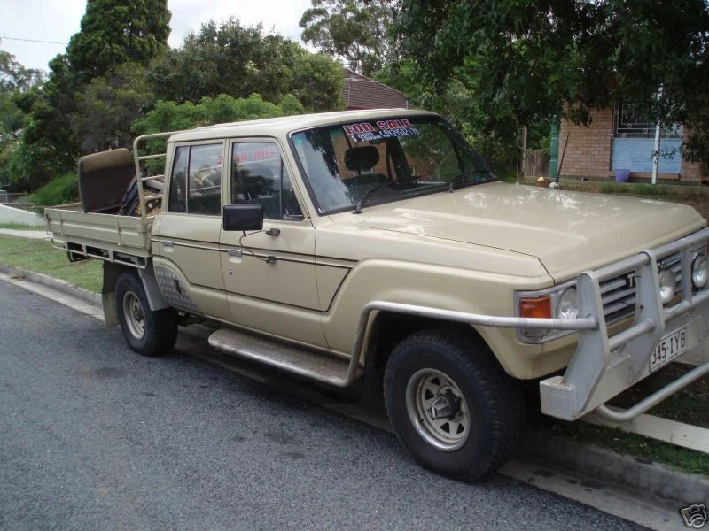

Here is one.
Sorry the photo is so large.
I have some more, but I'd have to find them.
Best color too!
Thats what I'm after, would like to see images of how the cab was closed off if you have um, would also be handy to have tray dimension and how much was added to the chasis. TY.
I'll have to sort through my photos.
The truck is not mine, I asked a guy in OZ to send me the photos, he had the truck listed on ebay.
It could take me a few days, but I get on it.
I'd be of no help with the Dimensions though.
Dave
That Aussie truck also has a very long wheelbase...........if you notice the diamond-plate over the rear wheelwells............
maybe not a 60 frame?

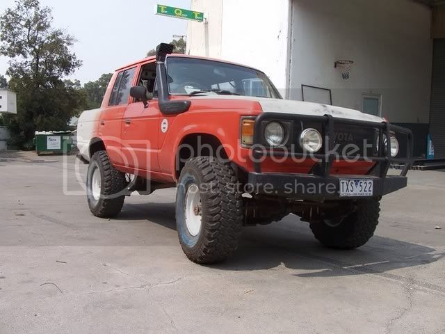

This is my personal favourite 60 dual cab.
The pics were posted by 'Mud Empire' on Outerlimits. I think that he did the conversion for a customer. Looks great!
