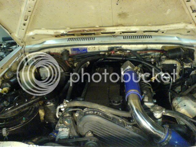

curious to see the pics and the quality of finish.
as you know i have done a couple HZ and PZ installs, she be really tight.

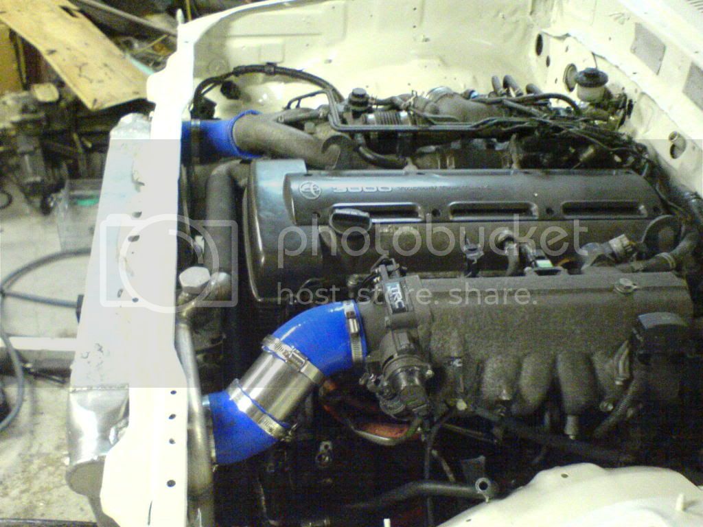

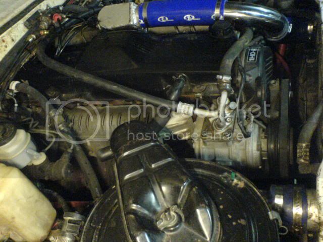

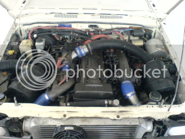

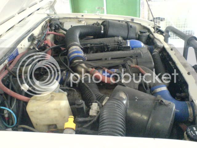

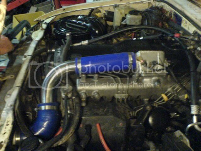

i gotta see these pics of a HZ into the LD LC engine bay, gotta be some quality stuff happen'n
looks like the firewall needed some "massaging" as well.
shows it can be done
also shows a less than clean install.
