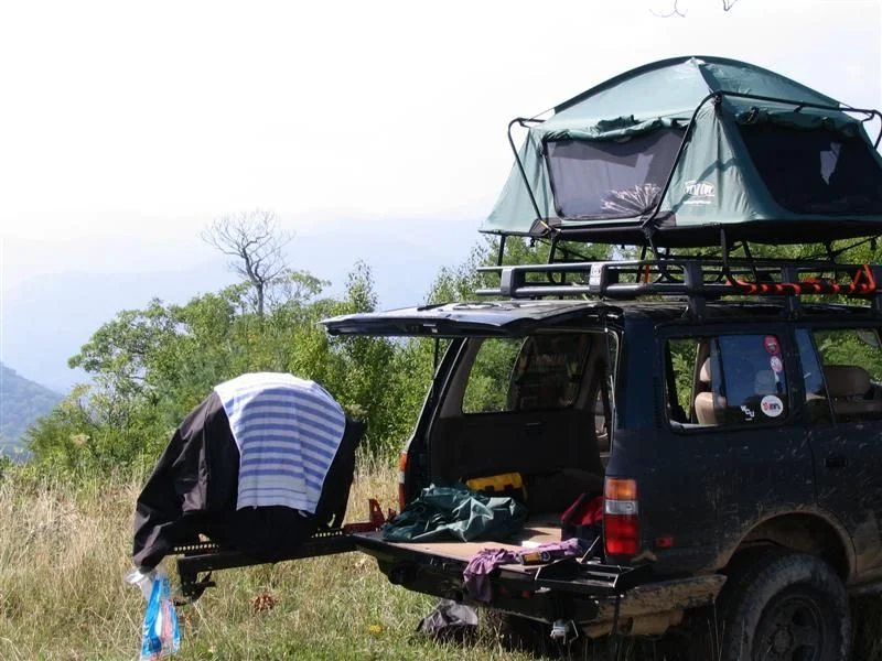

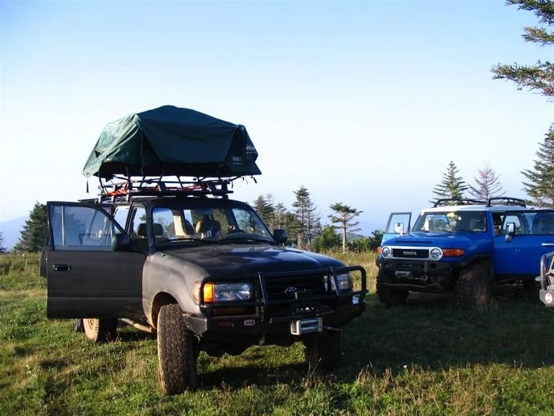

Nice work as always. I could have linked you to some pics and description of my old set-up. I used the tent cot mounted on my ARB rack. Only issue is with the side rails on the rack, so i had to mount it sidways where some of the tent hung off the side. Still worked great. Only downside was that it took me FOREVER to set the darn thing up. After unpacking it, setting it up, putting it on top of the rack, ratcheting it down for stability, i was in over 45 minutes! It was a major PITA.
So, i opted to just sleep in the back of the truck until i could get a real RTT.

Wow, concretejungle, how did you get in and out of that? I'm asking 'cause I'm almost 60 yrs old (no spring chicken:rolleyes:) and even with my ladder that came with my RTT, getting up in the middle of the night, as guys of my age almost have to do several times, is touch and go.
Well, to be honest that's one of the reasons i decided to ditch it. It was just too difficult and i didn't feel like carrying a ladder around. I could basically step up on the rear bumper, step on the spare tire and up onto the roof rack.
