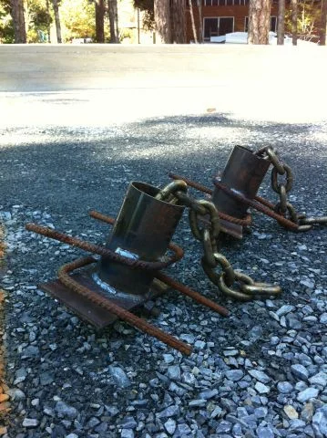

I put these together for the slab, couldn't find anything local so i built them with leftover material. Five in total, should be plenty. I'll cap them so they're flush with the floor after its poured.
lookin good... those anchors will work well

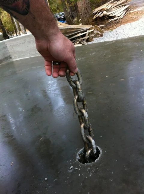

How does the chain attach/remove? or are you going to just tuck it into the pipes?
I'm pouring concrete in the next couple weeks here if all goes well so I was thinking I might copy you...

I'll snap a pic for you when i get a chance. Its just a 1/2" grade 8 bolt through one of the links welded to the base plate on the outside keeping it from pulling through and three other links welded to the bottom plate also for added security i guess...:meh:
The chain is 5/8" or 3/4", pretty big stuff, and the plate is cut in a cross patern to allow the links to go through.
Beats spending $300. for the store bought ones...

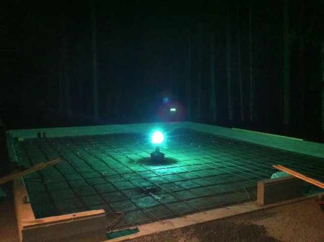

Prep that floor!!! And when you think you're done, do it again! I rented a 400lb. dynapac, brought in and shoveled 4 tandem loads of 3/4 crush. Tamped it in in stages, along with watering to get the fines down. I've also got 80-20ft. sticks of 1/2" rebar with a 6" slab. Lets see some pics of your shop.

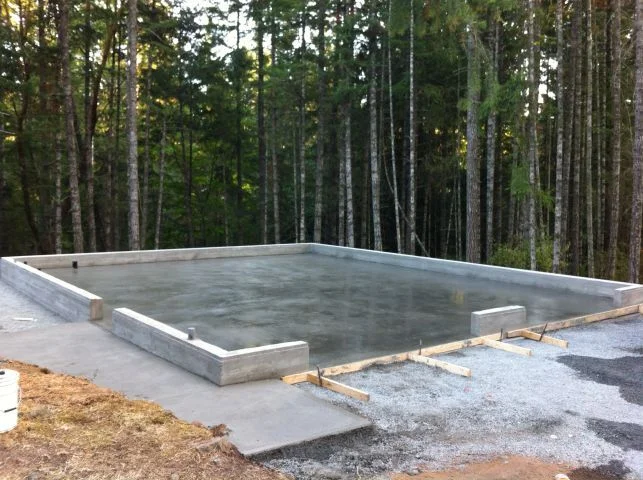

I guess the majority of shop slabs are 4" and potential plans of a two post lift i opted for a thicker slab with a higher MPA to anchor to, which meant rebar was still prefered. I got the groundworks for a future bathroom, shower while i was at it too. Now i need to get to work to pay for the second half...:rolleyes:
