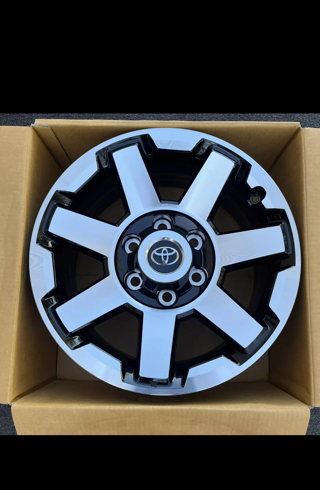

Hi all! This is my first post. I’ve got a 2015 GX 460 Premium trim and have had it for about 2 years now. I’m finally getting to a point of making modifications, with the first ones being a bumper chop and running board removal. The second and much more expensive move is new wheels and tires. I want some 17” wheels and I’ve noticed it’s pretty easy to find some 4Runner 17” OEM takeoffs and I LOVE the way they look, especially with the excess chrome trim that’s everywhere on the 460.
My biggest question is regarding the Offset difference. The TRD ones have a 15mm offset, while the stock GX ones are 25mm offset. I’m wanting to fit 33” pizza cutters and am curious how much potential rubbing there will be and if the zip tie trick and some heat gun work will be enough, or if there’s a potential need for a body mount chop.
Does anyone have any experience running these rims and what kind of problems did you run into?

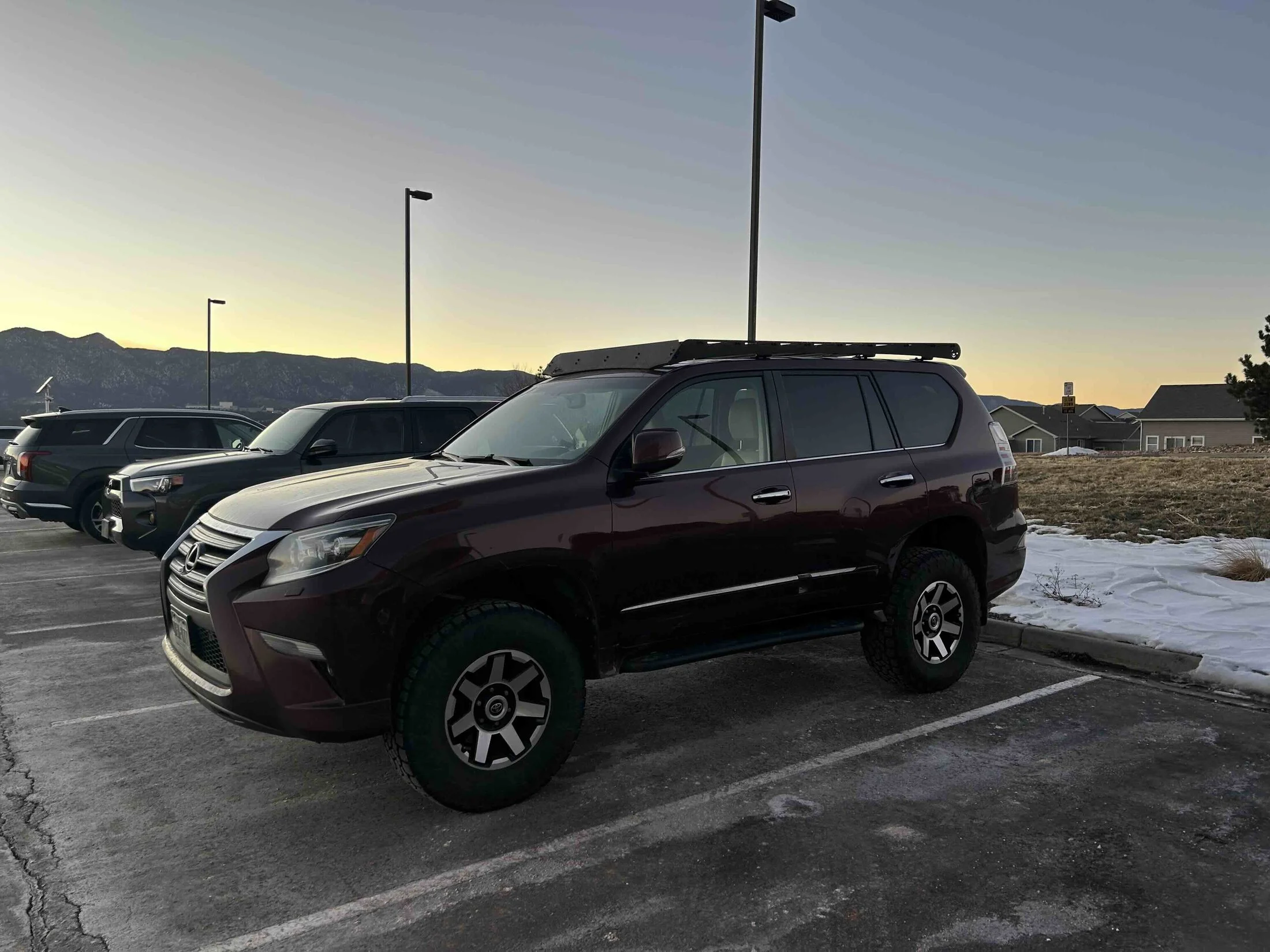

Another data point for you: My 2017 GX has OEM 17" FJ Cruiser wheels. I think they have an offset of 15mm. I'm running them with 265/70/17 Wildpeaks. The wheels/tires were the first mod I made. I had some rubbing at full lock, but was able to use a heat gun and maybe some zip ties to get the needed clearance.
I presume they are the same as the FJ cruiser steelies, in which case you should be fine. The only wheels you have to watch out for are some of the TRD wheels.

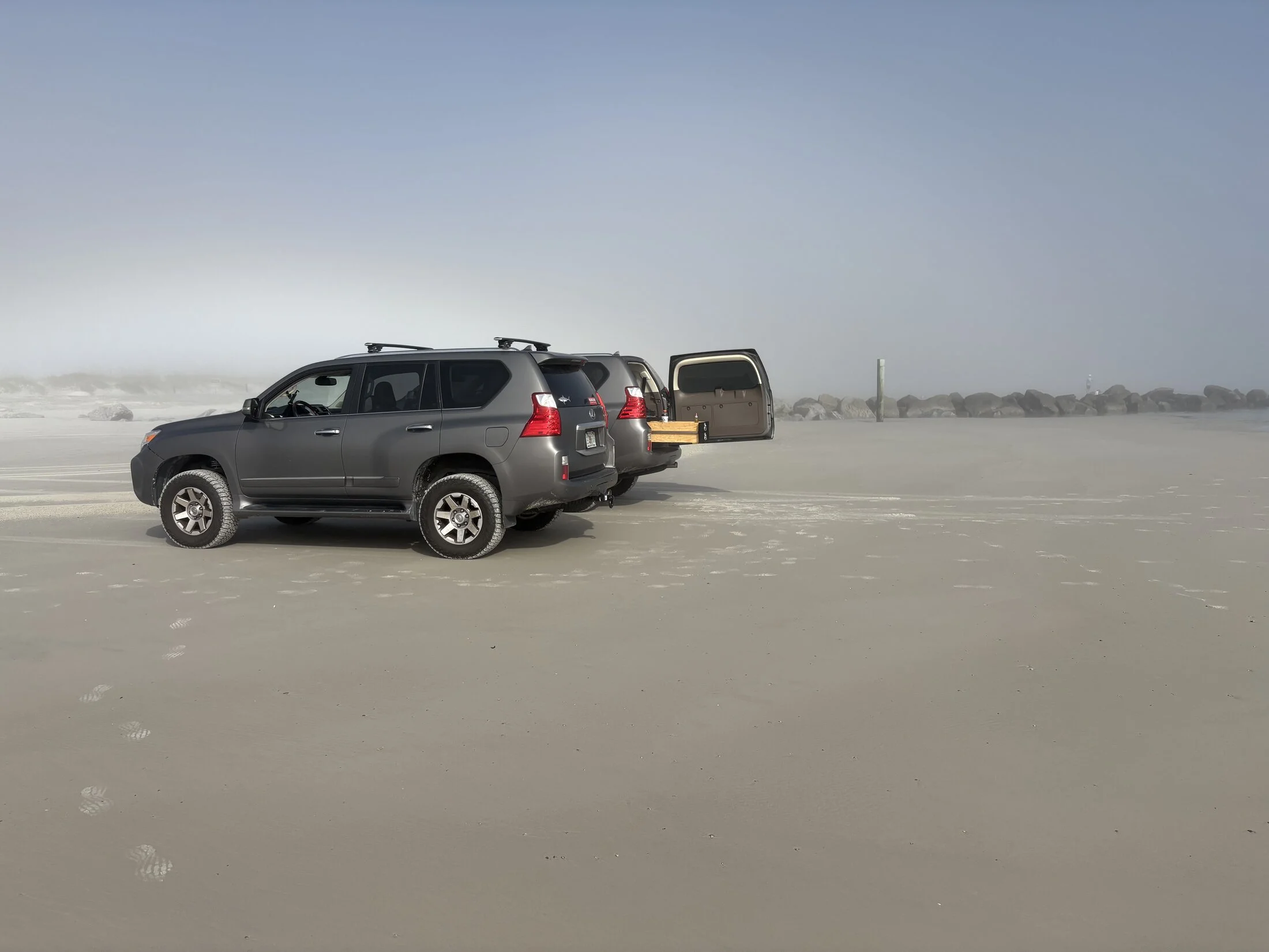

I am also running 33.3" tires on the oem GX wheels and have wheeled with them.
