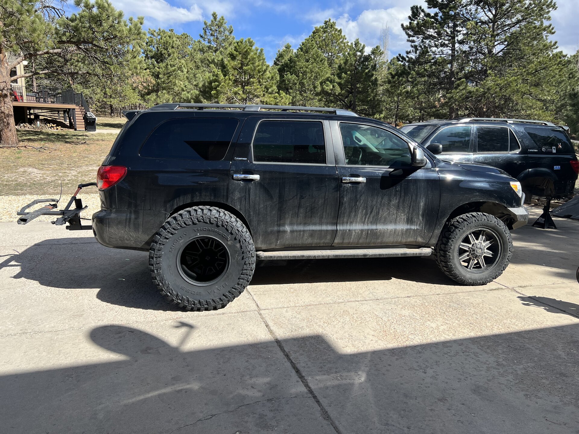

This is what the 40’s were going on, and it will be leaving on a salvage yard truck (with almost 400K miles) because a one ton conversion is a bridge too far. Mostly I want this stuff out of my driveway and garage :hillbilly:.

Here’s the new baby. Suspension was hacked together by Toytec and is way off (bouncy flouncy a shop thought the PO needed a new steering rack and front LCA, we’ll see, I don’t think so). I have to de-chrome mine now, it looks cheap side by side.
