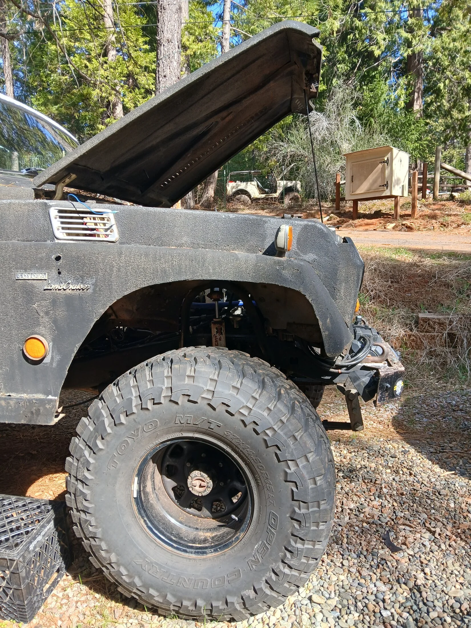

Toyo do. I been running their 37x14.5x15 M/Ts for years...
