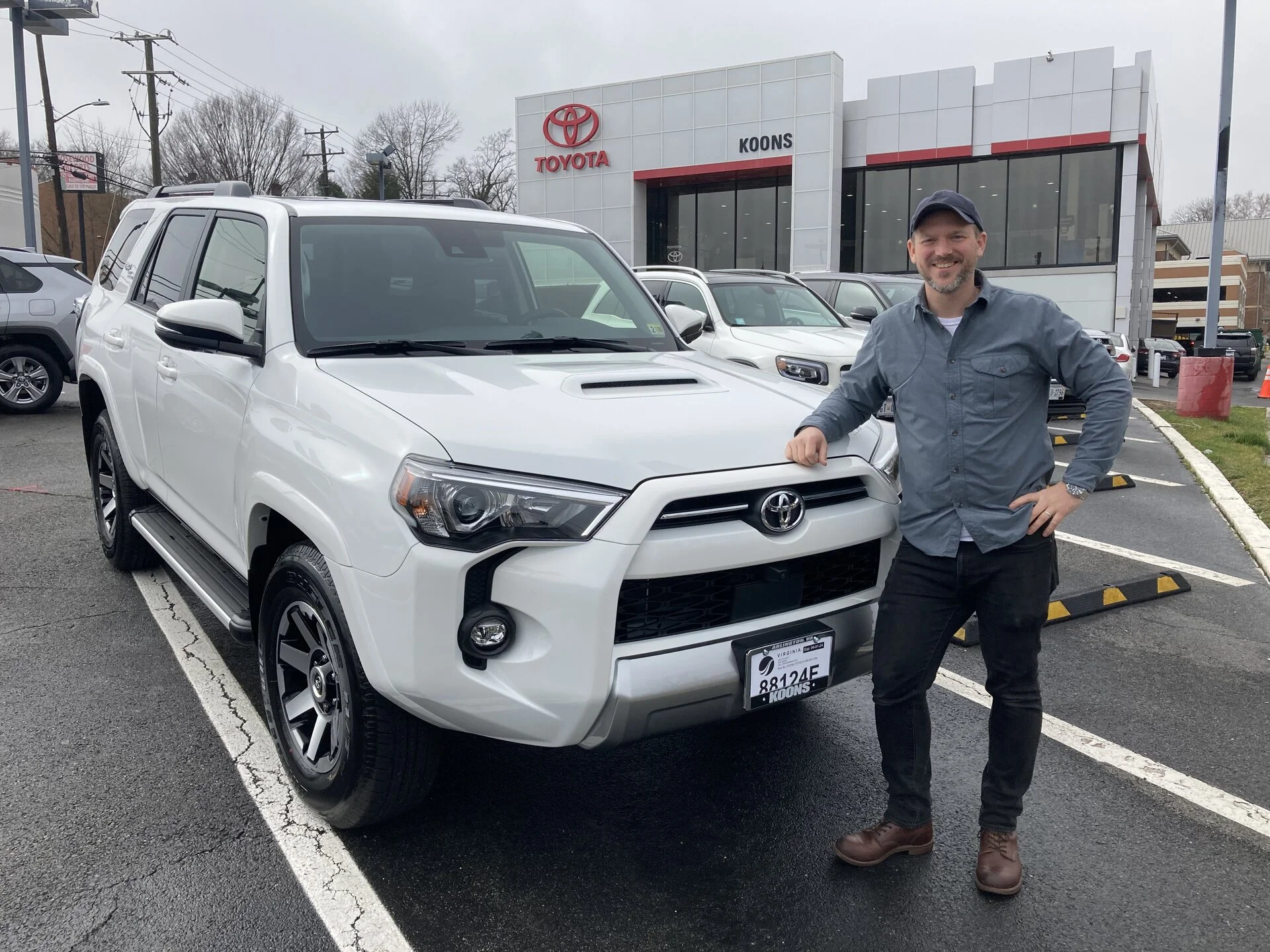

You can see my build thread for what I ended up doing with a similar use case. I ended up going TRD Off Road with KDSS and then adding a 1/2" top hat spacer to get 1" extra ground clearance up front, an aftermarket skid plate to protect the front diff and oil pan, and some rock sliders (Toyota sells OEM rock rails that also work well). The best skid plates and shocks are aftermarket.
