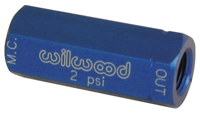

Yeah, I figured I was just going to have to live with it. The difference isn't huge, but it's there. I'm confident I bleed it completely. I wonder if an inline proportioning valve would solve this? Maybe some residual pressure on there?
a 2 lb residual valve might just do the trick.. I have one in my system (1 ton all around) and it seems to stop on a dime..

Does it install at the master? Between the master, and the hard lines? If so, I'm thinking I may try one for just the rears.

it goes inline in the rear circuit..
mine is right next to the master with about 3" of hard line between it and the master.

Now I gotta figure out what size the fittings are so I can connect the FJ80 master to the stock 62 hard line. The 2 lb valves are 1/8 in. NPT female on both ends.

I just used one from summit.
They are cheap enough..
Do you have a brake flare tool? I installed mine by simply cutting the stock hard line, flaring both ends and inserting it. It was very simple..
The Downey one looks like no flaring is needed (compression fittings). Which is a perfectly fine way to go as well.

Nope, no flare tool but I could get one. Then you just used a 1/8 in. NPT male on both sides of the valve. Got it.

Acording to downey here
"Although there is some weird 9mm stuff on older Landcruisers, all 1970+ Landcruisers, Pickups, and 4 Runners have 10mm brake line fittings. These high pressure hydraulic Swagelock fittings are 10mm -1.0..."
So, it looks to me like I could use these:
one on either side of the residual valve and just screw it inline on my factory line on the rear brake output line.
I'm concerned about cutting the hard line and flaring it because of reversibility if the residual valve doesn't work.
thoughts?
To add a residual valve directly to your master you would need a 10mm flare/1/8" pipe male/male union (male into the master and male into the residual valve, then you would need a 10mm flare/1/8" pipe female/male to go from the residual valve to the stock line.
Master - male/male adapter - residual valve - male/female adapter - Stock line
