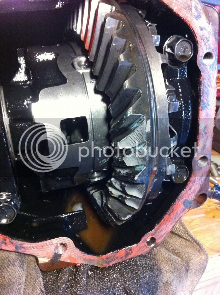

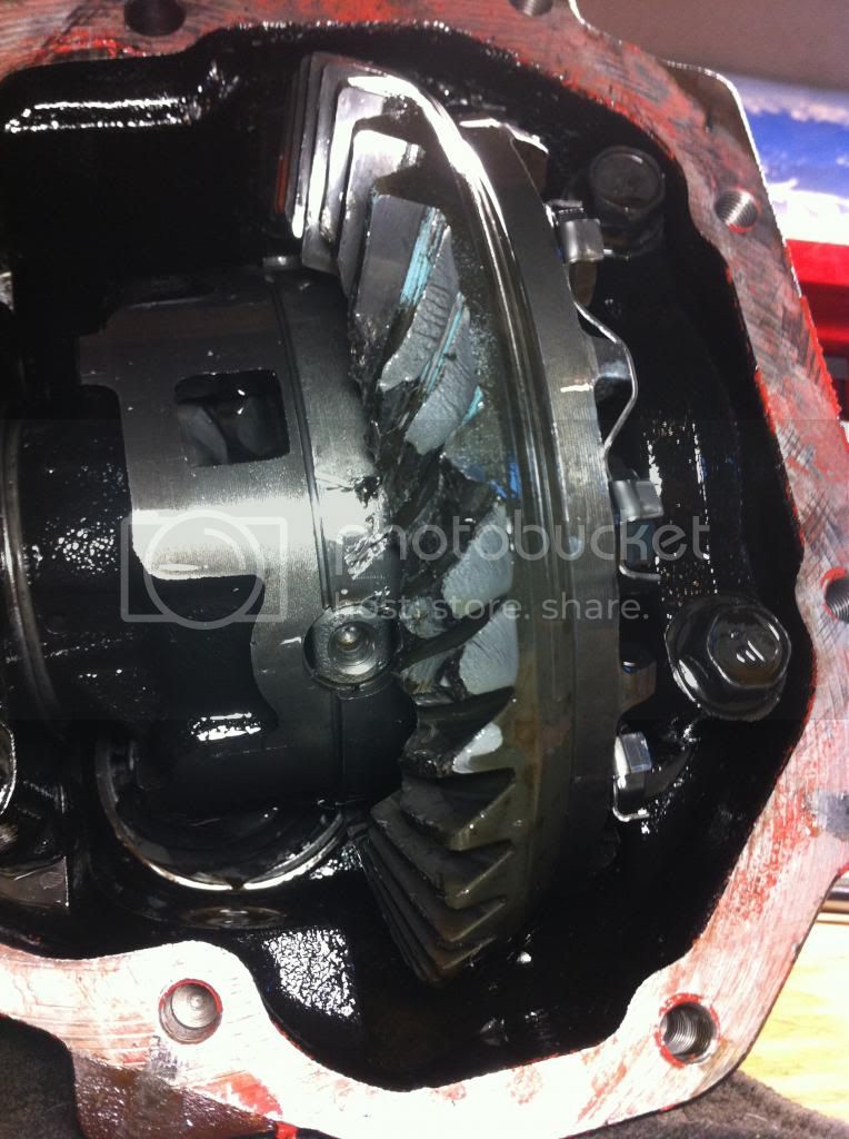

In case you guys were wondering, here is the carnage...
As I expected, it appears that at least seven of the splines on the ring gear stripped and there is a little damage to the spider gears housing, although it appears to be superficial.

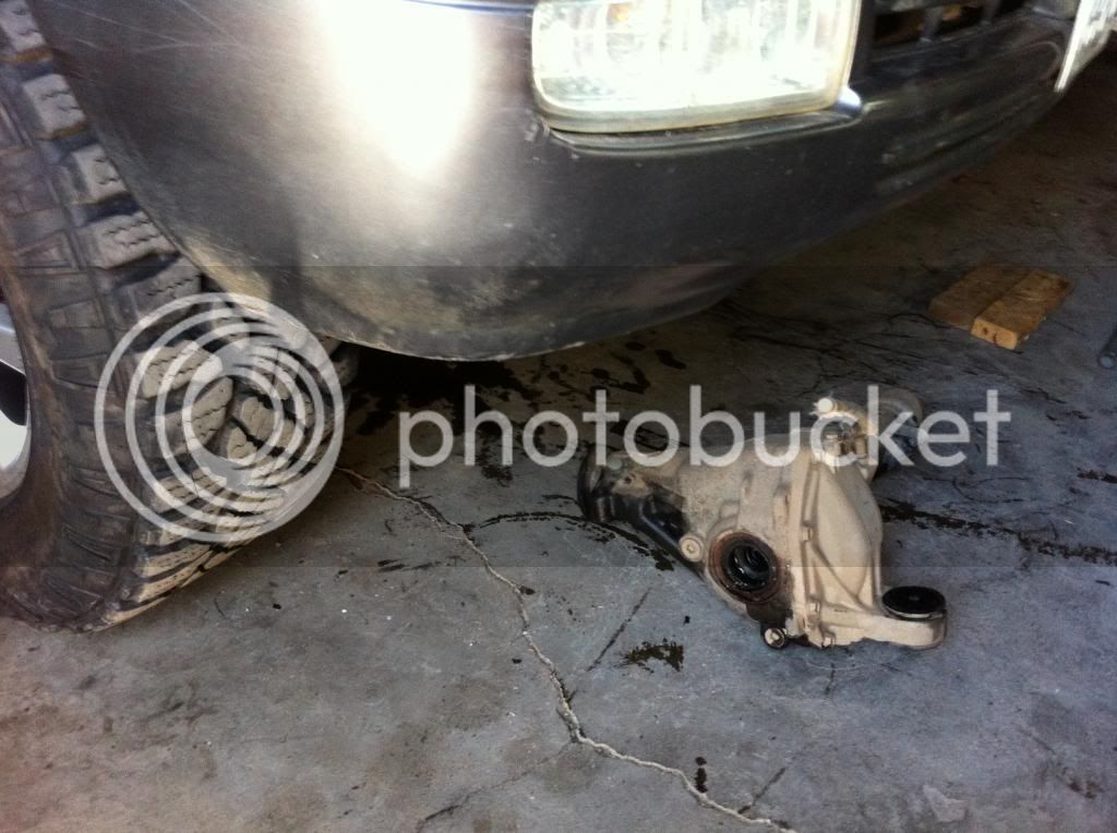

It took me about 2 days to drop the diff housing and cost me some broken caliper bolts on the passenger side. :doh:
I guess the money I may have saved pulling the diff myself will be spent on drilling and tapping the axle hub. s***! I feel like I wasted my time. :bang:

I didn't have to "pull" either hub to get the CV axles out and drop the diff housing. In fact, you do NOT have to pull the brake calipers off either. Step #5 in the FAQ (https://forum.ih8mud.com/100-series-cruisers/388534-cv-boots-replaced-directions.html) is not needed. The FSM also calls for removing the brake caliper. I wish I never did this, because then I wouldn't have broken off the caliper bolts on the PS which caused me to have to buy a new axle/hub knuckle :bang:
It depends on what a "bunch of cash" is to you. It looks like at Slee I will save approximately half of the r/r cost for the diff, which is only about $125. In fact, they said putting the diff back in is more time consuming than pulling it out so, in actuality, you would probably save less than $100 to pull the diff yourself. IMHO, that's not worth it to me. It took me 5 hours to pull the first CV axle, 2.5 hours to pull the second (knowing what I was doing) and another few hours to drop the diff. That's about 10+ hours total or less than $10/hour. Not worth it :doh::doh:
