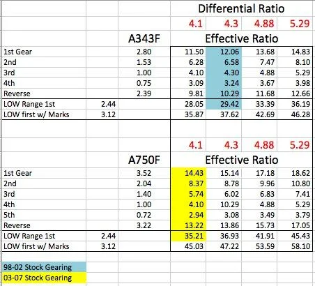

Hi, New to the forum,new to LC ownership, just picked up a 99 and was out on the highway the other day and was hoping for another gear at around 70ish, i know i'll be spending most of my time around 80ish. I thought the RPM's were high compared to just about any other vehicle I've owned. What year did they go to a 5 gear and does it make a difference at highway speeds at lowering the RPM's? Thanks for your help.
Go to 33s and split the difference.
The A750F has both a lower 1st and higher 5th. Better acceleration all around.
At 70 I'm at 2500 RPM on stock tires. I've never cruised at 80, but would think 2900 plus. What is a 2003 turning at the same RPM?
Hoser has a pretty good chart showing the overall effect including diff ratio:
attachment.php
