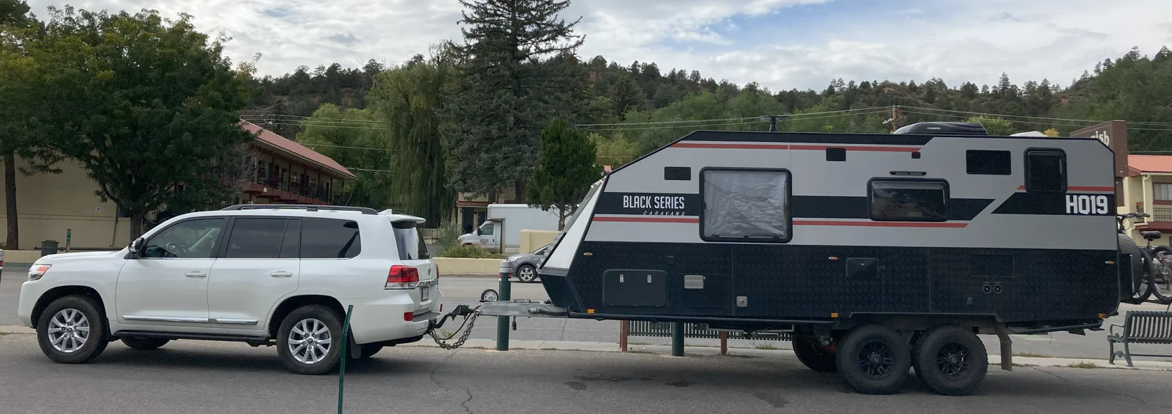

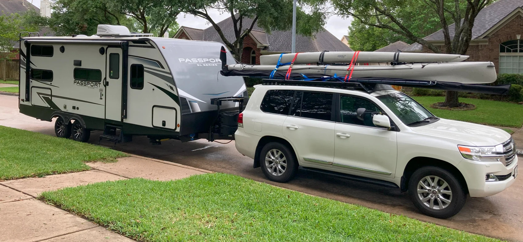

Rental before we purchased our own less capable yet slightly roomier and about half price trailer. Good luck doing this with an LC250.

I’m not so much worried about towing, I’d buy a tundra if I was going to tow that big of a trailer.

Yes, LC250 may work for your needs and the way you have put things in boxes, yet I like to have an SUV/Wagon with closed luggage space and carry passengers in comfort, while being able to carry a large kayak on the roof, tow our travel trailer at about 7500 to 7800 lbs loaded, is pretty good offroad and is very reliable. A vehicle which can do it all, which since the 80 series has improved with each successor. As it happens Toyota has a capable follow up to the LC200...the LC300. The new LC250 Land Cruiser Prado cannot do this. It is a vehicle one class down. Taking the same place as the 4runner which is confusing to say the least.
As such for me/imo it is not the return of the legendary Land Cruiser. It is a Prado and now with a drive train I would not choose unless it is just for city driving (= hybrids best place to save gas).
