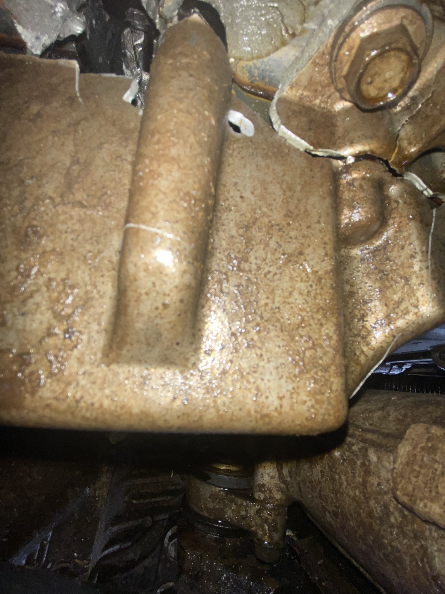

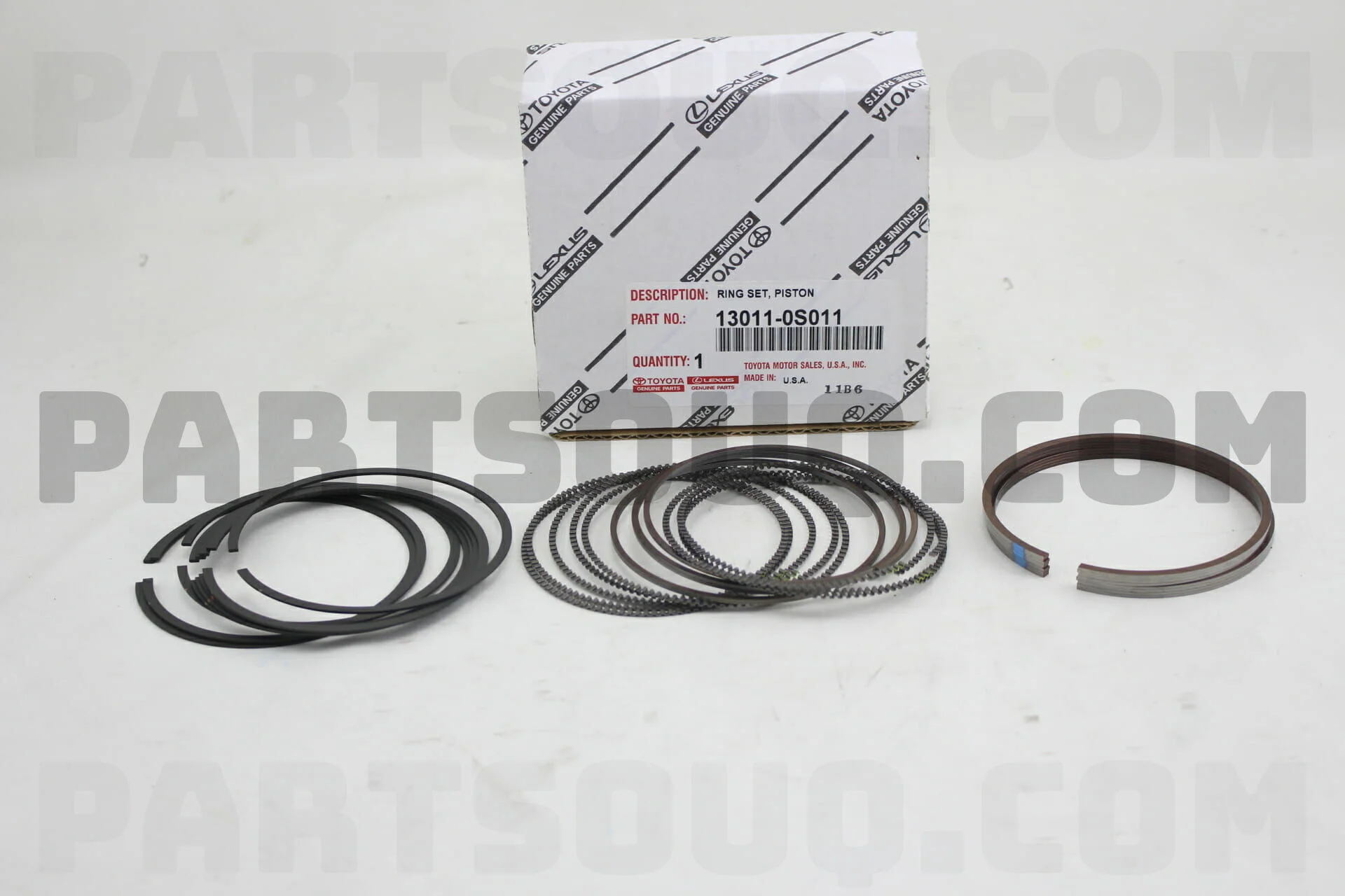

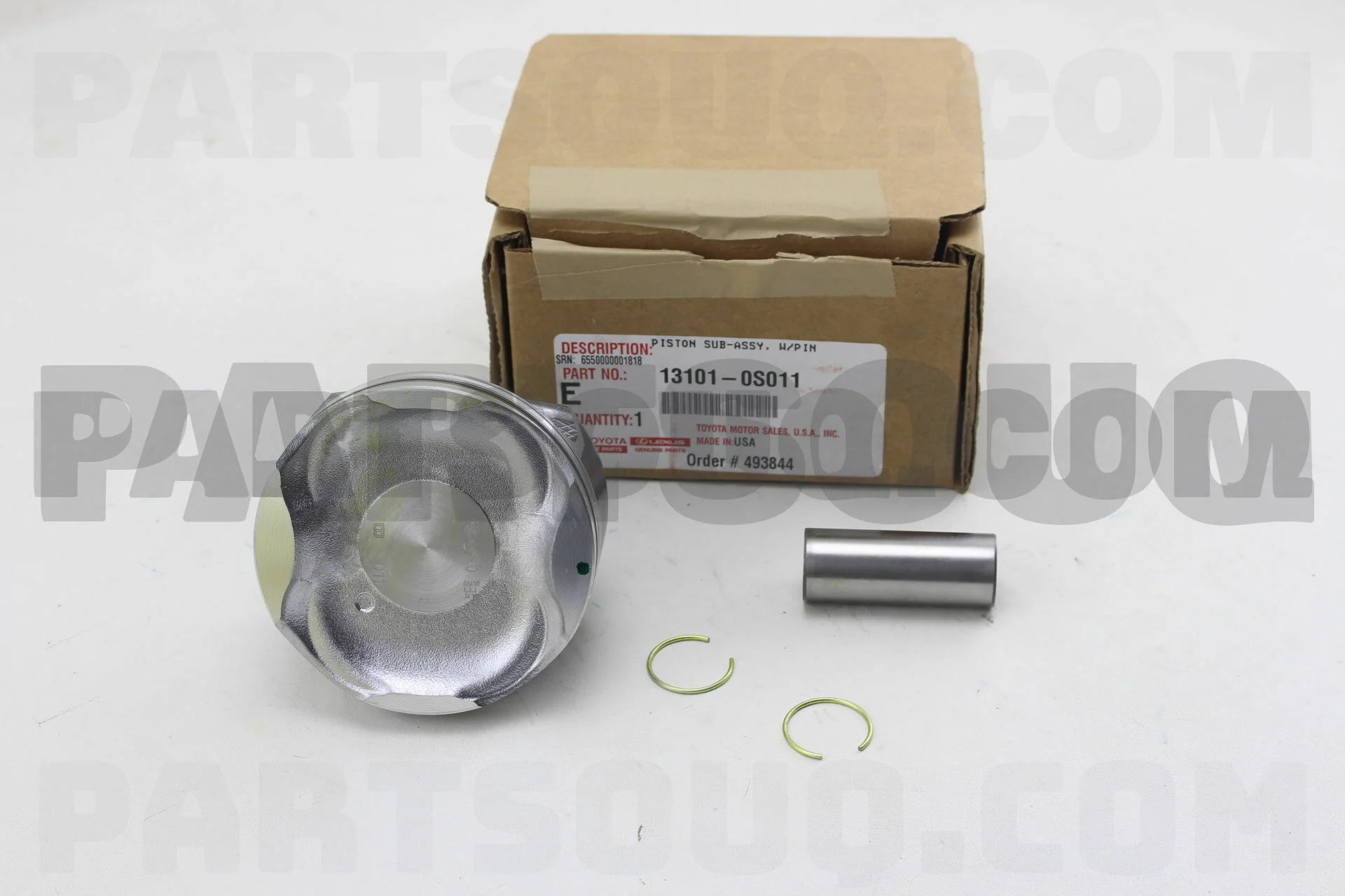

Blown engine. 2011 Land Cruiser, build date 11/11 (missing link). 216K miles.
Cause yet TBD. Will edit, when more info available.
Morning drive after heavy mountain snowfall.
Coolant was found to still be in radiator (full) and reservoir (1/2).

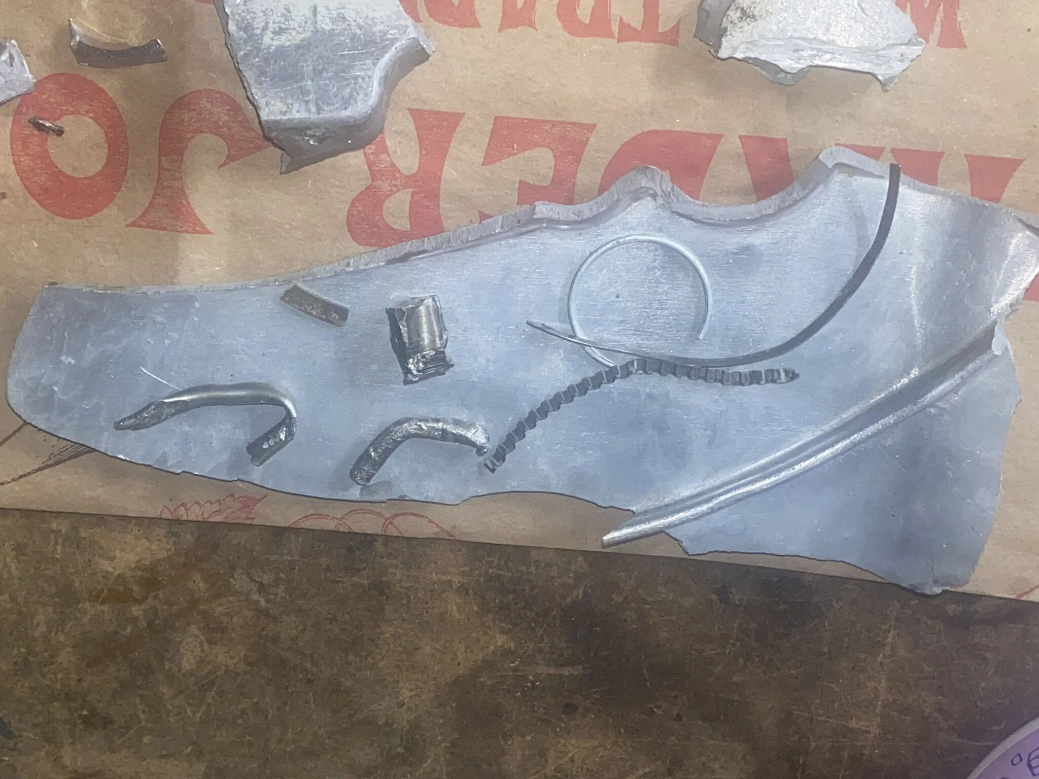

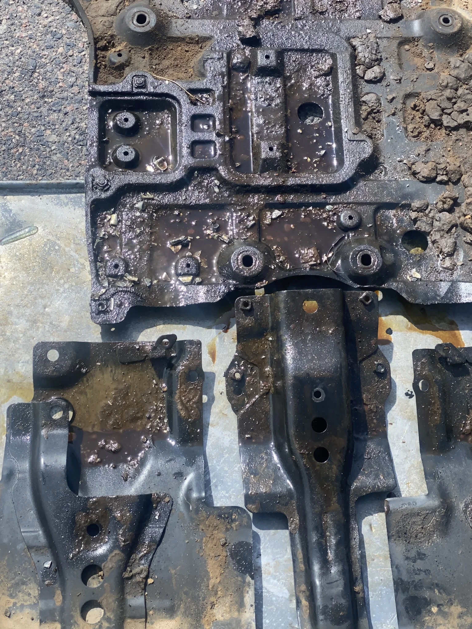

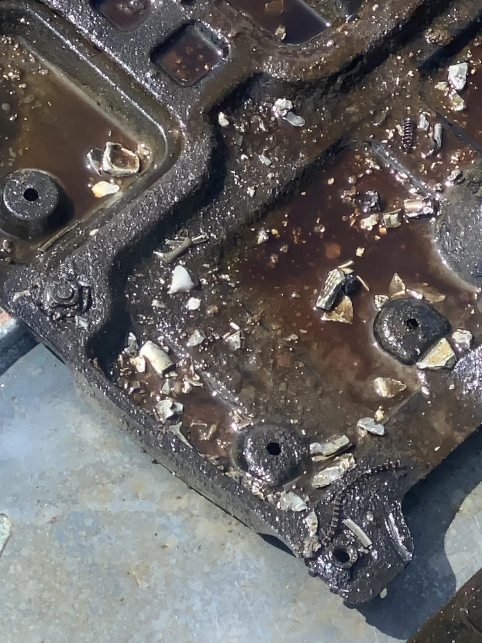

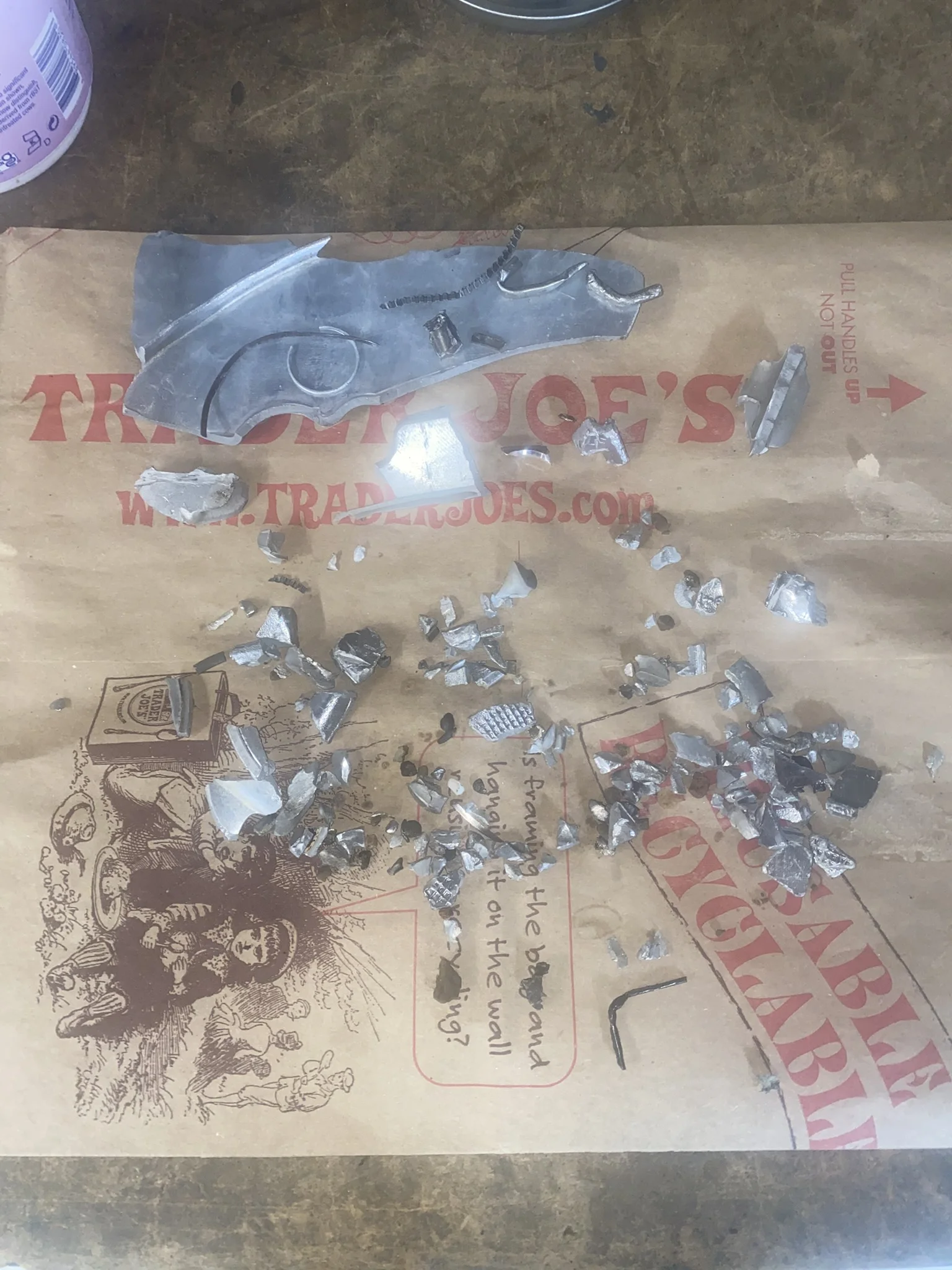

Chunks of oil pan aluminium along with piston oil ring, wrist pin snap ring, lower cylinder oiler tube and more YTBID found in skid plate.
Hole in lower end of 3UR engines upper oil pan.
Busted out upper oil pan.
Metals & oil found lying in skids (undershielding)
Recovered from skids & engine. Once oil and sand washed away.
Shock picture, to aid in identification of parts.
Snap ring, oil ring and more.

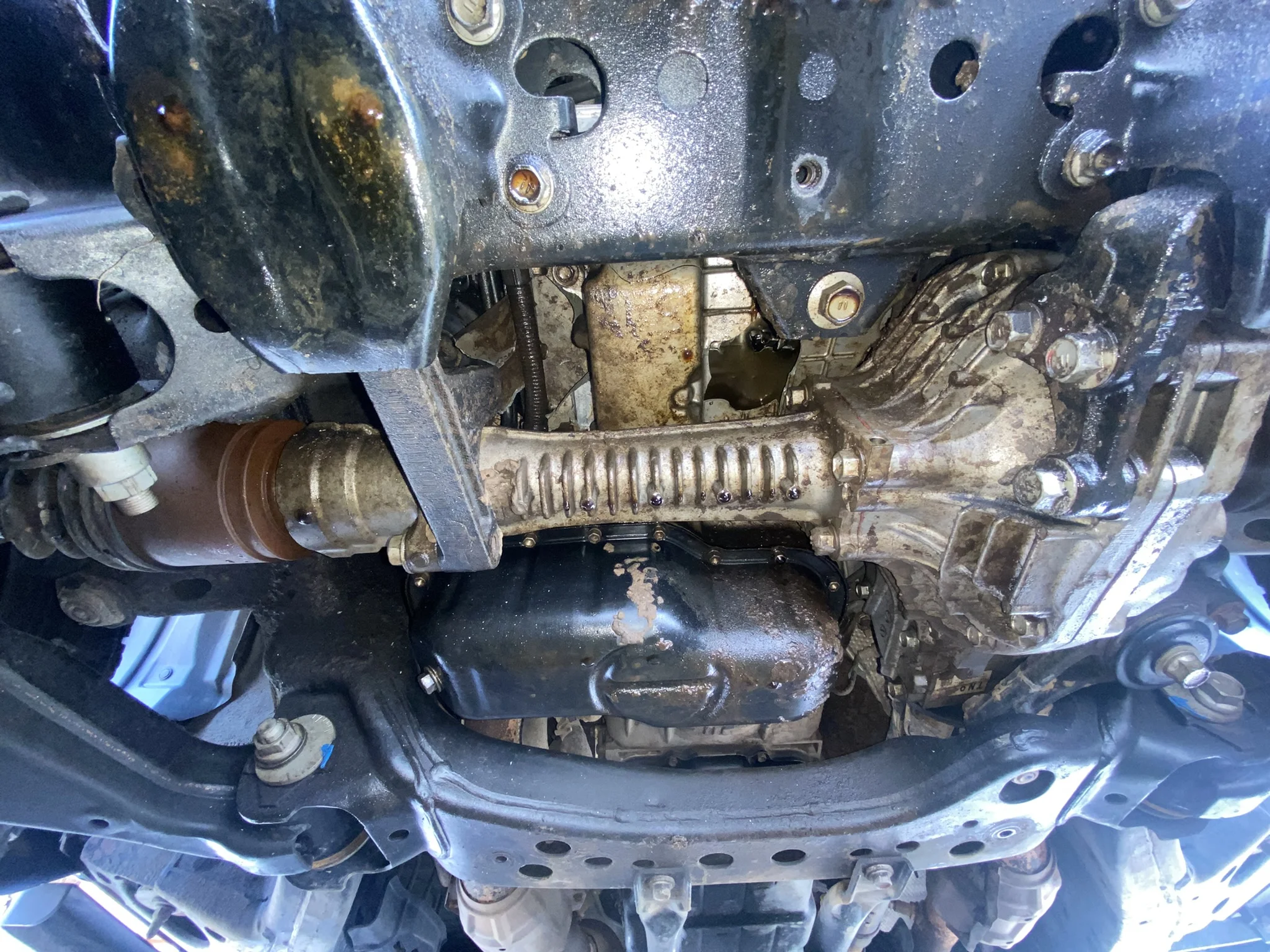

Same 2011 blown engine, as post above. Hard to see. Nut may be a busted connect rod came through oil baffle and upper oil pan. Using borescope to look around.
Other thread of engine issue. Like blown head gasket, timing chain tension, valve spring. That may or may not have been caught in time, to save engine.

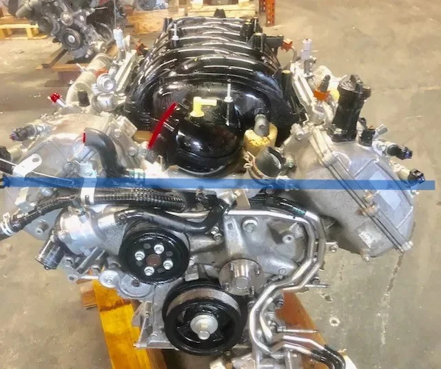

I've never measure how many qts low, before coolant level below Engine Coolant Temp (ECT) sensor. But it not much. Typically if we look in radiator, and see no coolant on top of fins. Then coolant level, is below ECT sensor. ECT sensor is near top of coolant system. In the front water bypass joint. When coolant below (blue line) ECT sensor, water temp gauge or even when read ECT through tech stream. Will read lower, than actual coolant temp is in the block.
Blue line is crossing ECT sensor.
If we turn cabin heat full hot, after engine run time when we'd expect it at operating temp ~187F. If air feels only warm or even cool. Coolant is to low to get too heater cores. You can bet, it also below ECT sensor. Water temp (ECT) will read low. Until coolant expand and reaches ECT sensor. Then gauge shoots up. NOT GOOD.
