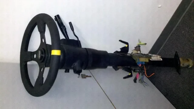

After the shake down run, it was quickly noticed the stock column and wheel weren't going to work. Since the the column I picked up at the pick a part did not have keys, I picked up a new ignition lock and key from the local parts house. Once that was installed I bolted up the new Grant 13" wheel. Now I will have some room between the bottom of the wheel and the seat for my legs and the tilt is going to be a huge plus.
