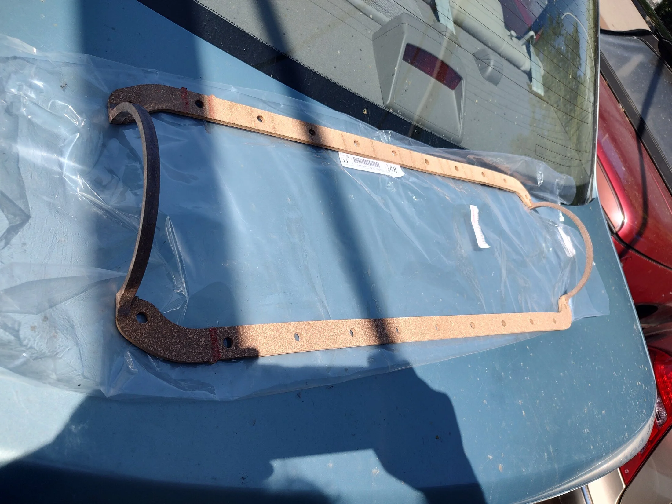

FYI, I read in a few posts that people didn't know if this was a one piece or four piece gasket, I got it from Toyota and it was a one piece gasket, I believe this part number from VICTOR REINZ 715220210 is probably the factory gasket. From the picture it looks like it's also a one piece gasket, I'm saying one piece but it really is four pieces they just glued the pieces together.

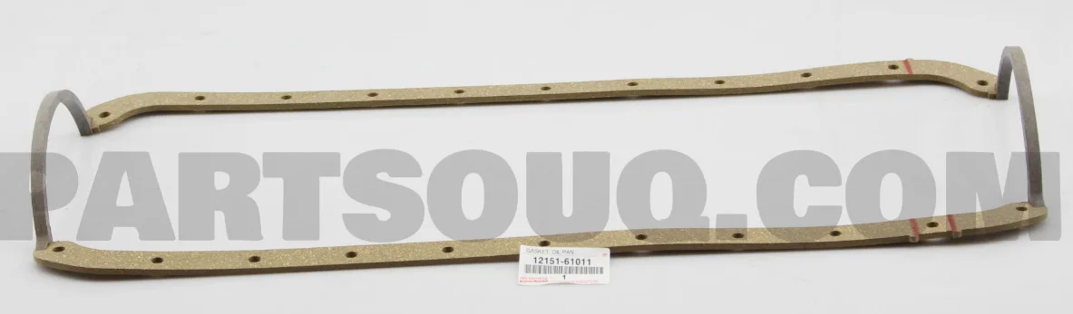

The 3FE oil pan gasket is 12151-61011. About $25 from our friends in Dubai, $30 or so from your local dealer.
It has always shipped as a 1 piece cork gasket from Toyota, with the front and rear arches glued in place.
