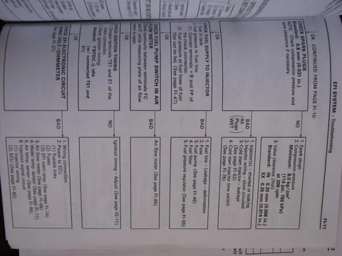

This might help, I see the air flow meter/wiring is another possibility, I've had a no start after swamping the air filter and forgetting to reconnect the wiring at the AFM after drying everthing out, but that was more of a catch and immediately die.
Sorry for the orientation, I'm useless on a PC.
