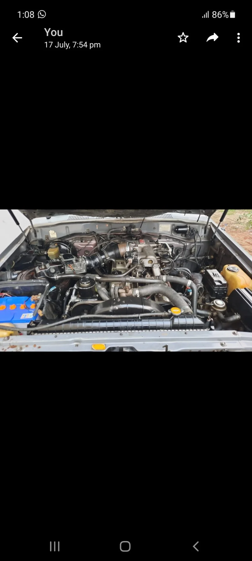

Well, i have only this info of my truck (attached)

Have you checked the spark plugs, air filter, looked for loose vacuum hoses? I would also ask on the 80 series forum where 80 series with 3FE engines go to get diagnosed. You will most likely find someone therewho has had the same problem.
What color is the smoke? (Is it dark or light colored?) Eye burning sounds like you are running very rich. Agree with other comments to reset ECU and replace plugs.
