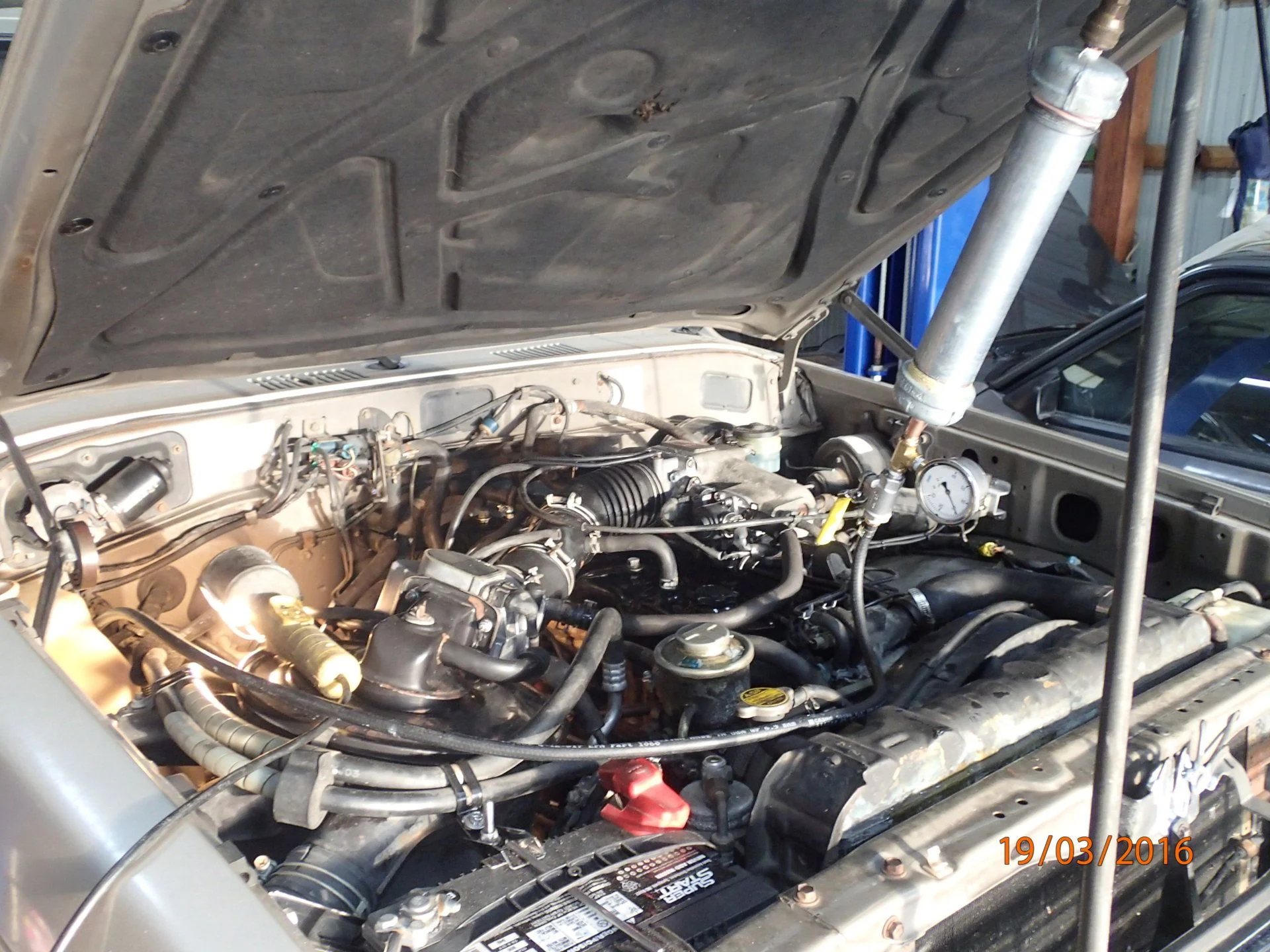

I built this:
Just pipe fittings. Allows you to run the motor on straight injector cleaner. Or alternatively you can run your tank down as low as you dare and dump a couple or three bottles in and run it.
