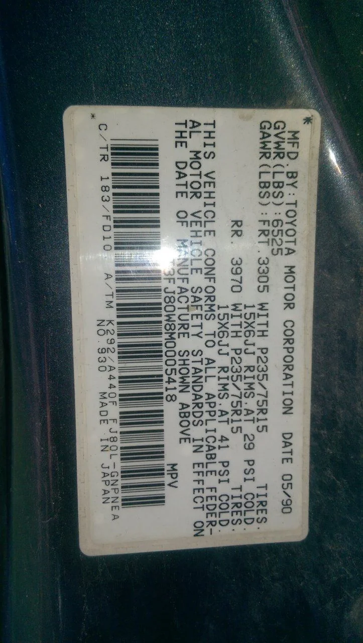

Just bought it. from a buisness auction. WONT FIRE UP.! (doesnt have spark). no check engine light. bought new igniter,coil still no spark. Odd diagnostic port at pass firewall. catalectic converters were cut off (stolen). I repaired 4 wires going to trans.(maybe incorrect).new fuses/relays. got new cap and wires also. Can I bypass computer to start? I have been thrashing/rebuilding my 73 fj40 for more than 25yrs. don't have much experience with efi 3fe ?motor. It came with at/ps/ac/sun roof elec. windows/locks and center diff lock button. And shift lock overide button by shifter. here is pict of vin.
