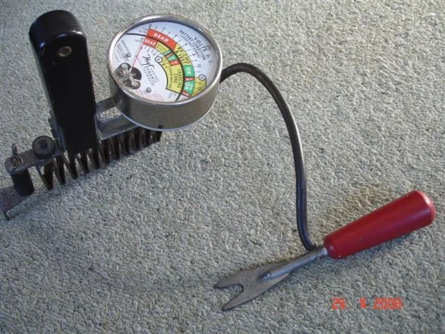

You need a meter that'll show you the voltage output of your battery under load.
Here's an old tool I use for that:
And I'd never be without a battery charger at home. (If you find your battery is flat, you'll need to charge to charge it and monitor how it holds its charge.)

Tom, that's a very unique voltmeter, I haven't been able to find one like it online.
It's just old Mike ..... (Like me and just about everything I like to surround myself with...)

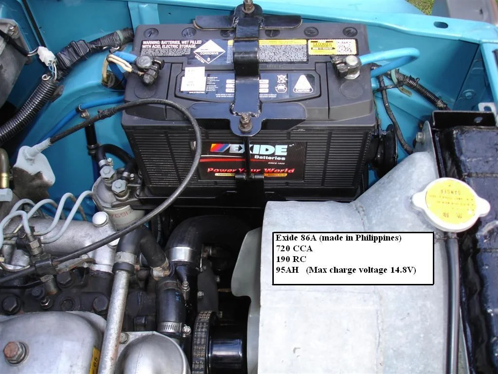

EDIT: If you need to replace your battery, it's best to get the biggest one that'll fit in there.
I even enlarged my holder/clamp so as to fit this one:
More CCA = more peace-of-mind
