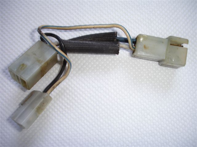

It might pay to check your fusible links.
In case you're not aware, your BJ42 came with fusible links to protect your loom wiring from short-circuit damage (and thus to protect your vehicle against electrical fires).
A short section of smaller-gauge wire was connected into each main loom wire near your battery's positive terminal with the idea that - were a short-circuit to occur - it would melt/blow first because of its smaller diameter.
These fusible links do deteriorate so perhaps this may be the cause of your voltage drop. (However, if this is happening your ammeter should be simultaneously showing a big negative current swing ..... unless of course one of the 5A fuses protecting it has blown ...which would not be at all unlikely in the circumstances.)
They look like ordinary automotive wire and deteriorate by becoming corroded and by breaking stands (often just from vibration).
Here are my fusible links:
