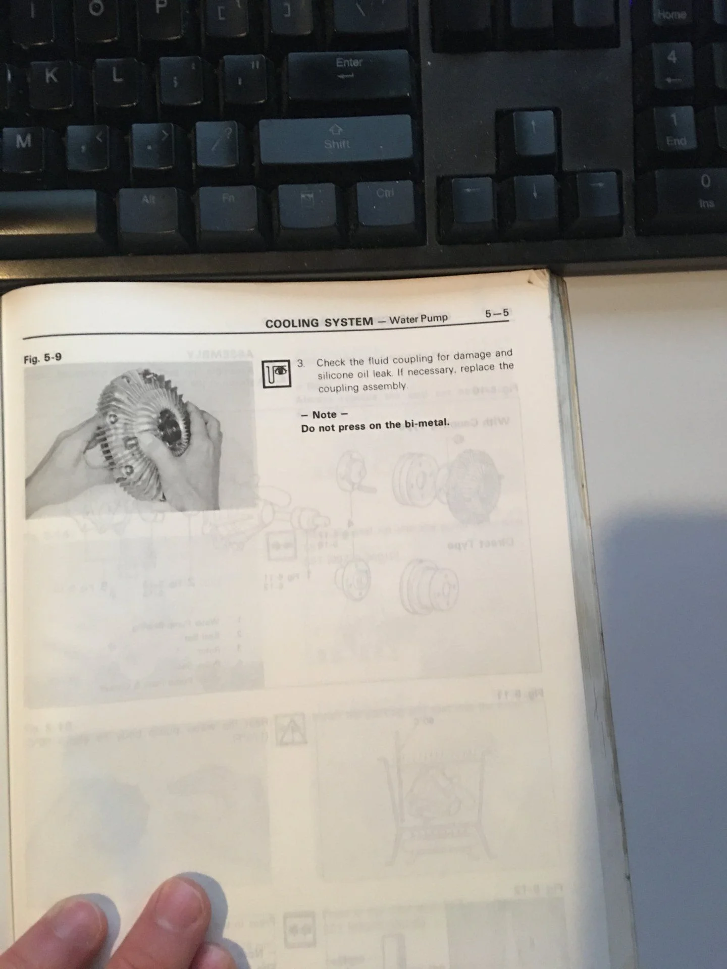

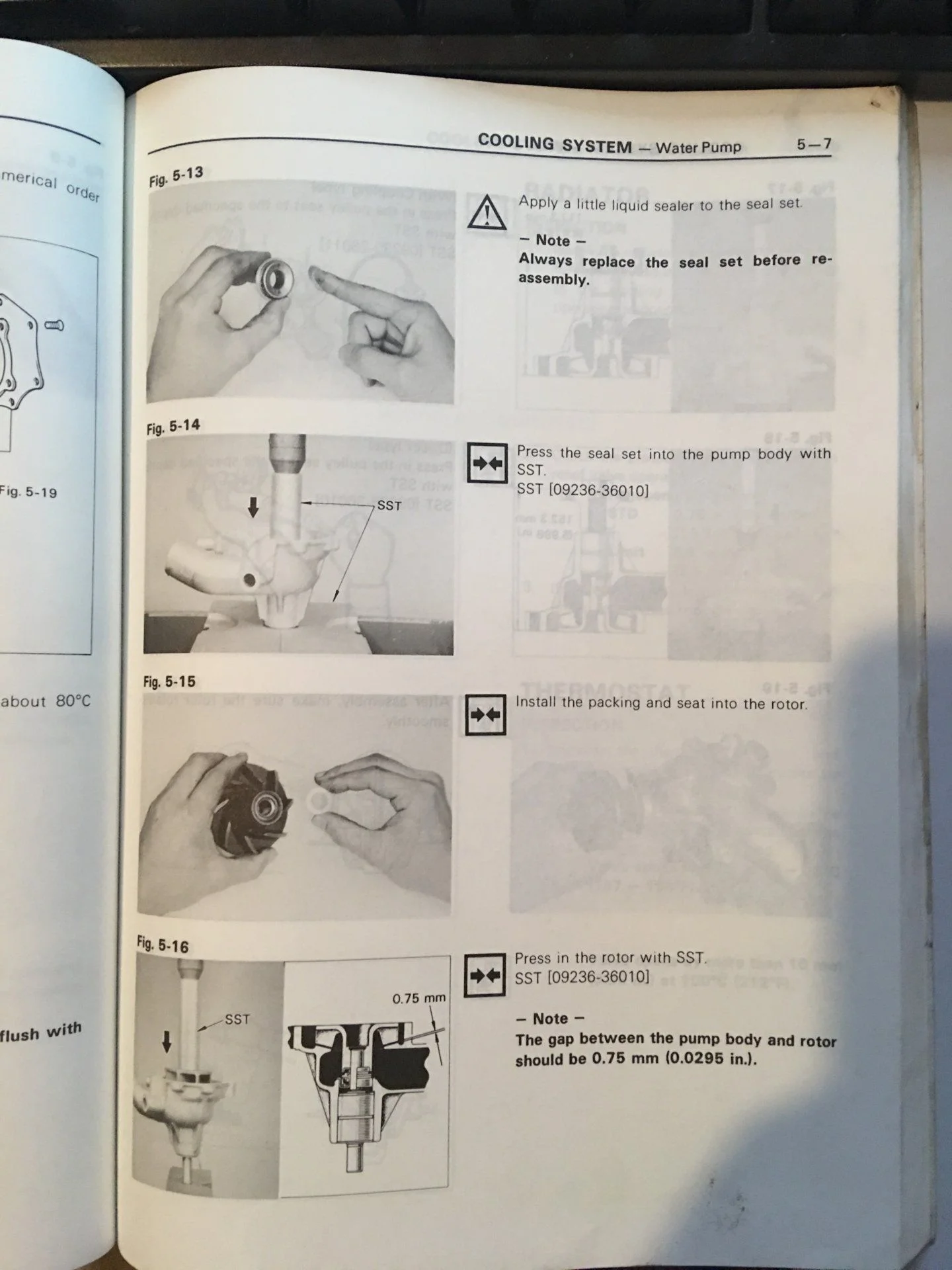

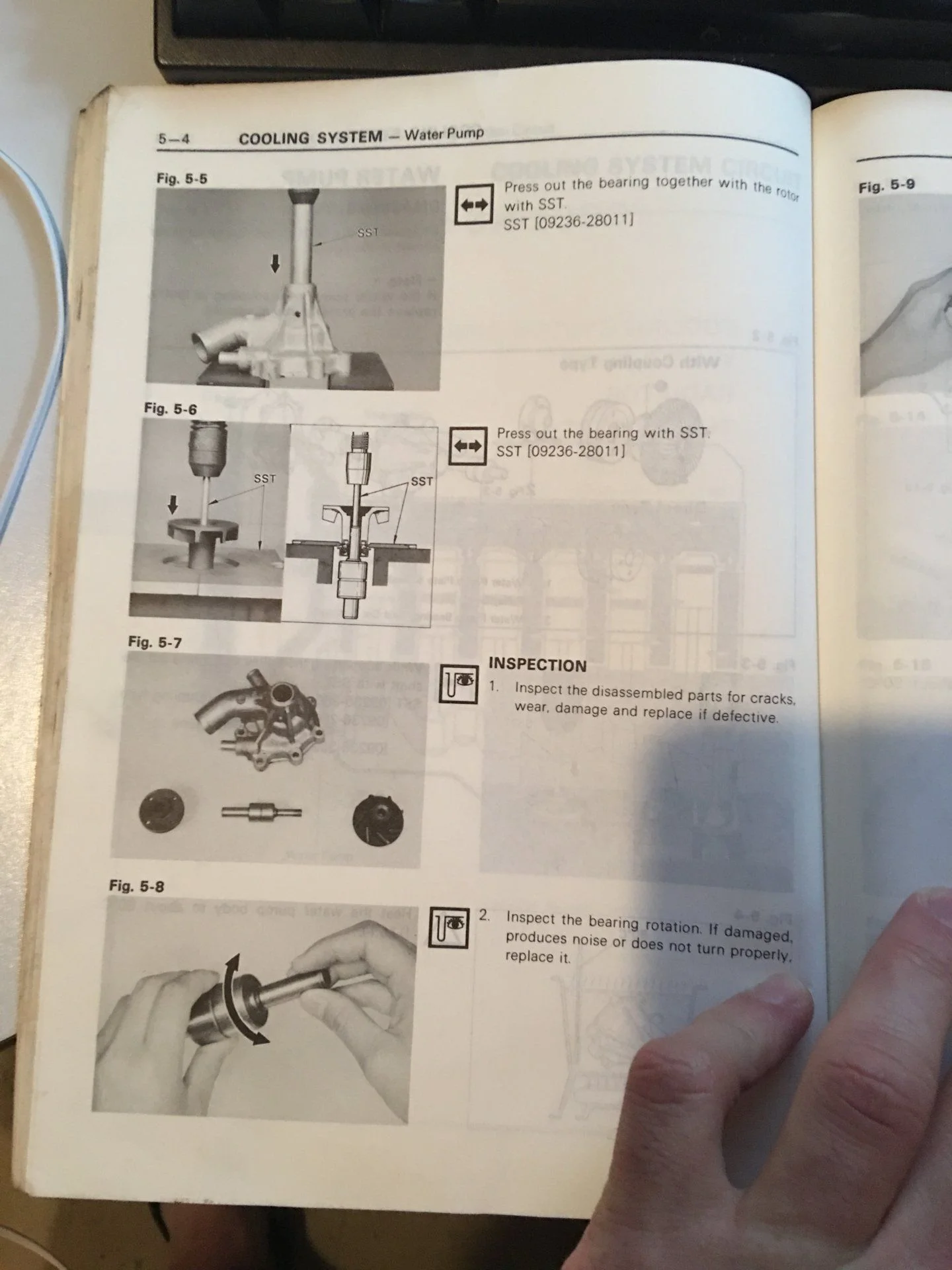

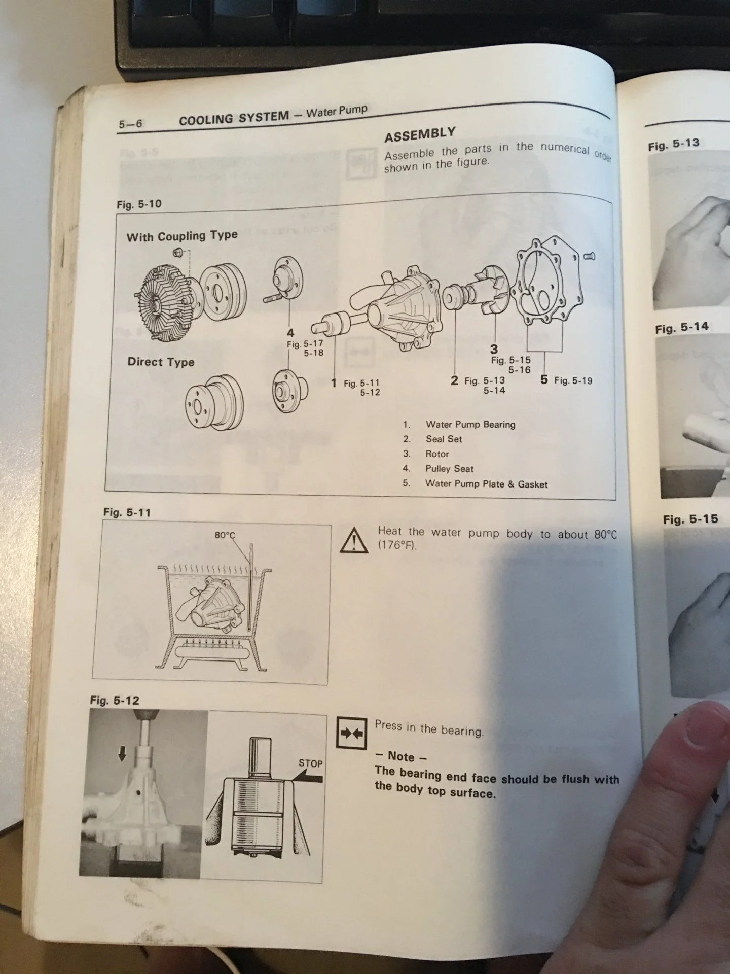

I should add, the 2F FSM instructs you to boil the body before putting in the various bearings. The SST is used to remove them, how I don't know.
Here is the disassembly:
I just rebuild my 3B water pump with new bearing and seal for $16 and another $10 to buy paper gasket.
