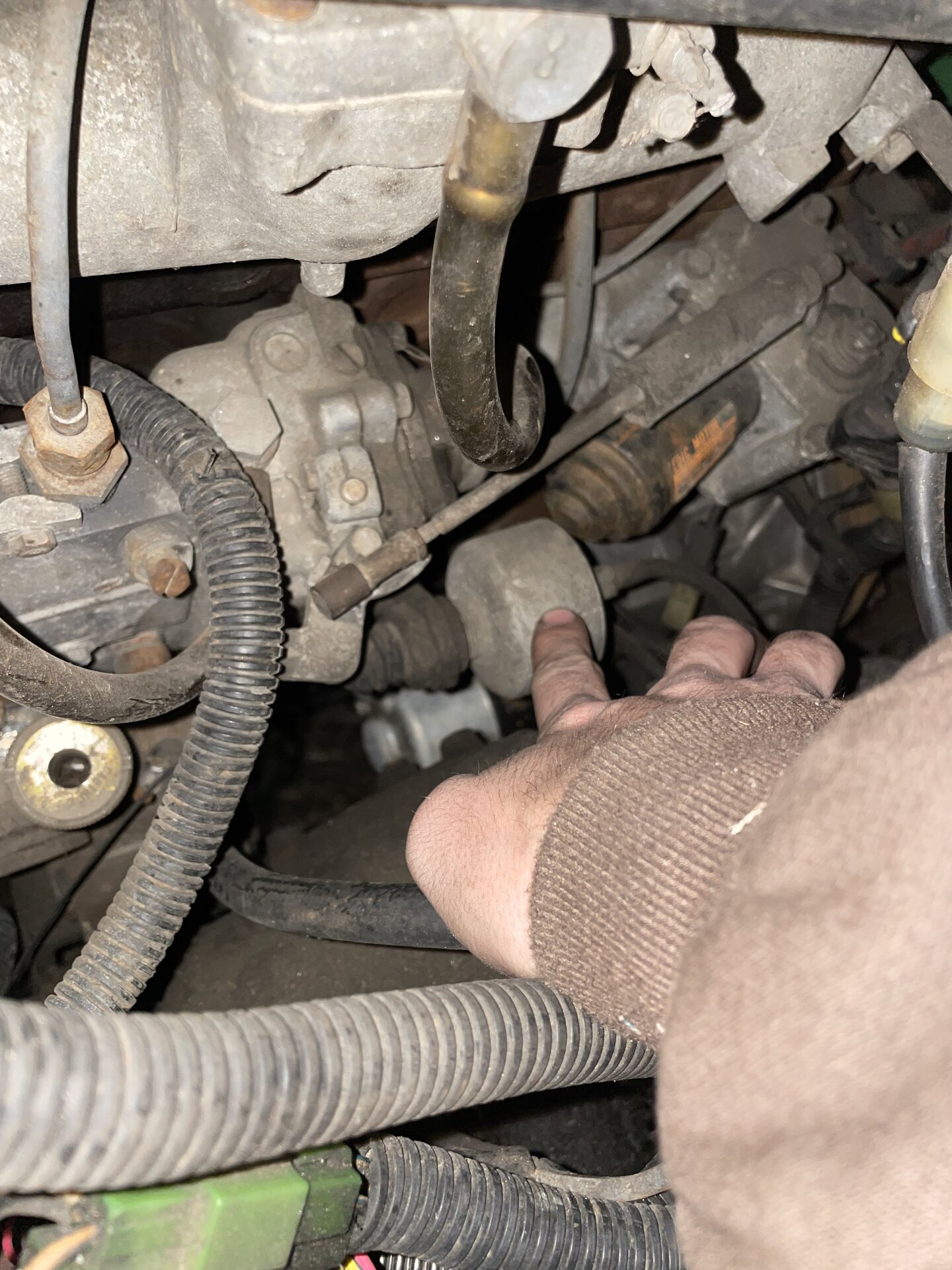

Also forgot to mention EDIC was working before but now the arm is stuck in the off position so I disconnected the arm so the pump is in its resting positing… the drive spot on the pump?… what is that big round thing that the arm on the pump hits if I push it towards the over inject spot? looks like stop of sorts but why so big and with a hose on it?

that thing near the edic pump arm is your HAC (high altitude compensator) the hose on mine just runs to atmosphere, it limits full fuel the higher you go (supposedly) and is just essentially a stop for the full fuel setting.

that thing on the edic pump arm is your HAC (high altitude compensator) the hose on mine just runs to atmosphere, it limits full fuel the higher you go (supposedly) and is just essentially a stop for the full fuel setting.

Is the hac the only “fuel adjustment screw?”… sorry if it’s a silly question, used to newer fuel injected gassers haha
no silly questions.... only learning.
it IS the fuel adjustment screw yes, and only adjusts the full fuel load setting
allowing max fuel to be higher (or lower with the hac doing its thing at altitude)
but to be sure of what is being discussed a picture would be best....

Here’s the pic of what I’m thinking we are talking about…. Yea would love to know more about good longevity things to do, while making good power
yes thats the hac/fuel limiting 'screw' towards the firewall is more fuel
