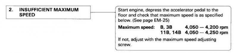

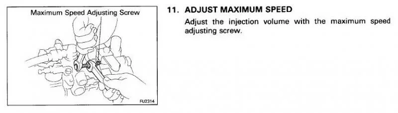

The Aug 1988 FSM for the 3B gives the following info:
Does that help?
:cheers:
Thank you, but yes I have tried that. It still tops out at 2600 rpm's. Pretty sure it is the governor. Not sure how to deal with it. Increased the fuel a 1/4 turn at a time and don't gain any. Gets to a point I start to loose performance as I can tell from engine sound and egt's drop a little as does the boost.

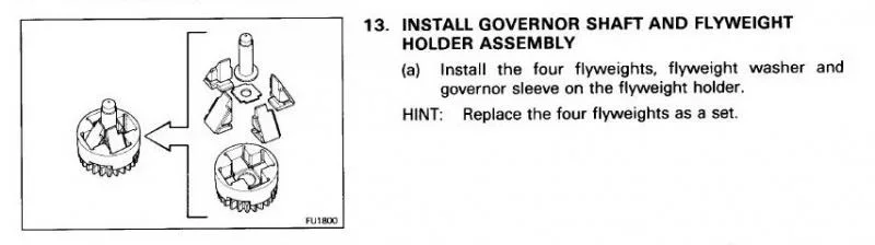

Yea! We're thinking along the same lines. I did take off the governor cover today and study the set up. The shaft o-ring was seeping a little anyway.(needs new O-ring) Kind of hard to figure out how the governor link works,but I'm sure it is from the pressure of the governor sleeve which is forced out by the spinning flyweights. I did measure the thrust clearance and it was .15mm. So by changing the adjusting washer to a min. size and ajusting the protrusion of the shaft back to the min. maybe that would change the distance thesleeve has to travel to shut down the rpm's.
I think you would need a stronger speed control spring and lighting uo the flyweights would be a bit tricky for balance. I considered filing off the end of the sleeve, but chickened out and put the cover back together and had to see if would run. It did once I bled the lines. I've been on pgs FU-40/41
