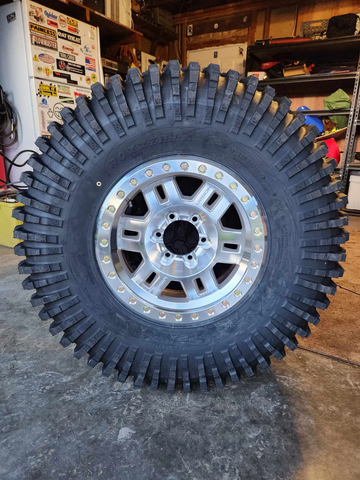

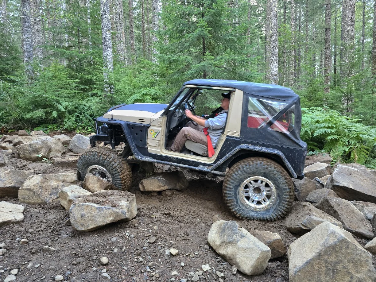

I'm running a 37x10.00r17 Maxxis Roxxzilla sticky designed for a SxS on my Sami... It works great!
