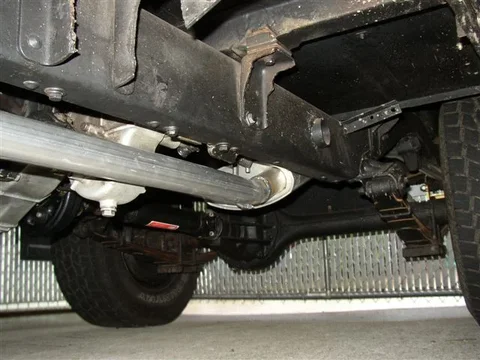

i will probably get razzed for this , but i need some pics of a 350 to walker? crossover set up to the rear. under or over the skid plate? help is appreciated. jim
beautiful! tnx ranger. i am still unclear as to whether he put the pipe above or below the skid plate tho. jim
Could have been up little higher but dont rock crawl. I had to modify the pipe in back to avoid gas fumes , extending and pointing down was the trick 66 007.webp
Here's some pics of what i did: 2" ram horns, walker crossover, Dynomax muffler, parts store 2" pipe to connect it all up.
The pipe is about level with the bottom of the main frame rail, i don't have a skid plate, so not sure if it would clear. If i did i think i'd want the exhaust pipe above the plate, and think it would be do-able.
I was happy with the way it all turned out, you can't see any of the exhaust system, except the tail pipe.
:beer:
one more pic of the rear area
thx everyone. i have saved all the pics and will print them out to take to my local shop. good info! jim
