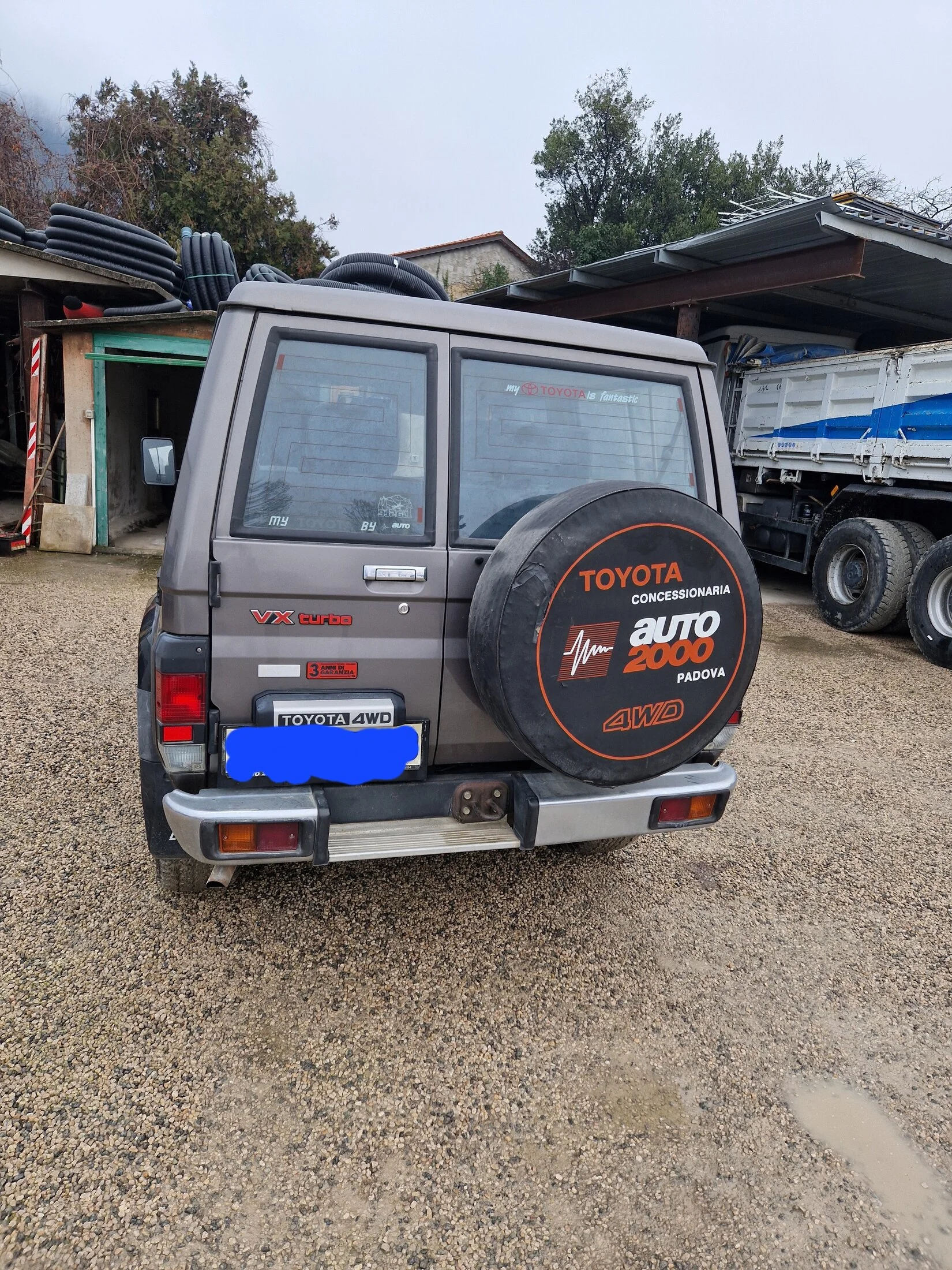

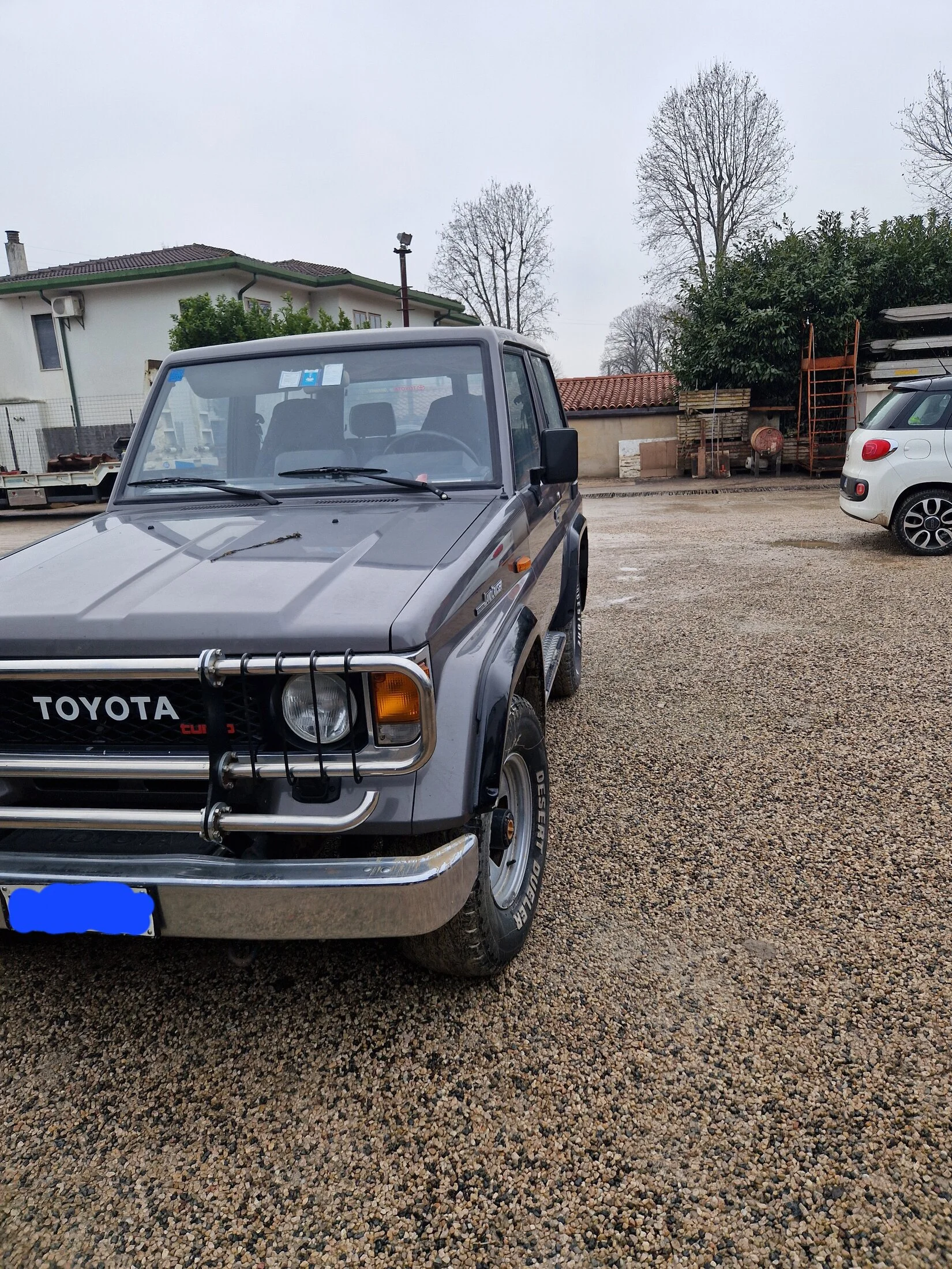

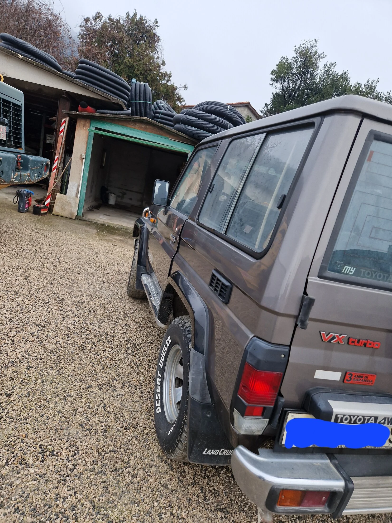

I have read your post about improving your engine and it was very informational. I will try to stick to it with some regulations in my country but hopefully not much difference. Plus its a 3 door so maybe a little bit less weight than yours? How much boost are you running now and is the engine and turbo doing fine? And I think mine doesnt have an EGR so that is a plus. Here are some pictures of it while it is stock but not for much longer hopefully😁

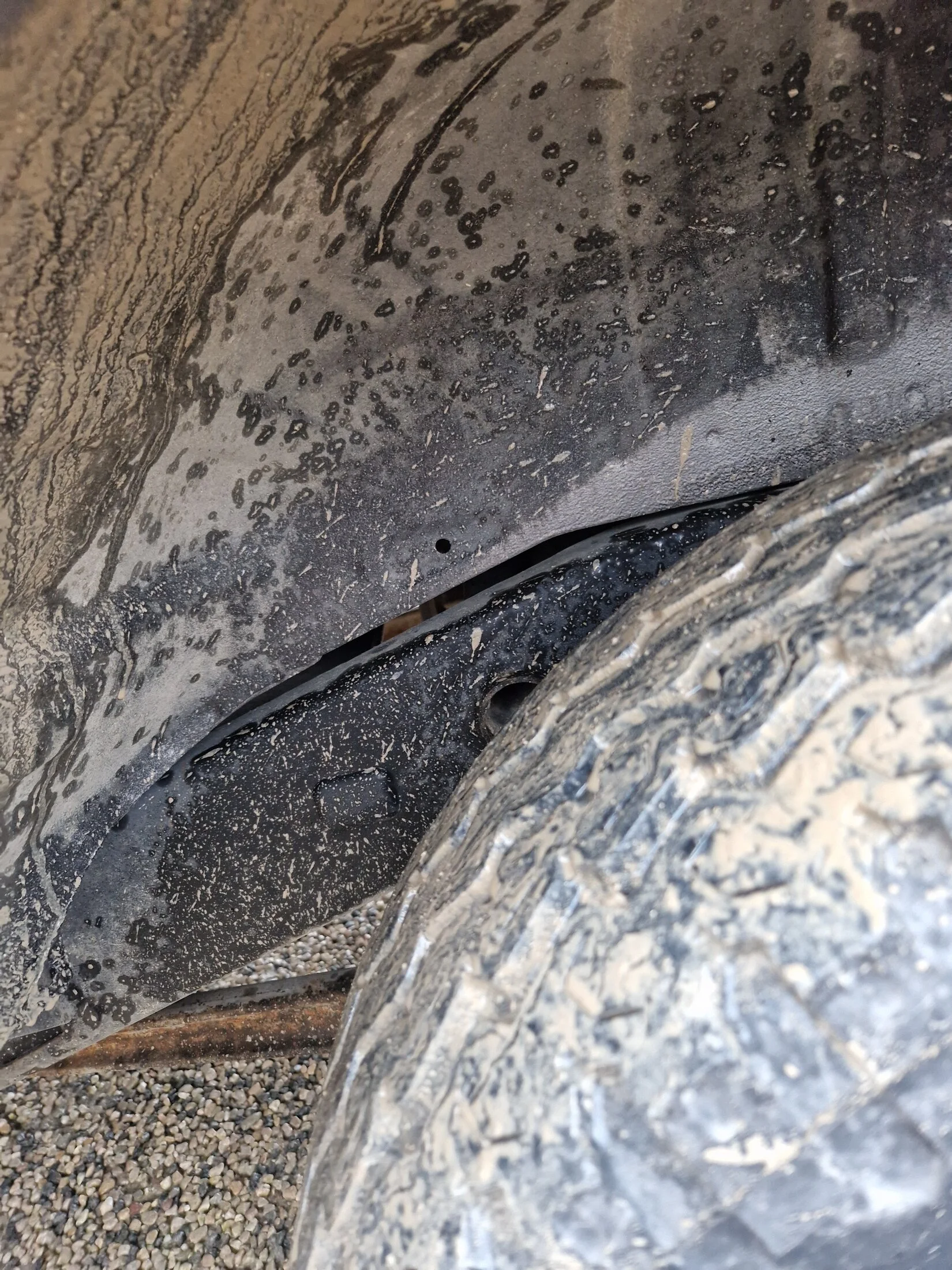

Hi, Im running 35x12,5 tires on my LJ73. My 73 is my summer "fun" car so the fact that its a bit slow doesnt bother me at all. Its not exactly a race car with smaller tires either. My experience is that it sometimes can be a bit pita to get up to 3rd gear from second gear in steep hills, but since Im not in a rush its ok.
My 73 has 2" body-lift and 2" OME springs, no rubbing at all with 10x15 ET-44 rims and BF Mud 12,5x35 tires.
