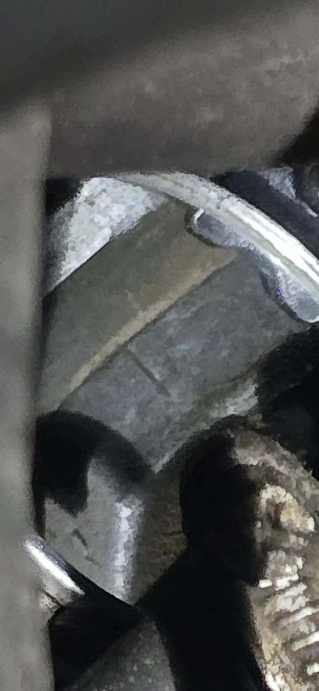

You can immdiately check the alignment marks on the side of the pump. You can also try moving the pump as per the service manual to retard the timing a bit and see of that helps.
As part of the procedure you will need to disable the cold start device (ACSD) so you can already try that and see if it helps.

Unfortunately the tool for timing check of the pump did not arrive until weekend so this will be checked later.
But I found the marks were not aligned. It was quite difficult do loosen the nut by the engine, and then quite a hassle to rotate the pump. Took me a while but I managed to align it on marks. I did not drive it so I don t know if performance is somehow better or worse.
After assembly of the remaining parts, I tested it to see, if the tapping sound will change. It is still there, but I think it is not as intensive as before.
