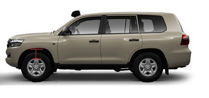

Where are you measuring from? I just installed the TJM XGS suspension and want to know how much higher I am sitting. I forgot to measure beforehand
Top of the rim to bottom of wheel arch:
I am on 285/70/17 duratracs and measure 32.5" from bottom wheel lip through center to top of fender lip on on driver front and right and passenger front. Passenger rear I am 32" . Taller spring on passenger side . HD springs on front. Very happy so far.
