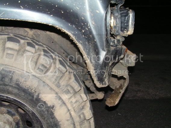

The rear tire actualy clears the intire fender well inside and out when stuff to the bump stop. Front tire doesnt even come close to the springs unless u consider a inch to go at full stuff on the bumpstops close. The inner lip on front fender where it rolls down and forward is where i had the only rub issue
Heres a close up not floexed of the rear
and in this pic its the front fender . the lowest point of the feders inner fender linein had to be smacked a couple times and waaa laa no rubbin . No lift . just bolt them on and wheel the balls out of it
only reason i think it dont rub is i have the magical backspaceing needed to clear the 34s. Also remember they are 10.50s not 12.50s.

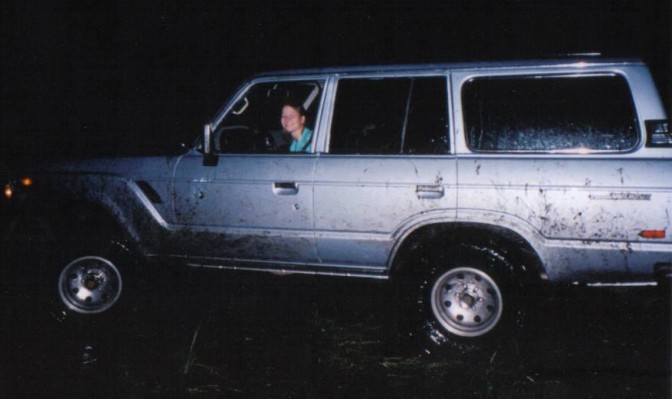

here's a pic of my fj62 on 33X12.50s back when, w/o lift.
Sorry for the poor quality...that's my wife back when driving it through a swamp in Polk County. The rear rubbed once due to having 13 people in the cabin!
