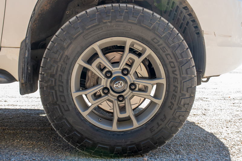

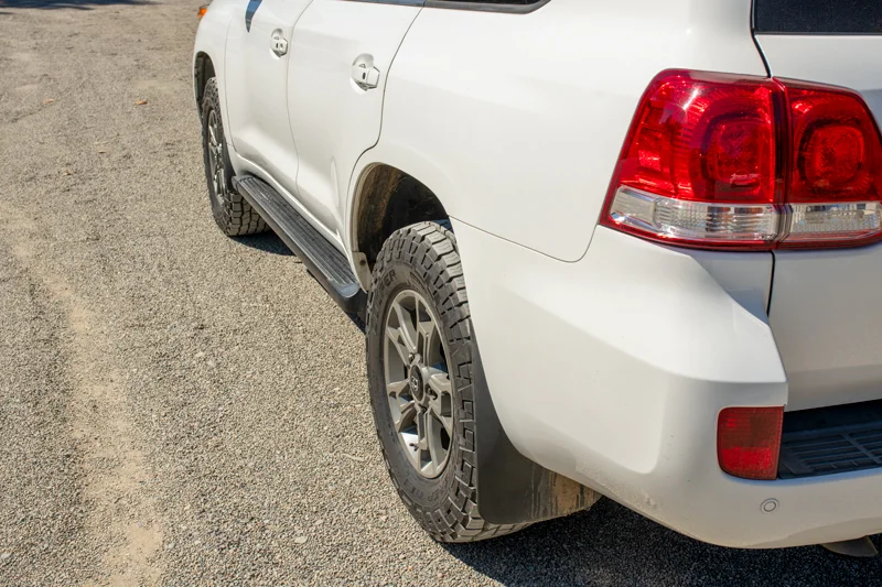

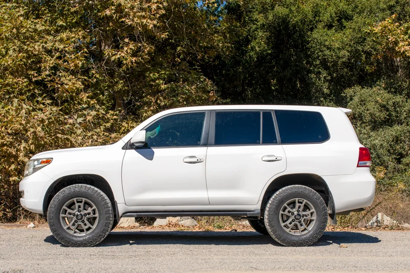

OP, don’t know if it helps but I’m on 275/70R18s (33.2) and am located in San Diego. Would be happy to show you what’s what.

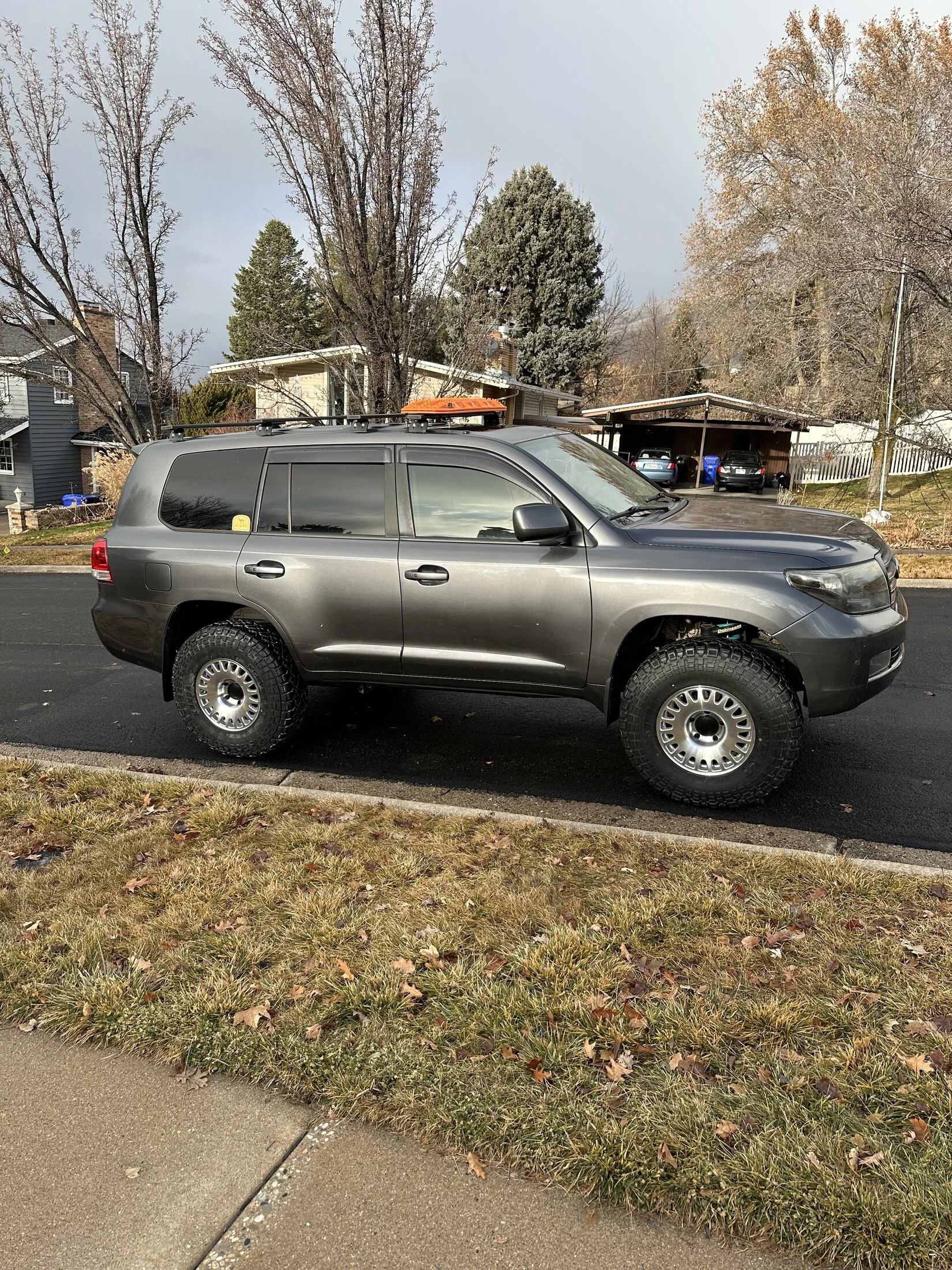

I just went this route 35x10.5r17 it’s a tall skinny 34 inch tire when measured. 0 offset wheels and some trimming along with alignment
Got the same setup on my 2018. Located in 4S Ranch area if you want to look as well.
Could you snap some photos for us all? Looking at this size too. What offset wheel are you running? Thanks! Happy new year! 🍻
Here ya go. @dudemancool1904 and I are running the same wheel/tire combo, but I have 1” spacers
I’m also on the Bilstein 1.75”-ish lift
