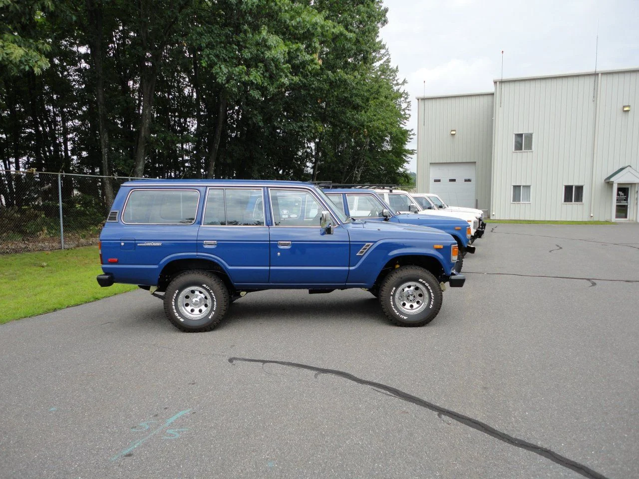

Is anyone running this configuration, stock rims with no lift? If so I'd love to see some pics please. I'm thinking this is what I'd like to run..if it'd look good and fit ok.

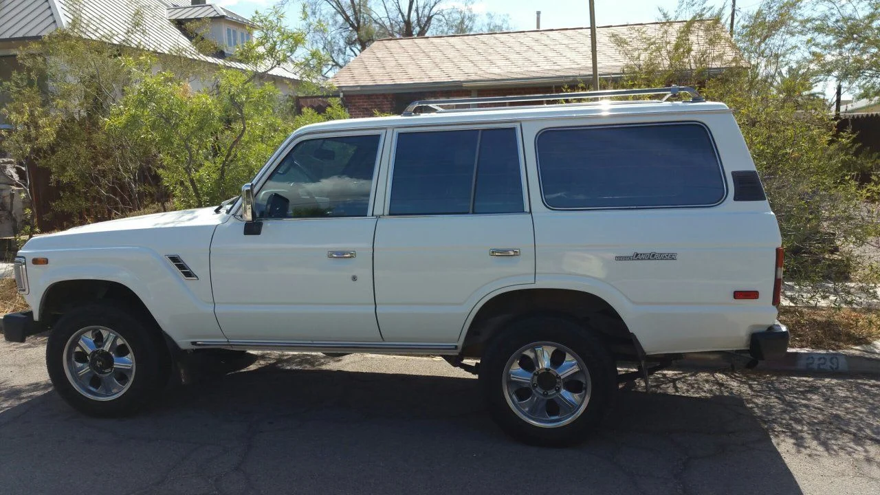

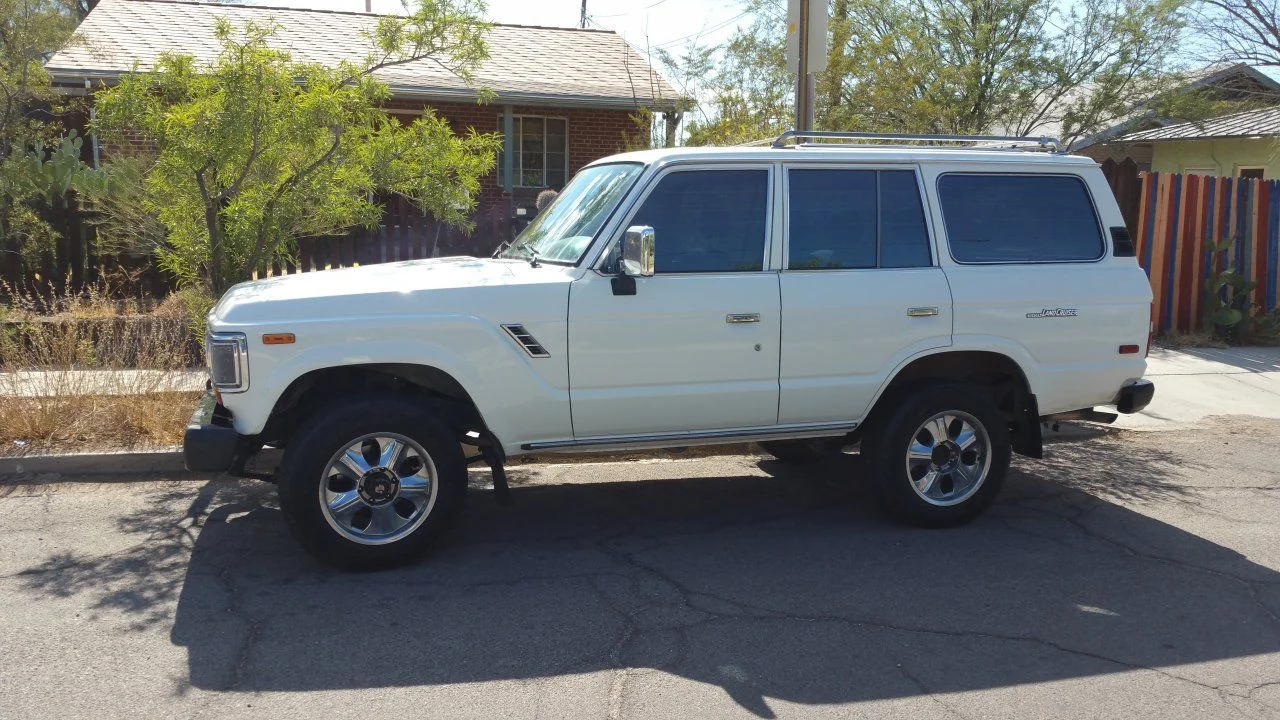

Awesome this are the only pictures I have so far. The first thing I'm going to do when I get under there is find out exactly the specs of the suspension. I'm almost certain I want to put the 32x11.5r15 KO on it with the 15x8's 2.5bs rims. I think they will fit well now, and work well enough without changing the gearing. They should look okay when I add a leaf as well. Would you say that's accurate? Those are 235/70 r17 Goodyear wranglers in it right now
Yes. I run the 32" BFG's on both Frankie and Lilly. Lilly is an FJ-62 with the stock auto trans and 4.11 gears. She has the OME heavy springs.

So. From what you said. I am guessing this is a light spring pack in front, and medium in back? Idk, what do you think. You think this will be sufficient for running my 32x11.5? I can post pictures of shackles if you want.
