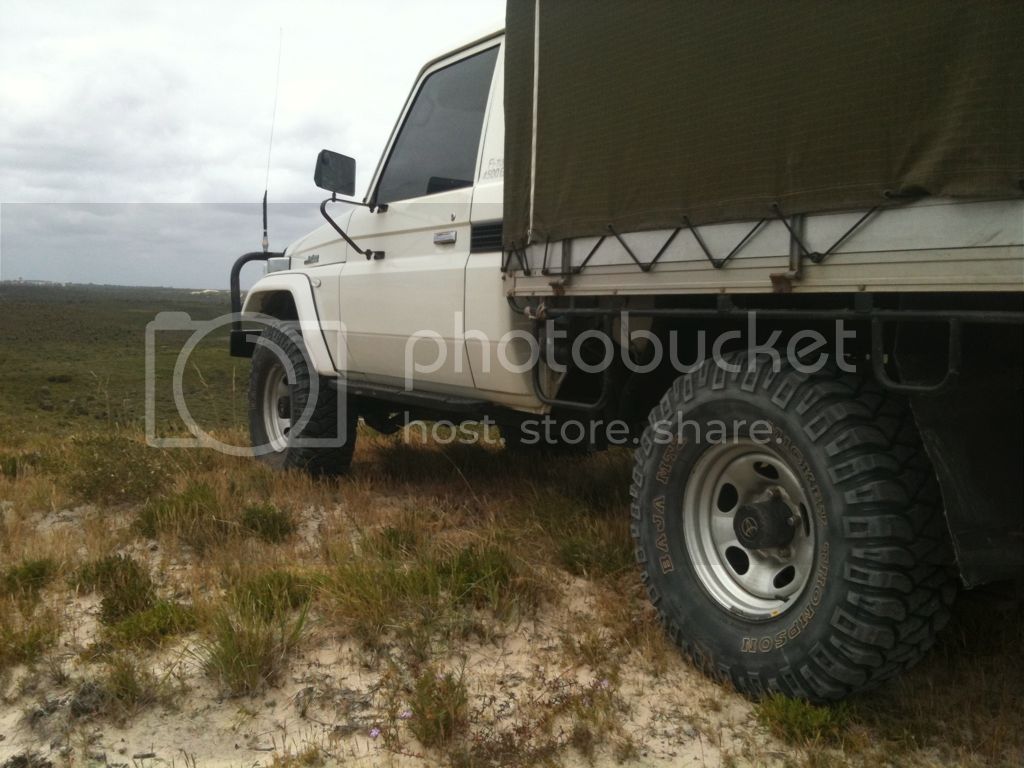

this is in a fzj71 here in venezuela with the pro-comp wheels
These are the toyota 16x8 105 series rims with 315-75 r16
nice truck, do you drive it with stock gearing? if its not, is it oki to drive the car stock with this tire size? thank you
Yes I drove it for a while with stock motor and gears. The std gear ratio in the hzj and fzj 79 4.3 ratio
The v6 has more power than the 1fz it will be fine.
