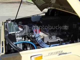

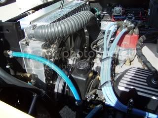

A thread isn't any fun without pictures. This is a FJ40 from the Bakersfield area. The guy did a beautiful job on the conversion. Don't ask me any questions on adapters I was just impressed with the level of workmanship.
