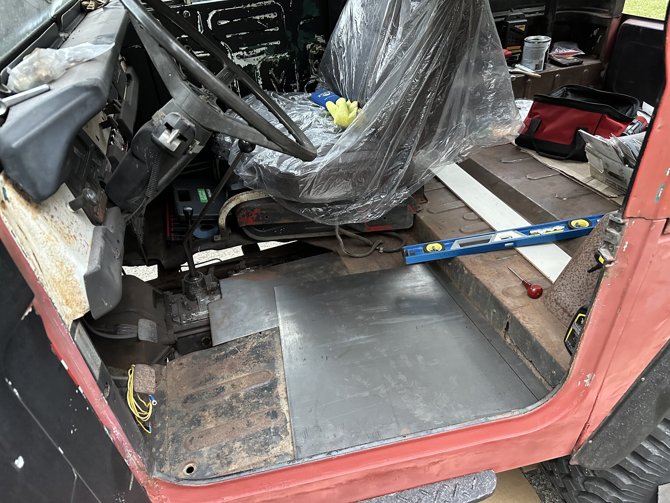

My 1971, 40 series has a 3speed. The transmission and transfer case shifters are on the floor. The truck was incomplete when I purchased it.
Among other things, I am missing the Transmission hump AND a section of the driver side floor pan under the seat or where the tool box would have been. A previous owner cut out the floor all the way to the trans-hump cutout so I’d like to get a hump and have it on hand in order to create the floor.
MY QUESTIONS : in my hunt for a trans hump can I use either a 3 speed or 4 speed hump cover? DOES IT MATTER?
ARE THE FLOOR CONTOURS AND BOLT HOLES THE SAME for the 3 speed and 4 speed hump?
the truck has a body lift so clearance or hump height is a non issue.

It looks to me like you have a '73 and later torque tube. It's the cylindrical cross member that goes above the rear drive shaft. Is it possible a PO changed out the tube , or even the whole frame? I would check the tube for butt welds inside the frame rails. If no butt welds, I'd look at the frame no. on the outside of the right front frame rail, just behind the bumper stays.
The pre '73 hump fit up to a "bump" in the tub, much different than later humps. I don't see that bump in you pic, but maybe the hump is long gone with the rest of the floor
The bolt pattern for my '73 three speed hump was identical to the four speed hump, but note that there were revisions in the 73 model that were in preparation for upgrading to the four speed.
The fiberglass hump from SOR has indentations in the flange that line up with their gasket pieces; but the fiberglass part isn't as perfect as the OEM steel stamping, so some of the holes in the hump may not line up perfectly and may need to be egged out.

this theory makes sense and these types of clues/ confusion have thrown me off in a few different area's now. Will check frame and report back.
Im beginning to think someone had a title and tags for a 71 so thus the current title and tags on the fender and door jam but everything seems 73.
the floor is intact at the rear of the trans hump cut out so I'm pretty sure the 4 speed style hump is what I need.
