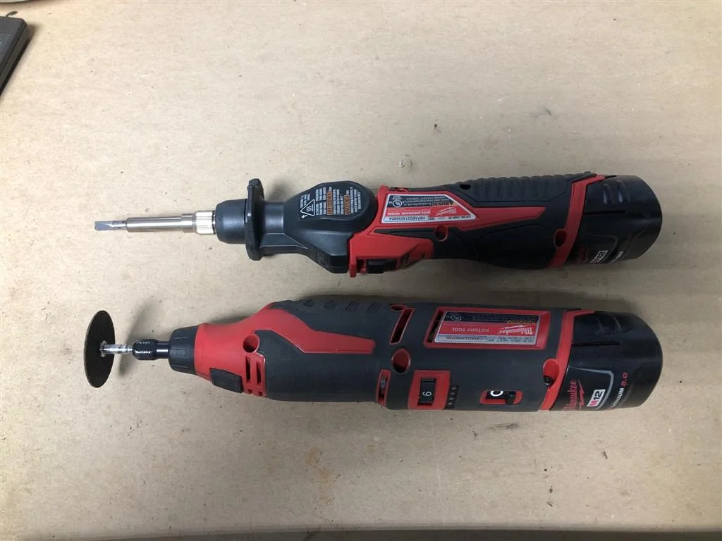

Not sure if it's "the" one but I like my 2457-20 (bottom) and use it all the time. Also have a 2564-20 3/8 impact ratchet. Got it for cheap at a swap meet and haven't used much but nice if you need to really tighten or break loose a fastener in tight quarters. I think some of the different part numbers have to do with head lengths but might also just be later models. I like these enough that I'm keeping my eye open for a deal on an extended 1/4" ratchet.

I ended up with the 2557-20 3/8" Fuel ratchet. Similar to what @Waorani posted above but not as compact. The business end of the 2557 is a little beefy. It's nice though, I dig it.
