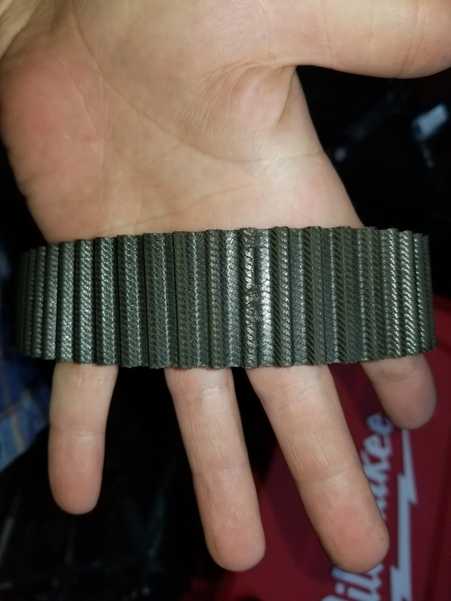

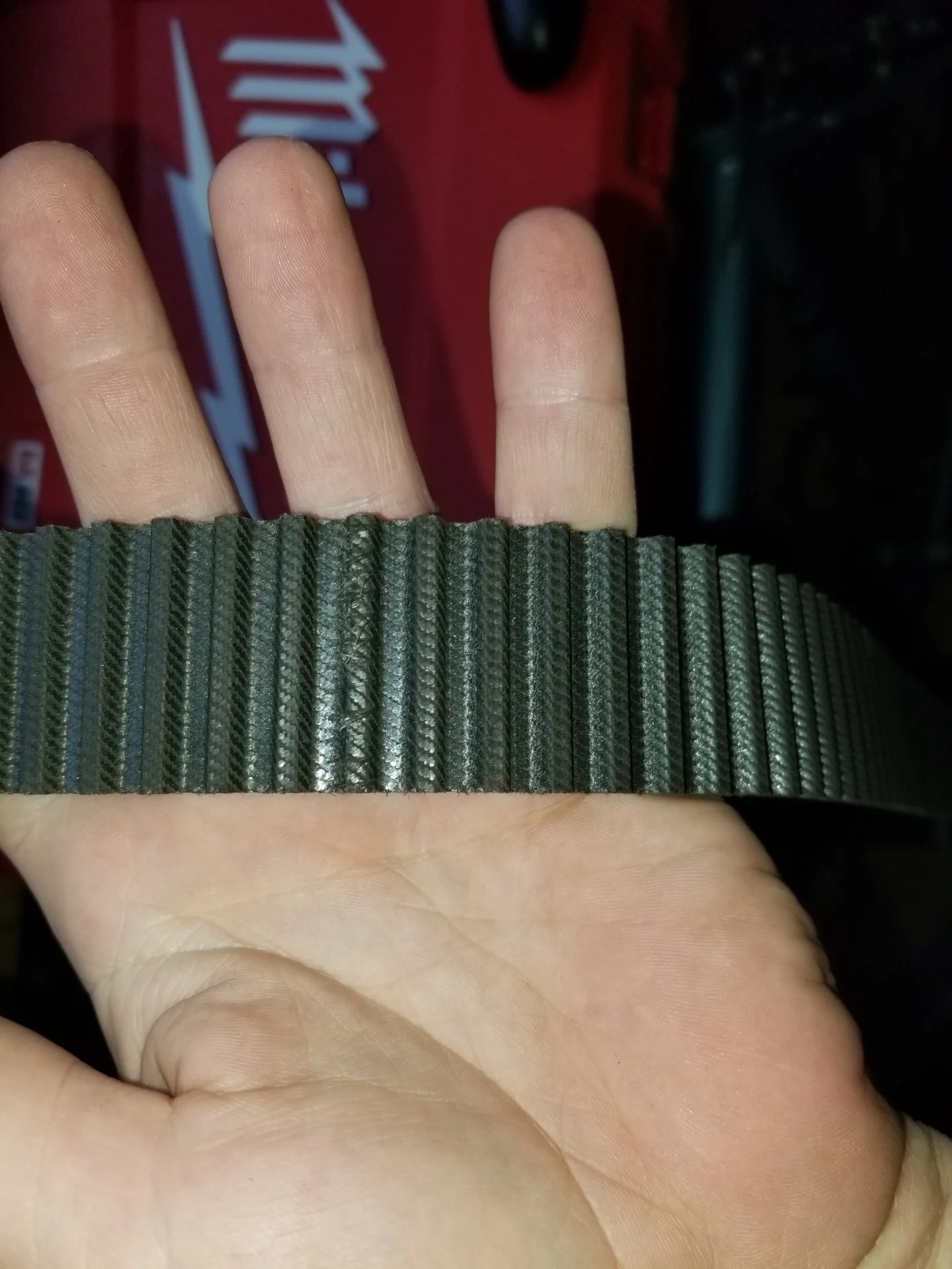

I helped a buddy change the original timing belt in his 2002 Tundra a couple of weeks ago, and found the old belt laying in my shop still today. Based on the inspection of this belt, despite it only being 30% over the mileage limit, it was NOT in good shape. There were a couple of places where the fibers were starting to rip in the belt. It was also pretty loose before we removed it, and the engine ran noticeable better after the new Aisin kit went on. I attribute this to sloppy/wandering cam timing due to a loose belt.
Interestingly enough, I had gone with him to look at this truck at the dealer. We brought up the fact of it needing a belt and the dealer was insistent that he had had these go to 170K on his personal 2UZ's. After looking at this belt, I'm not sure it had much more life in it at all. A few high-revving events might have further deteriorated it and caused it to break.
So...the moral of the story is...despite low mileage, please change your timing belts! Age seemingly affects them just as much.

The biggest thing for me was how much the belt and stretched and how much better the Tundra ran after it was replaced. It was loose! Any rubber that is under constant tension for 20 years is going to creep and stretch. This probably also put it at risk for skipping a tooth.
