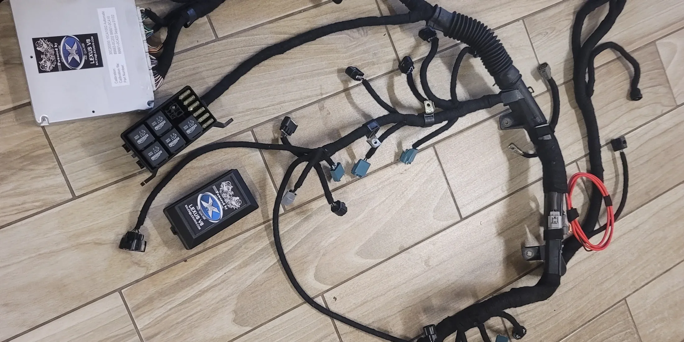

I recently picked up a 2002 Tundra drivetrain to swap into my offroad buggy.
Engine, tranny, transfer case all connected. Harness on the engine and ECM to go with it.
Wondering if anyone can help me with finding a company that makes a stand alone harness to put onto my chassis?
When I plug in the ECM it appears I'm missing 2 plugs. Possibly from the main harness?
I'll attach a pic for reference.
qdExQjk
Those go to the chassis/dash harness. Get a pin out diagram from the FSM and you'll know where everything goes.
i wired my own , in the 55 some time ago . there are 2 shops that do 3.4 swap harness .ORS , and Toy only swaps . i have not seen anyone advertise a 4.7 harness . . i was waiting to see if anyone else had some good leads . we do quite a bit here in utah , tons of 3.4 swaps , some old 1uz harness ,and twin turbo 2jzgte , in 4runners . the only 4.7 we have is not close to wiring time ..

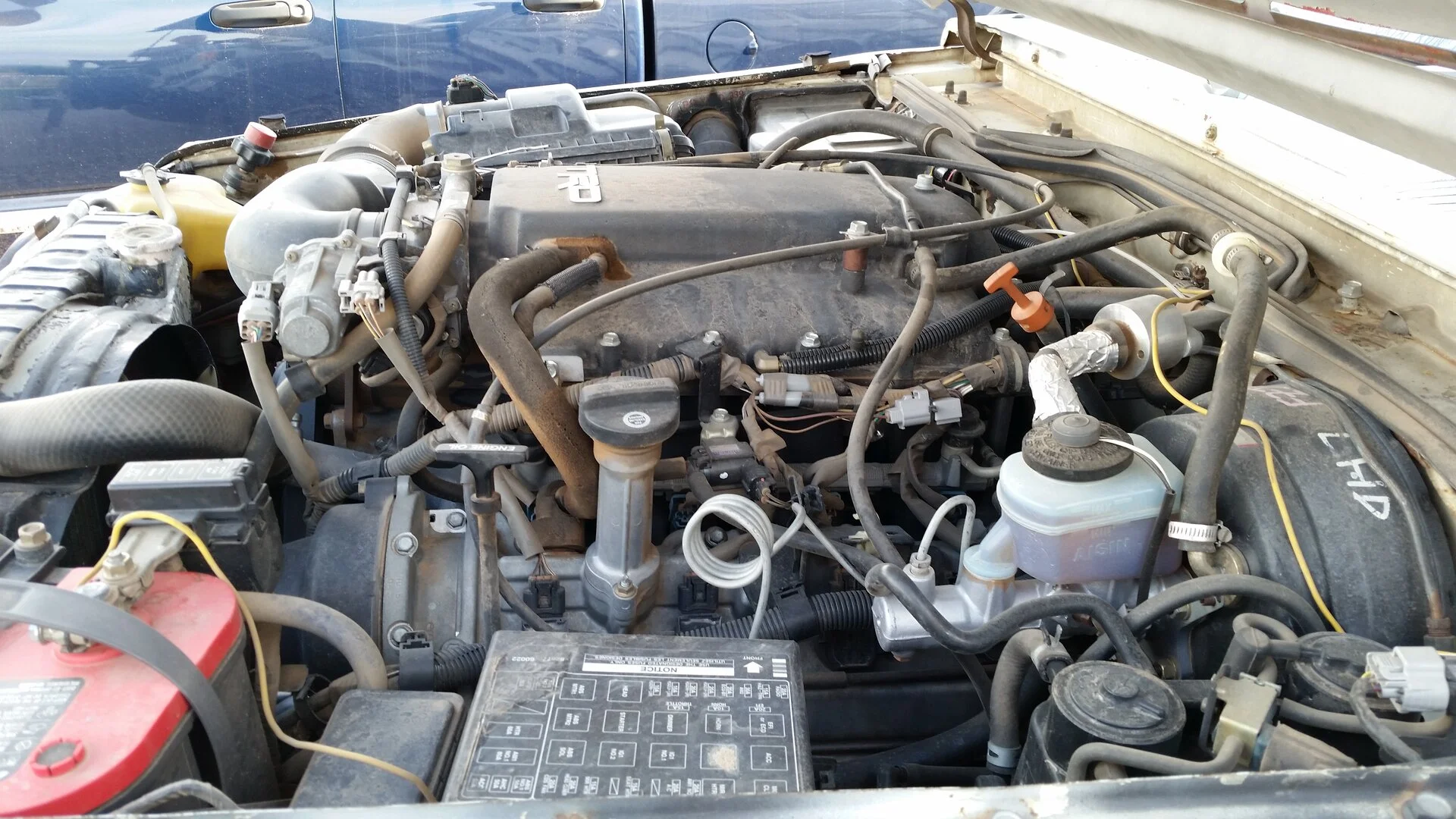

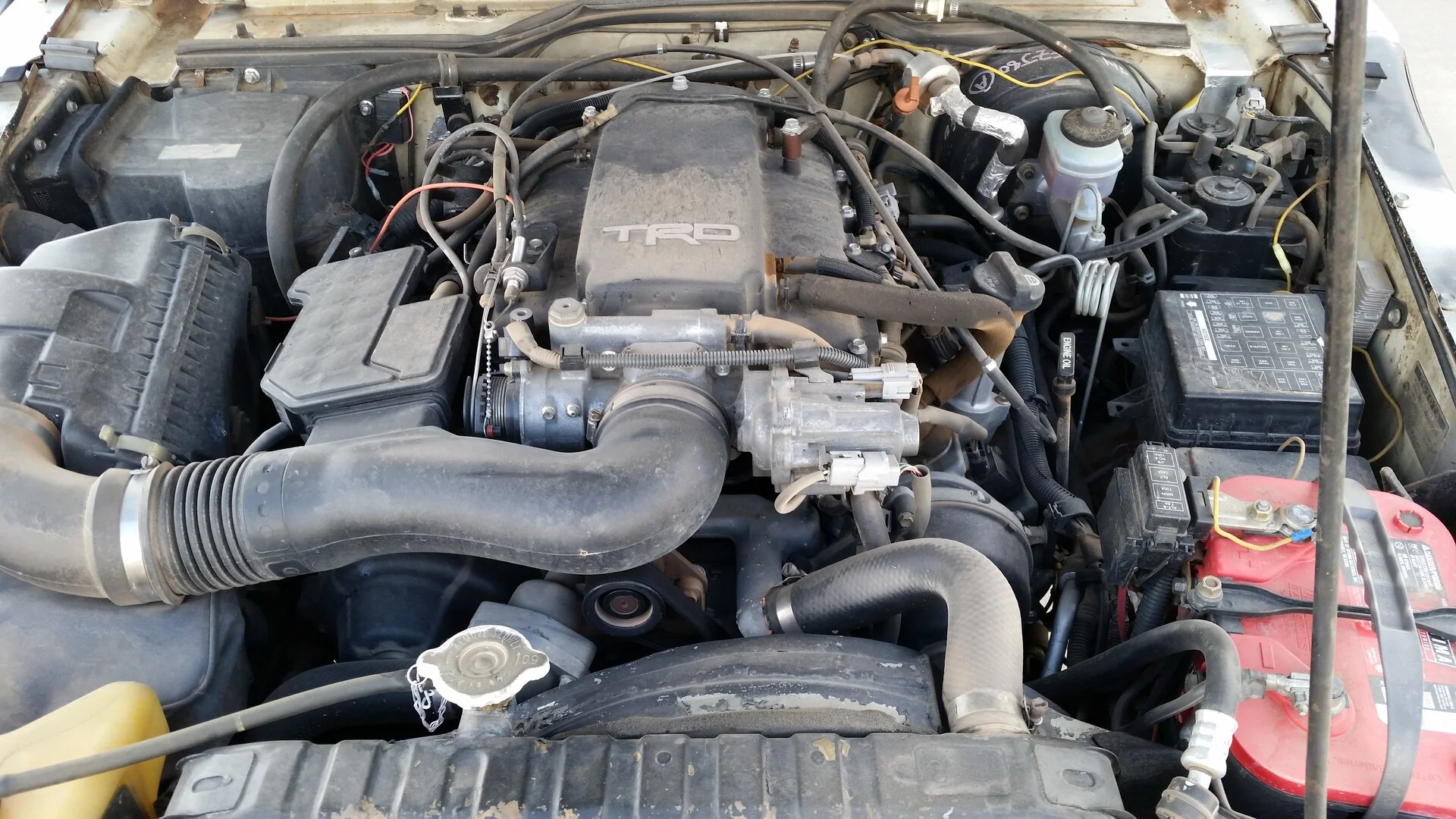

Did you post any pics of your build anywhere?
If not can you post a few of your engine bay?
Thx
ok this will be in several parts , most of my cool pics of the build up are locked on birfield.com . but i will try to pull as many off my defunct hard drive as i can when i get off work .
Pigs name is fj55-100 as the merger of the 2 rigs suggests . also by the surname zebra pig (my kids) that eyesore (my boss) and sister wife 2 (now that i live in utah).
Paint color is artic camo put on by Robert that used to work for spector off road ,that i purchased the pig from in a attempt to fit all the camping gear needed for a weeks time in the desert for the family .my fj40 was way 2 small .
concept was formed in 97 looking at the new toyota v8 prototype thinking how cool it would be to ditch the 350 chev and build a waggon using all toyota parts .
build started in 2001 , where i gutted the pig . and inserted a lexus 4.7 v8 engine / transmission transfer case . the computer chosen to drive it was a pcm from a 2002 4x4 tundra to aviod having a key with a chip. the harness was hand built with only the nessary equipment . the trans tunnel was moved up so that there would be nothing that would hang down below the frame rails . all new floor was formed . all mounts custom made by me . with the drive train in place the stock radiator was remounted . rear heater was removed as the hump in the floor was large .
