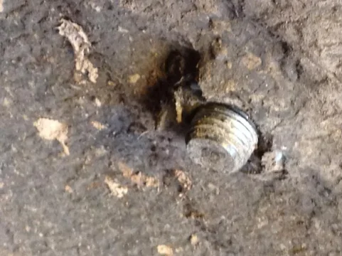

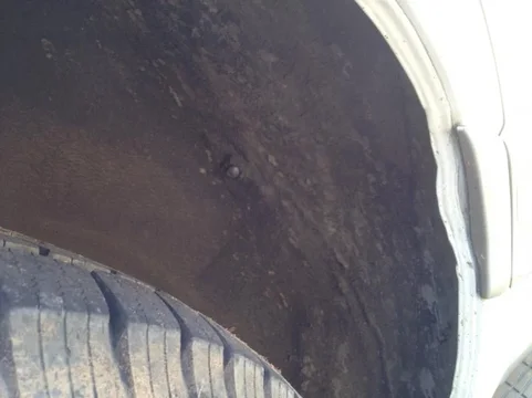

My 2nd row (passenger side seat)(40% side ) vibrates sometimes... bugs the crap out of me. My 80 with 35's never had this type of vibration. The tires are newer stock Michelin's with about 15k on them. As near as I can tell no prior wrecks....I purchased this Cruiser around a year ago with 45k miles.
I can also see a nut...with a bit of thread sticking out in both rear wheel wells. I have been checking out other local 06/07's and all of them are the same. Could this cause the vibration?
If I fold the seat back down the vibration goes away. Also if somebody is sitting there are no vibes.

Pics of wheel well.
