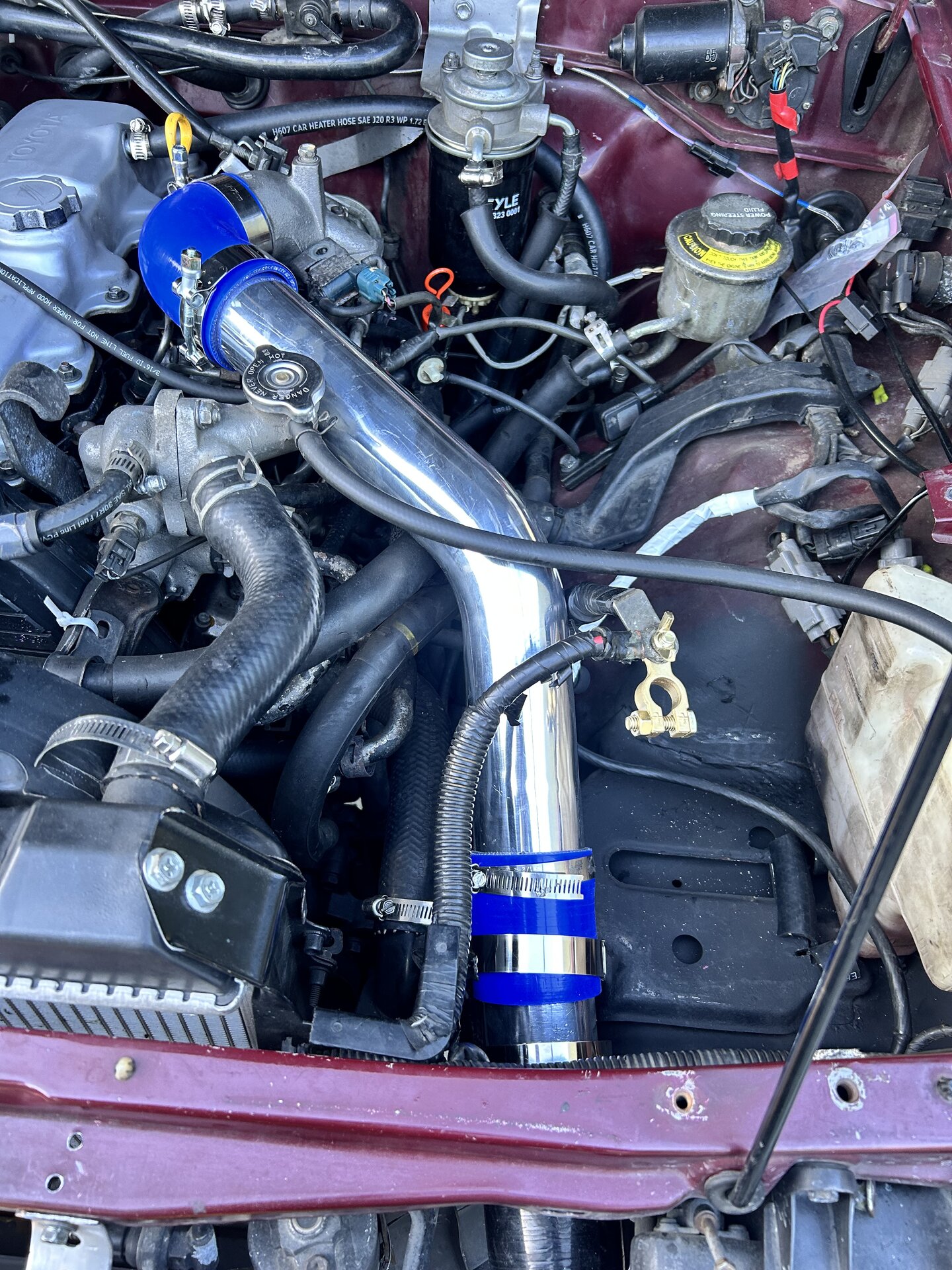

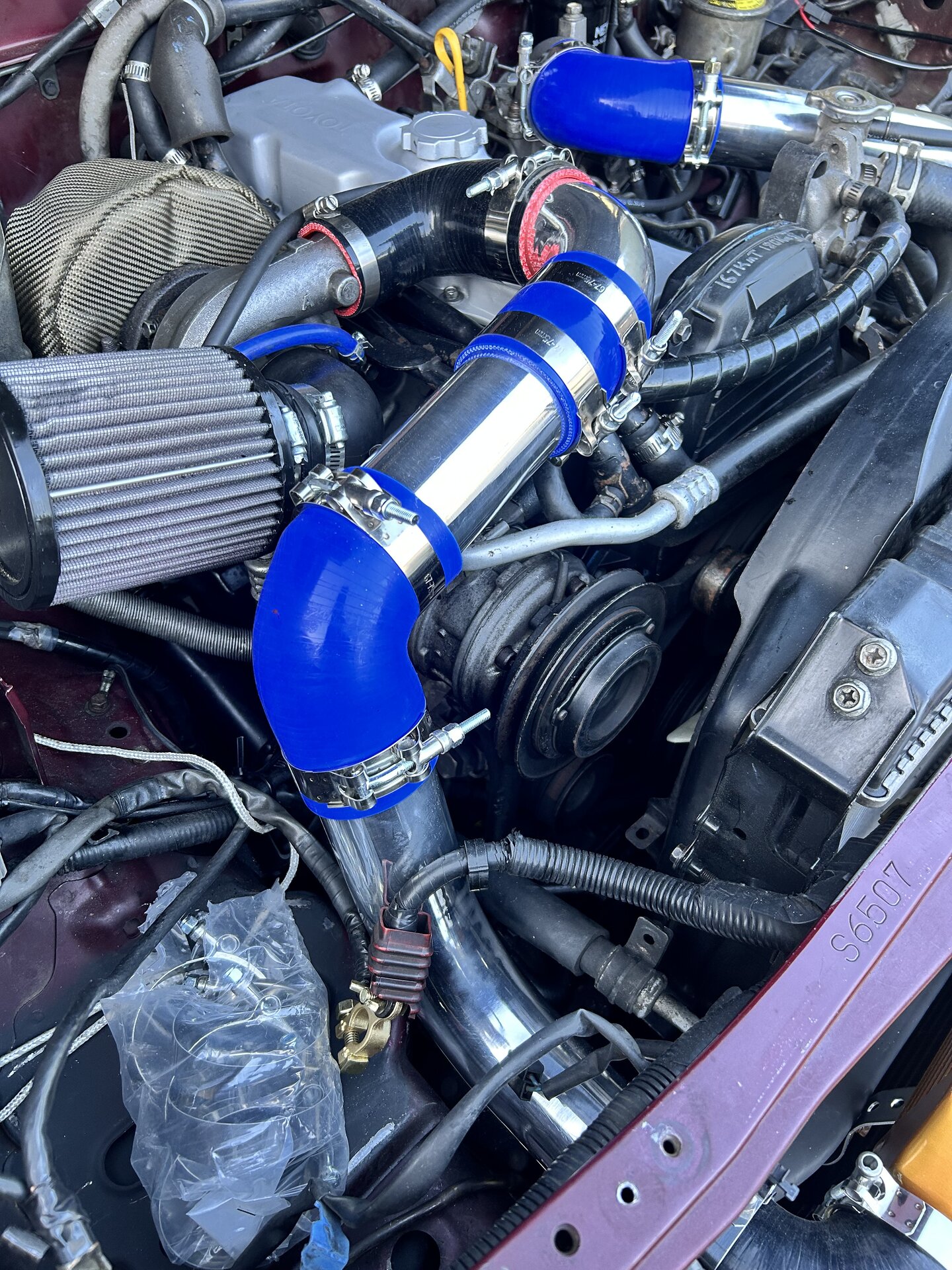

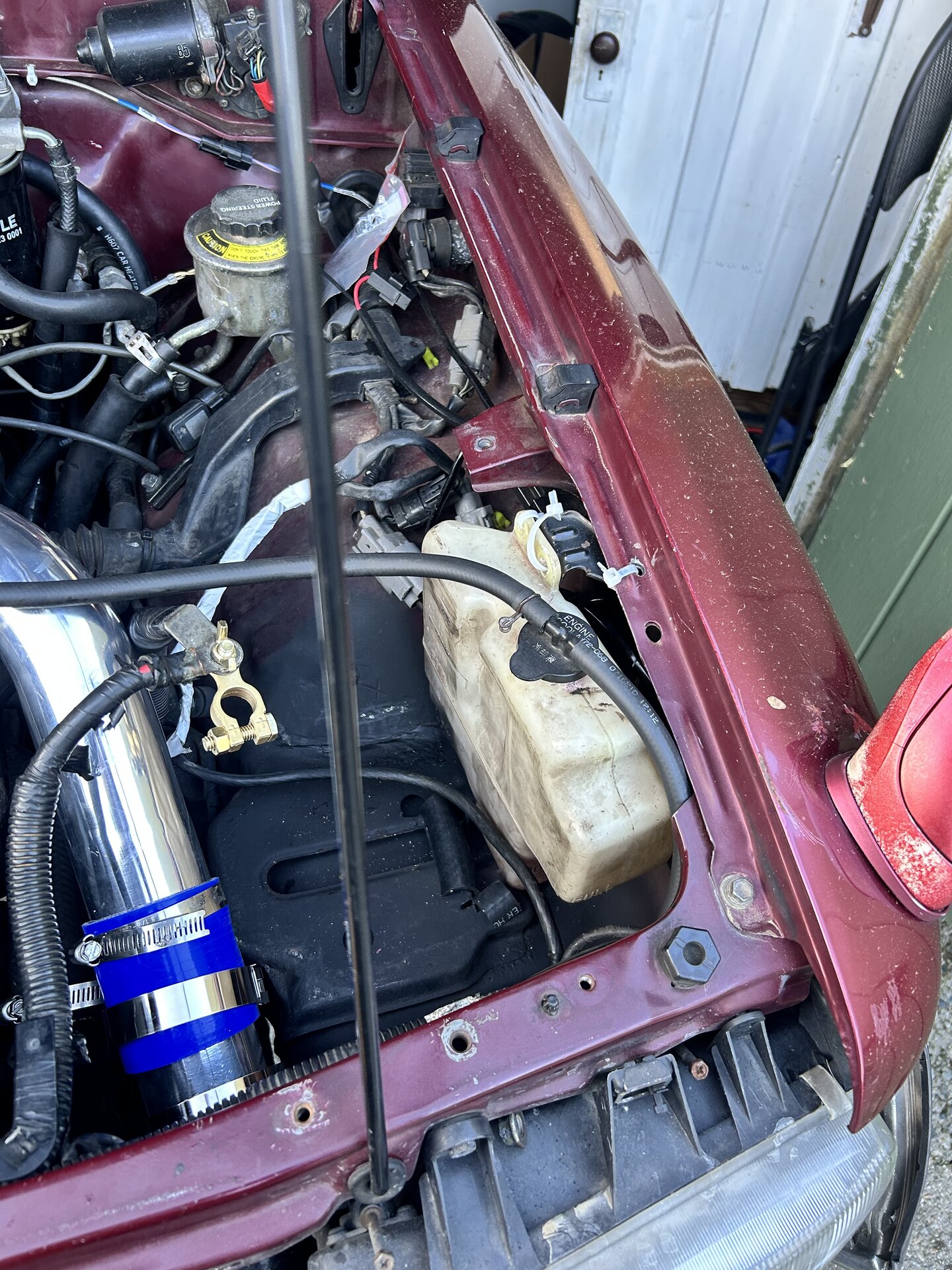

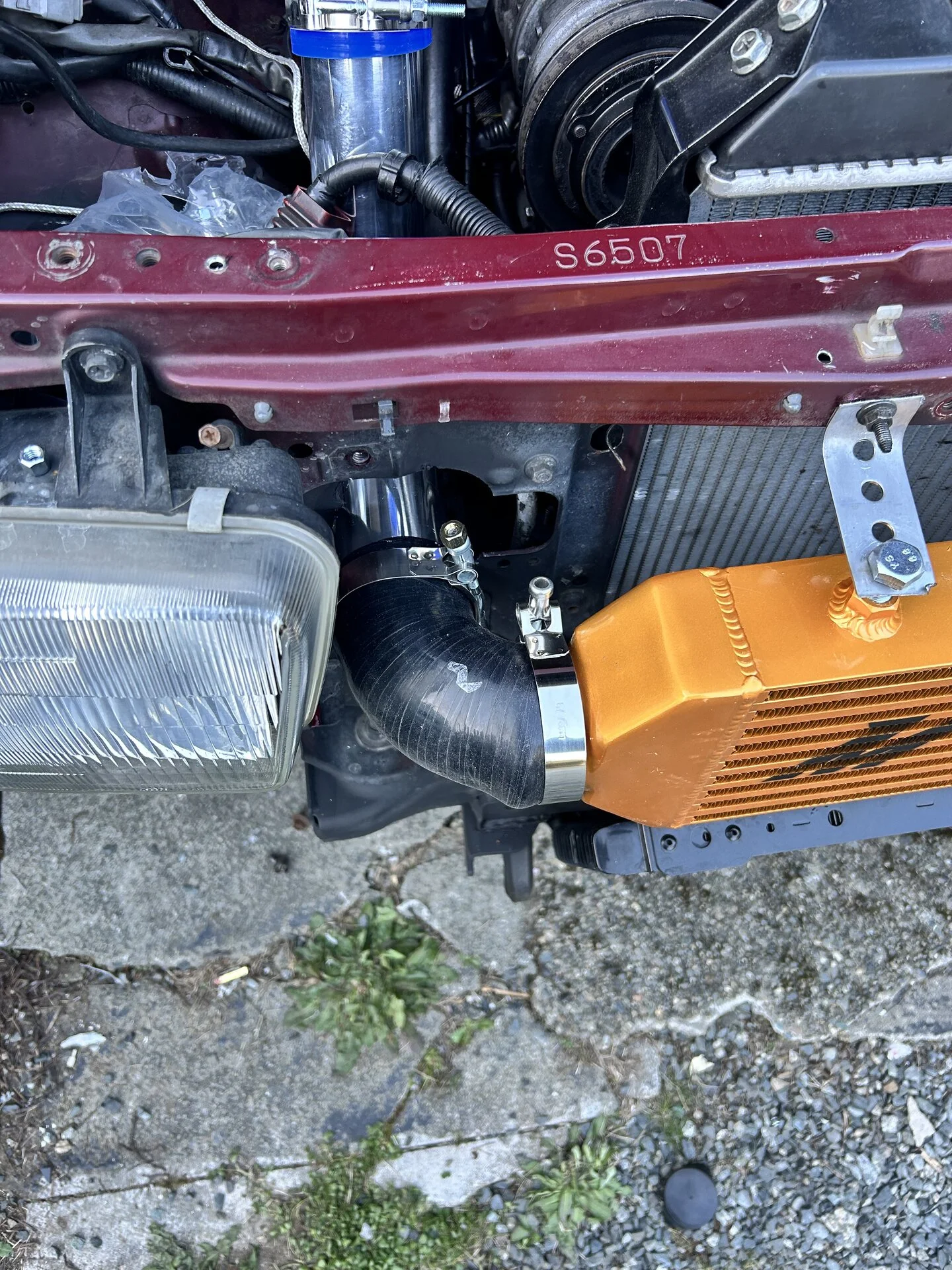

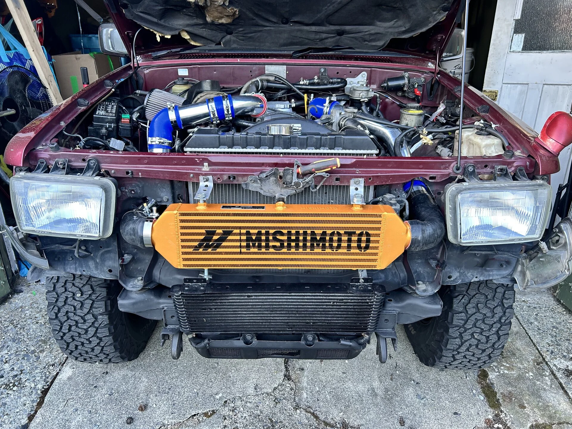

Hey guys I just wanted to add some photos and if anyone’s thinking about doing an intercooler to a 91 Toyota surf might help. Had to move a lot of stuff around to make it work. ( kept the ac because the gf said she woudnt get in this summer if it didn’t)
