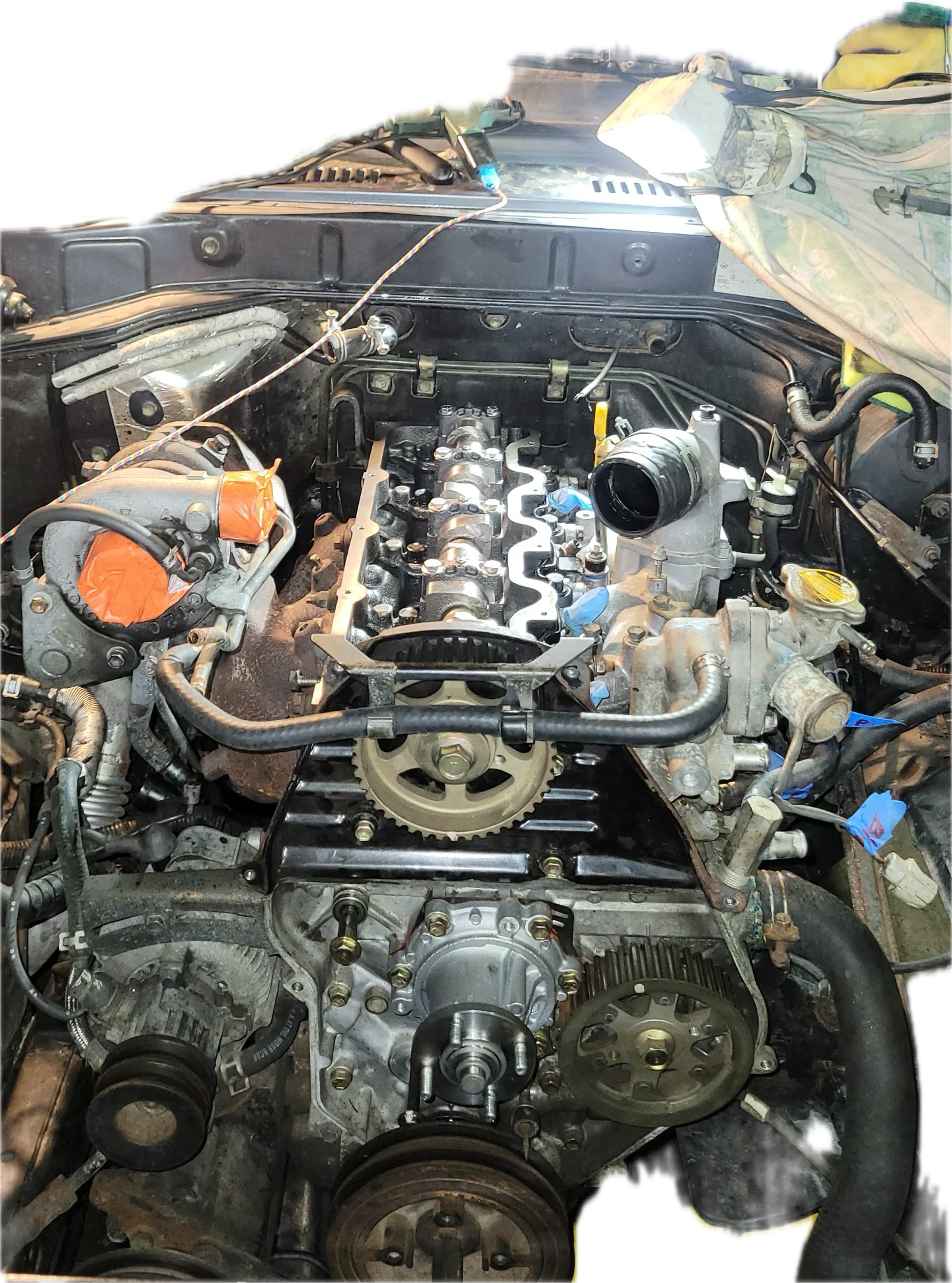

Hey guys. So after pulling the head, my lj70 needs a new head. Here is my thoughts
Complete restore of the engine
Replacement engine
Sell
I want to restore the engine but I'm having a hard time finding a head.
Good engine options but I'm scared for the electrical and how it should be married up to retain the original astatic.
Selling isn't something I want to do but if the shoe fits
Thoughts, comments, concerns?

If the motor ran fine (besides head crack), my recommendation is just replace the head and keep running it.
It's hard to find replacement motors these days. Unless one has documented history, you probably want to count on replacing head anyhow.
Selling as is you'll loose a lot of money. Even a new head on a motor with blow-by would probably reduce your financial losses.
Rebuilding is expensive....and not always a success.
2L and 2LTE (1990+) heads are out of production now. But 3L head is still available and works fine. Partsouq, etc.

Within last 2 years, I successfully (through my new best friend diesel mech) replaced the head on my 2lt -
A 1993 lj70 (delivered new to France, then full frame resto in Poland, then to US via Philly. (Go birds!).
Had 170km on it.
Was able to source all the parts, some (radiator, etc) from here and there, but Northwest Toys LLC was real helpful and sourced/drop shipped the new head. (Contact below)
Runs like a top now, and expect it to go forever (albeit getting there slowly)…
(About to reseal the injection pump, which sprung a drip leak)
I’m in mid Atlantic. Glad to chat. I don’t know much technical talk, but glad to chat on my experience.
Love my lj70

Here is where I would buy a genuine 3L cylinder head from, they are based in Japan: Toyota 11101-54131 (1110154131) HEAD SUB-ASSY, CYLINDER - https://www.amayama.com/en/part/toyota/1110154131
The last guy on here who asked the same question a couple of months ago, even after being told that the 2L-T head was no longer in production, thought he knew better and believed that he was buying an OEM head from a seller in China hiding behind a US business address.
You can get Made in China heads for far cheaper than genuine, but of course you may find yourself back to square one soon after. If you do buy a Chinese head, you probably want to get a machine shop to check the valve seats. I would also put in new genuine valves and use my existing camshaft.
Download the 2L/3L factory service manual, read and understand it before tearing down the engine. Use a genuine gasket kit.
