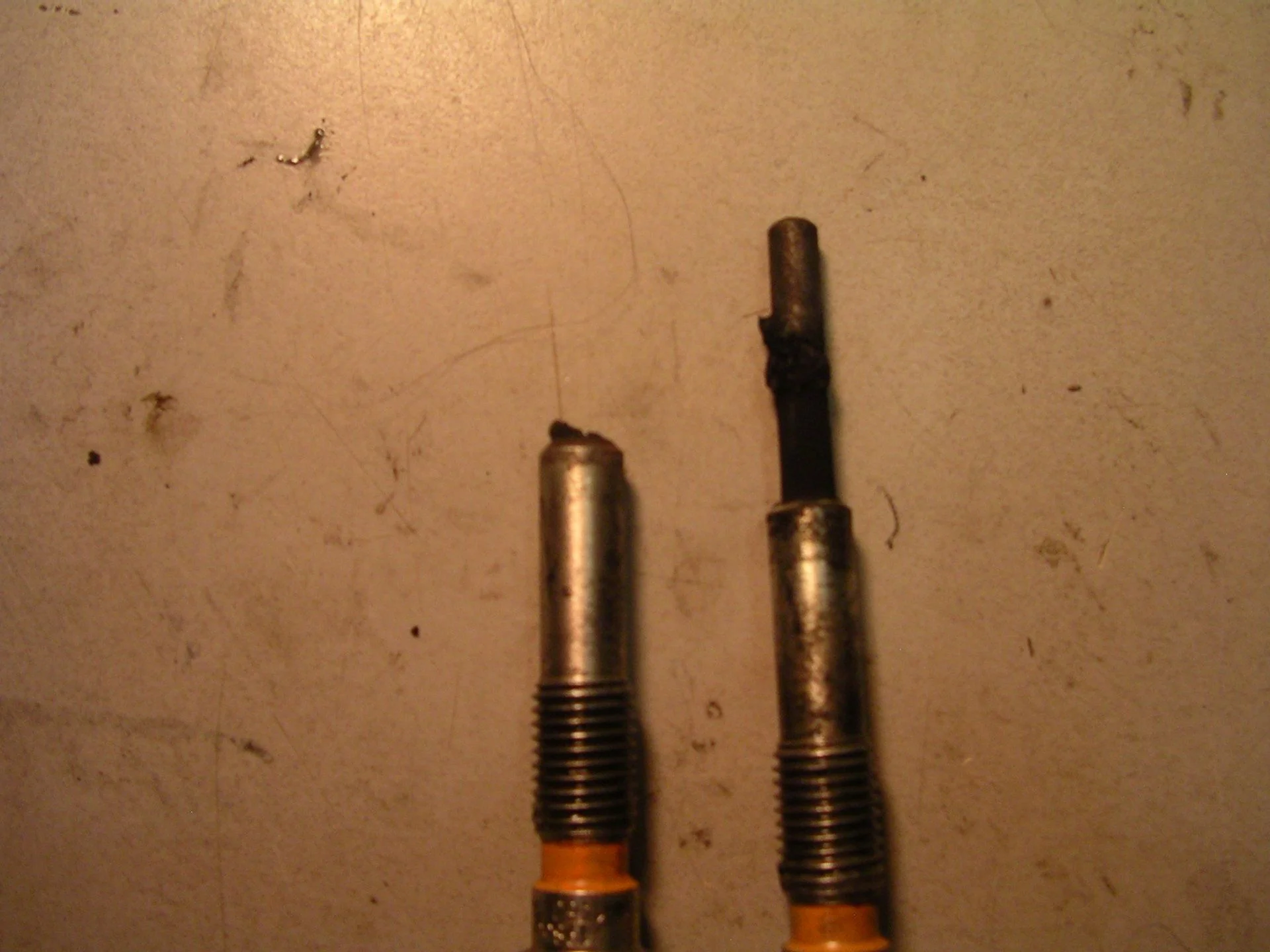

Do you have a picture of the broken glowplug remains, the thread was not damaged when it was forced out?
Because I would like to immediately know/see if it happens to my engine.
The old black soot powder on the plug needs to be removed by turning and pulling the glowplug a few times so that is not possible when it melts, maybe use seafoam stuff first or if diesel was getting out it cleared the soot after some driving?

The glow plug broke at the spot where the electrode connects to the wider metal section, leaving the whole electrode stuck in the hole. I never found the electrode piece after I blew it out- I had a good look for it on the road, but couldn't find it. The threads in the hole were absolutely fine, not damaged at all.
I know what you mean about the carbon/soot build-up and how that can make it hard to get the plugs out, and I've also had to ease them out by turning them back and forth.
The one that broke though, melted right off. Another one had started to melt as well and was a bit deformed, and hard to get out of the hole, but eventually came out. Picture of both the deformed one and the broken one below
