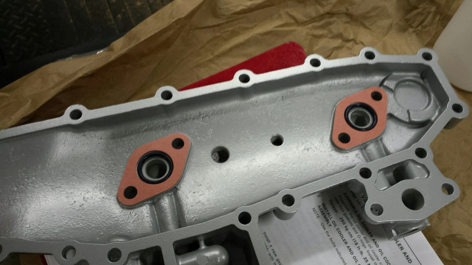

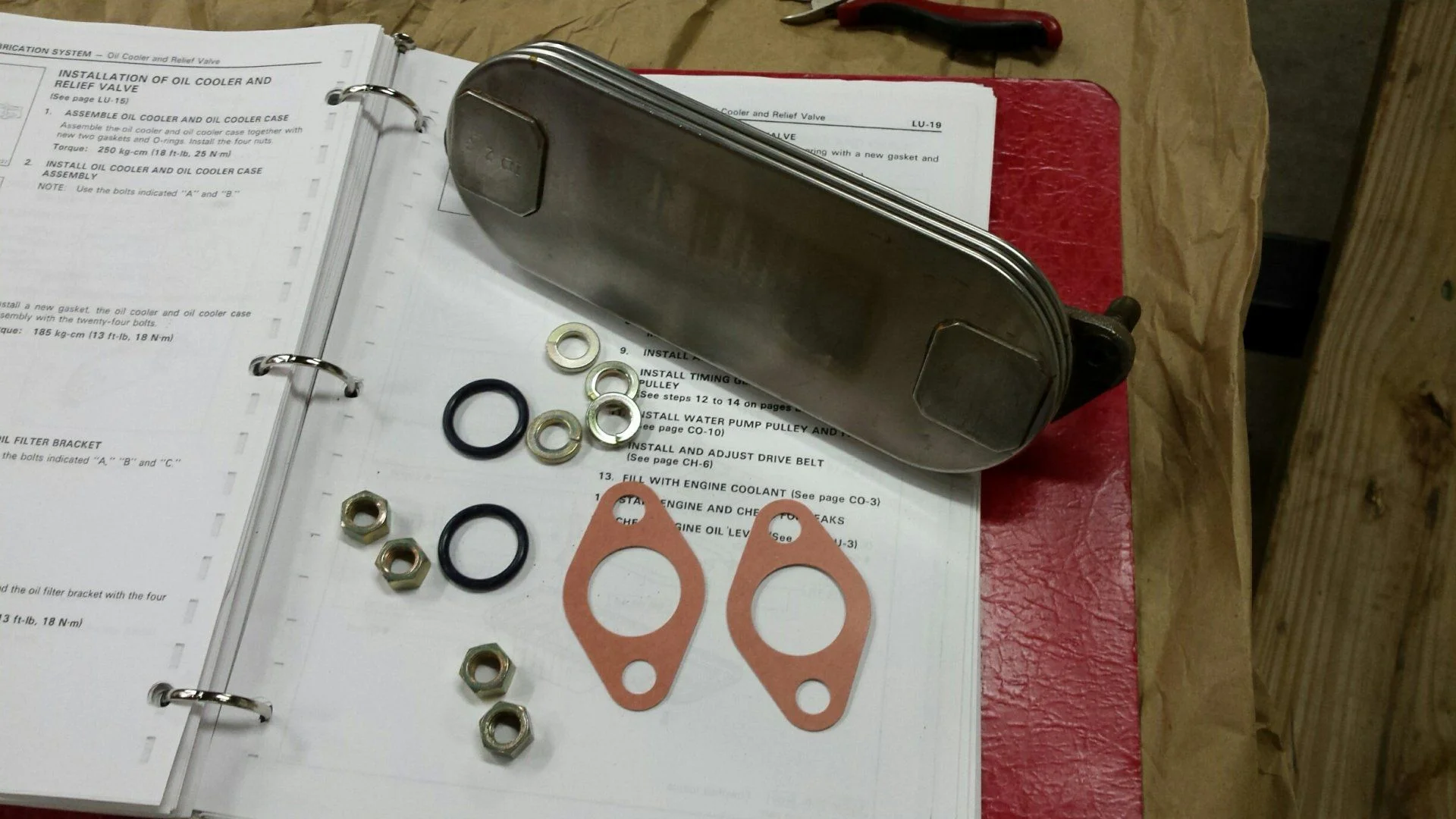

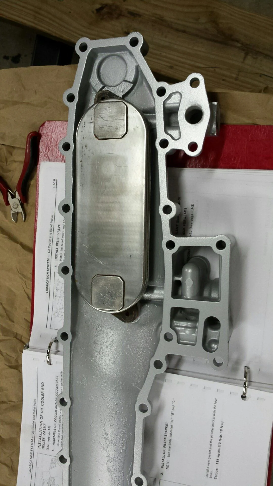

That is the oil cooler housing it actually has coolant circulating in that portion. The oil cooler is inside here.

cool. thanks for those pictures roma- never really knew how the cooler was configured.

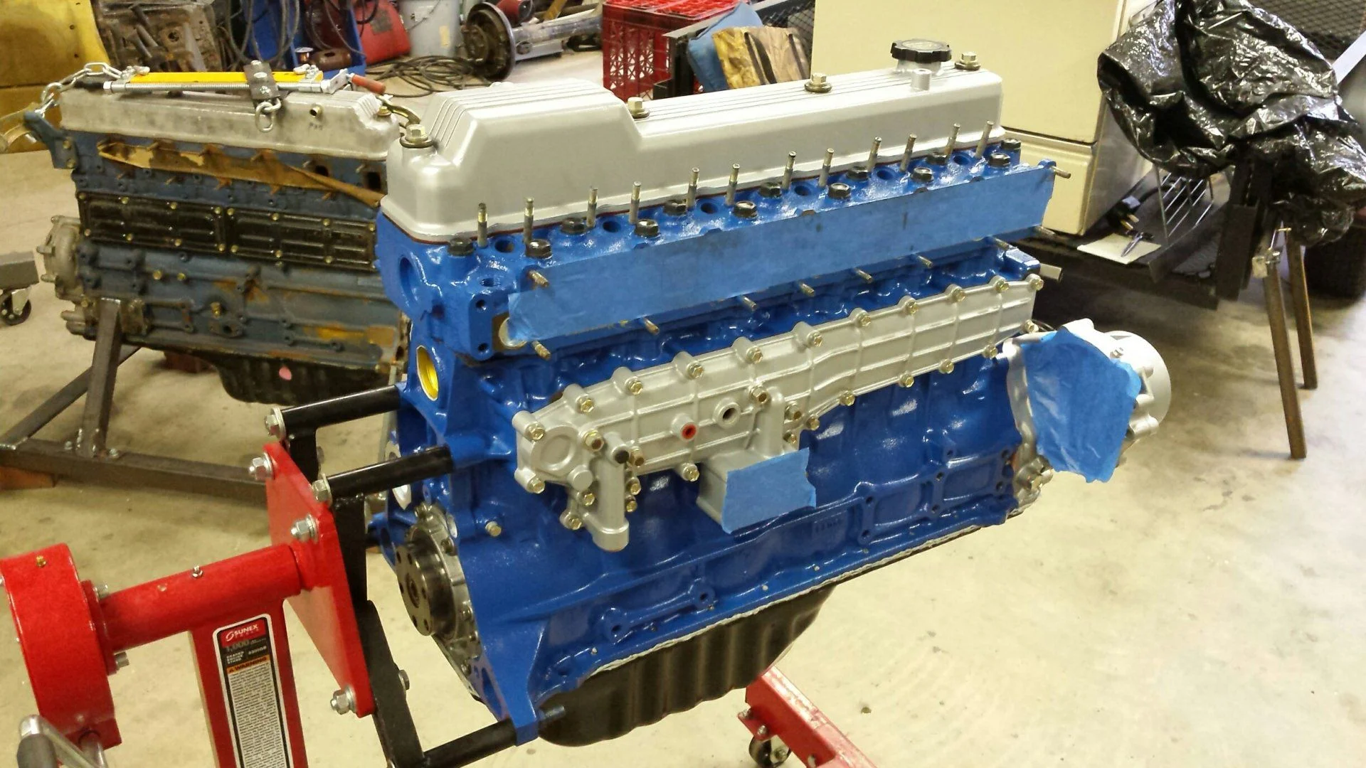

thanks man, yep used a knife, nice n easy. Lots of fluffy rust crud.
got the head off, a broken head bolt gave me some concern, explains why the engine was so covered in carbon and oil. got the sump off too. Very dirty bird. Shall post some pics and questions upon rockers, valves and piston chambers shortly. Pvo goose drove through wet cement!
