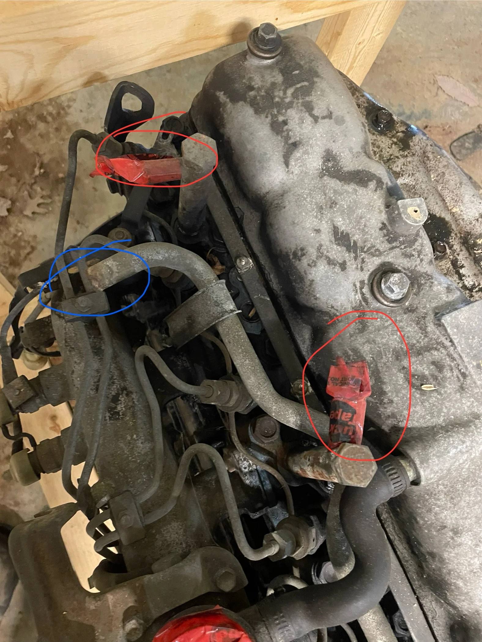

2H coolant plumbing
Dec 13, 2007
79
950
Franklin, TN
I’ve got a 2H that is going to replace my H. Can anyone help me on the picture below? The pipe circled in blue goes to the water pump. I’m assuming that this would go to my heater. Then I have 2 coming out of the head circled in red. What are these for? Where do they attach to? I’m assuming one might be the other side of the heater? If so what is the 3rd one for. Thanks!
Jason
3rd one is likely for the rear heater core in a 60 series.. you can safely cap the rear coolant port off with a brass plug, or an old coolant sensor if you have one handy.
